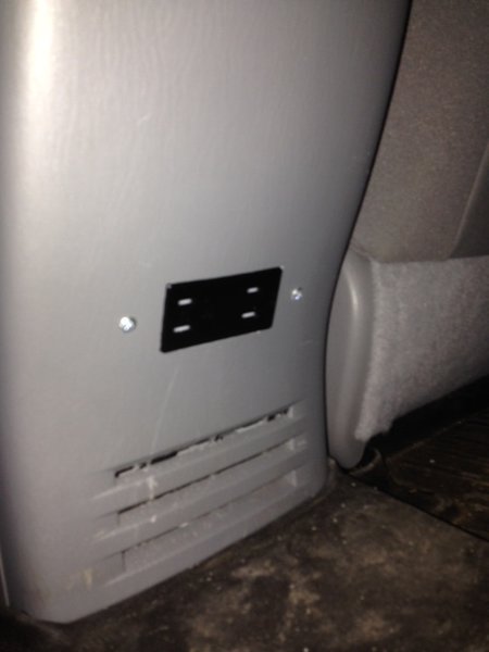

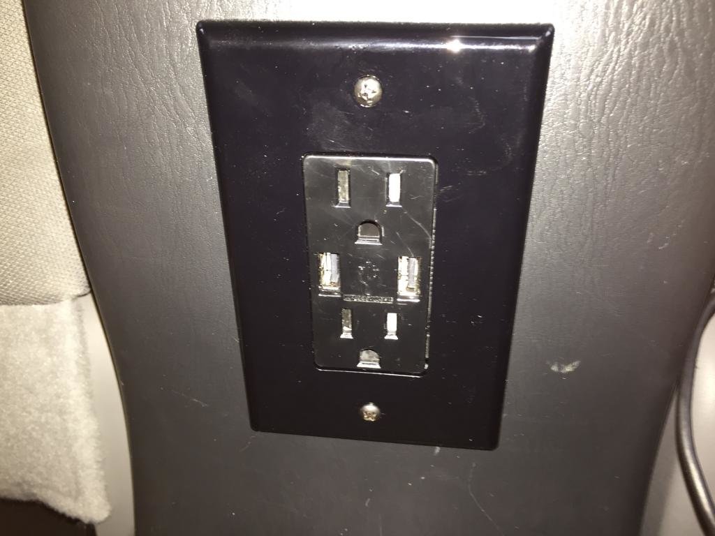

    Well, I figured I'd finally do this mod today. I also did the 400W anytime mod while I was in there. Everything turned out great. Thanks OP for putting this write up on here.

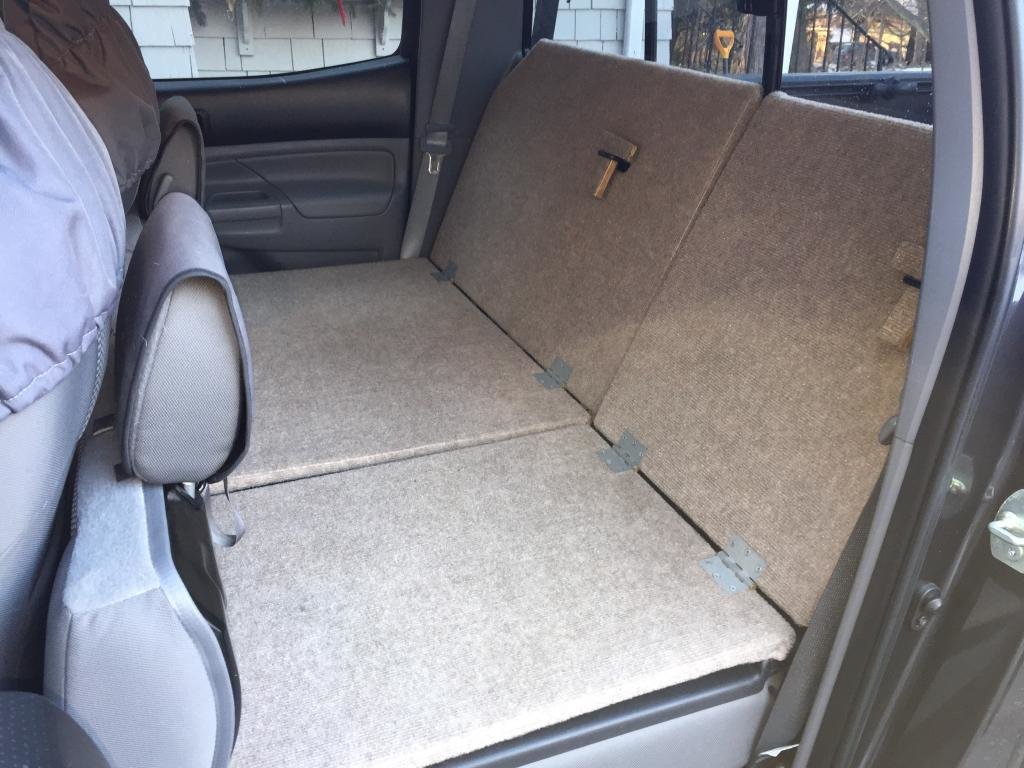

    I was going to just put the outlet in the rear of the center console. That wouldn't make sense for me, because my rear seats are almost always folded down for my dogs platform.
    BDE084C5-6FCA-45F4-A345-088DF8743DC3_zps_ebc770fdca1185bd641d8b7271e99c0e02afd02f.jpg
    I knew if I tried to make the hole perfect, it wouldn't be.... So, I figured I'd just hide it with a switch plate...
    A1D2506D-906F-444C-98C6-D664063DFC71_zps_673ec892aed4b7a2a4dc0883597677f572471883.jpg
    I didn't care about being stealthy or trying to make it look factory. I actually really like the way this turned out.
    70B9DBC5-D3D6-4111-8D83-4FF09BC08102_zps_5983f98993da291b0fdfa5b30af031117826c585.jpg

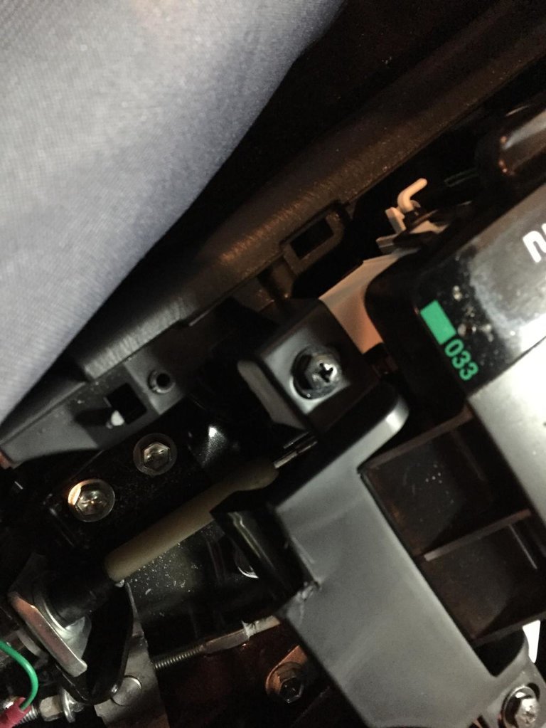

    I did have to trim this plastic bracket under the shifter console cover for the outlet to fit. I warmed it up with a heat gun first so it wouldn't break more than I wanted. Then, I just cut it with some shears.
    A7F06E77-ED8E-488B-8BC3-40BD4006EE8D_zps_8d306f41e1240c99975871426964fb9a09e62f1a.jpg

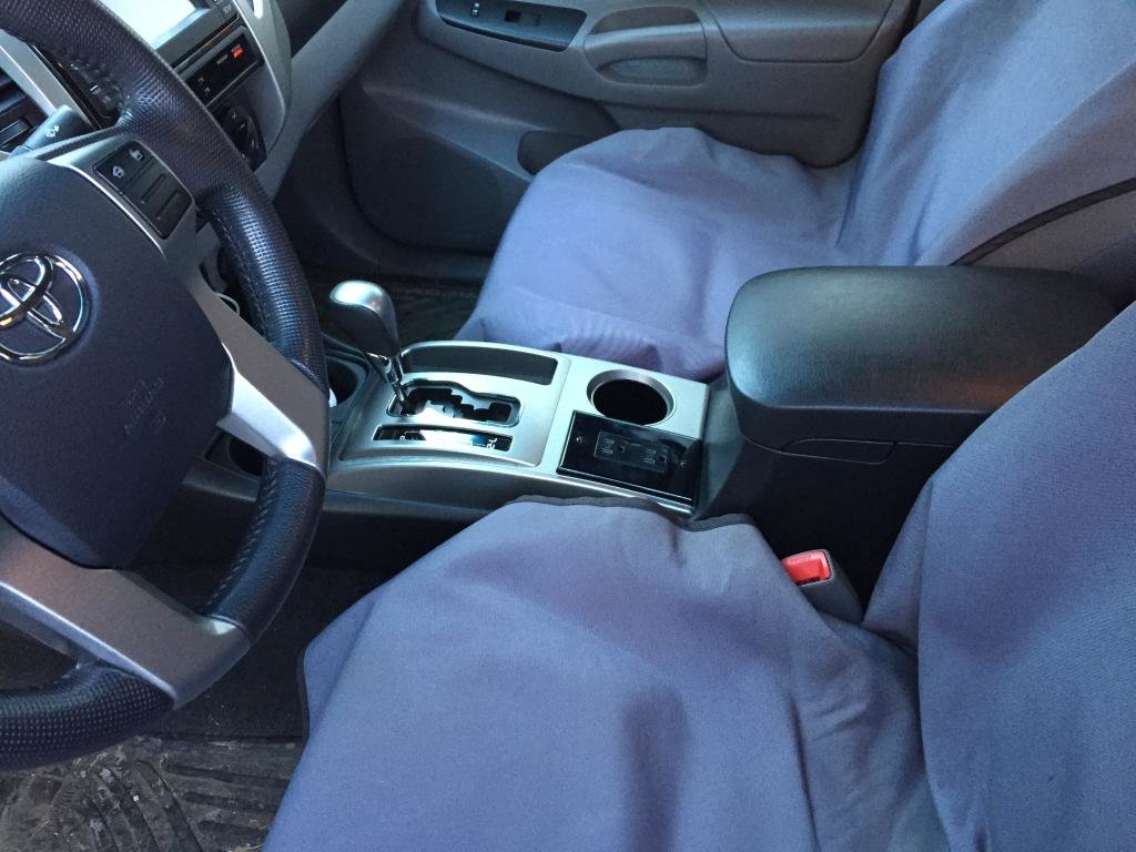

    Pics of the finished install.

    I can say that the USB seems to charge my iPhone as fast as when I'm on my iPhone charger at home.

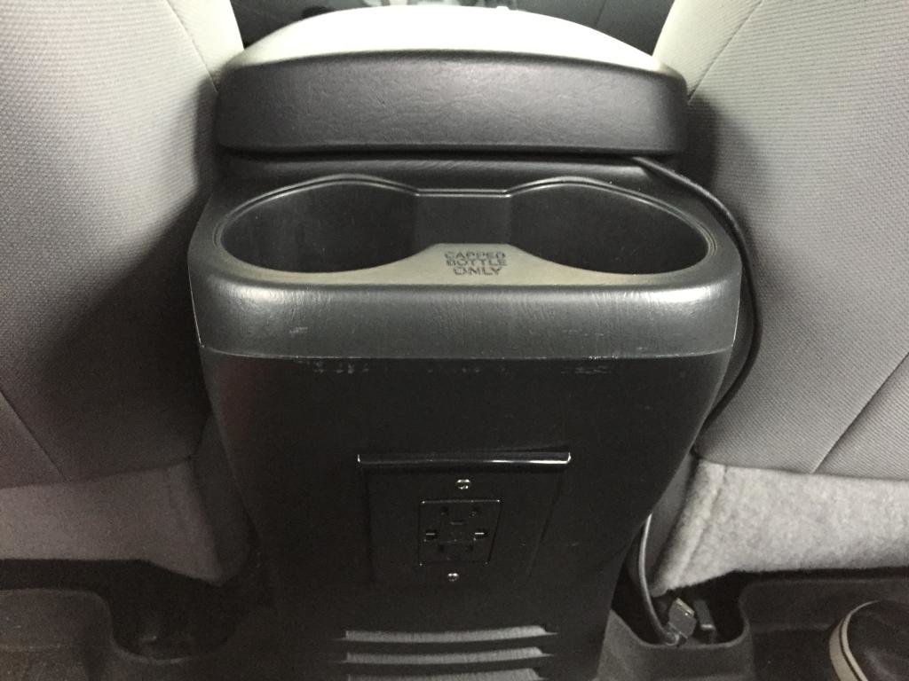

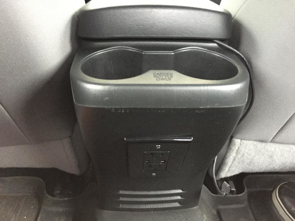

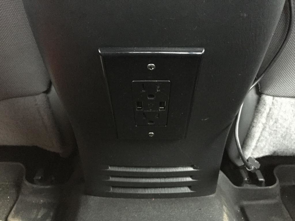

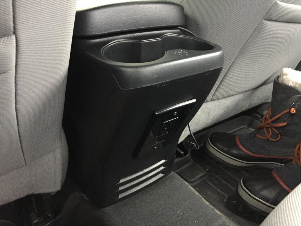

    You guys are rock stars! I put an outlet / dual USB in the back of my console, and did the full-time 400 watt mod. The instructions here were fantastic; I think it took 1.5 hours, including the trip to Home Depot where I pondered which outlet I was going to use for about 20 minutes. I signed up here just to say thanks!
