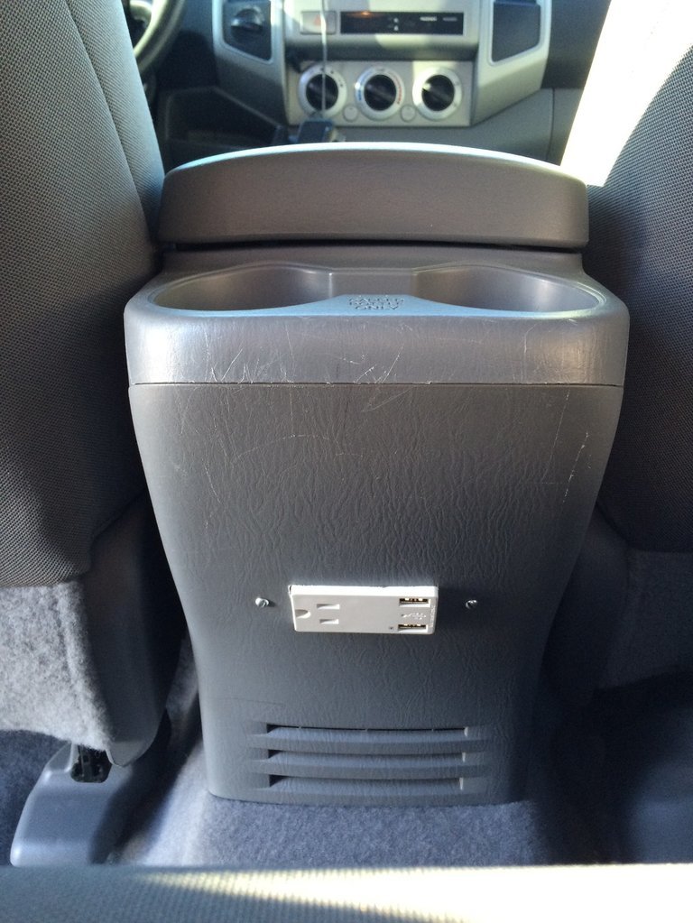

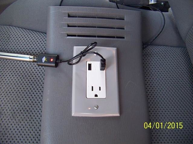

    I really appreciate some of the ideas posted in this thread. I hadn't really considered the idea of standard outlet with a cover plate. That gave me the idea to redo my original mod whereby I screwed up and made a crack in the back side of the storage compartment. Didn't make the hole quite large enough for the single outlet.
    My original wire connections weren't good enough either so I repaired those by stripping all three wires at each connection and using standard wire nuts. Also went ahead and did the 400 watt mod and everything works fine now.

    Nice set up. I used the same outlet snd bought the same cover but didnt use it cause I didnt like the edges of it sticking out. I used a razor to cut my hole so there were not any rough edges. Nice snug fit too.

    I had to use the plate because of what is hidden underneath = bad.:D
    It was a somewhat flexible plastic plate so it molded itself to fit the contour pretty well.

    Did the mod today. An AC/USB and the 400W anytime.
    Used the Pos-i-tap. And they worked great.
