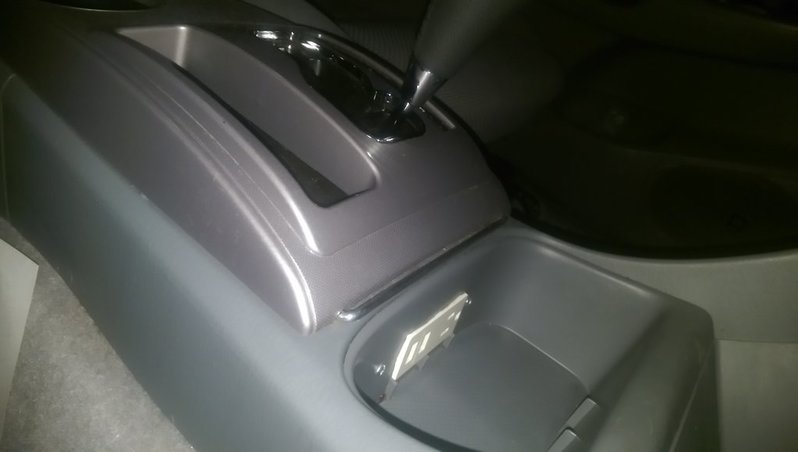

    Here is another outlet location to add. I had to mod the sliding shifter cover a little. But it is a clean and hidden spot.

    Finally did this..

    ooo what dat

    thats the fleshlight mod.
    fleshlight comes out from in between the seats and takes care of you while youre on the road.
