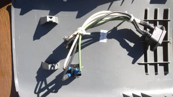

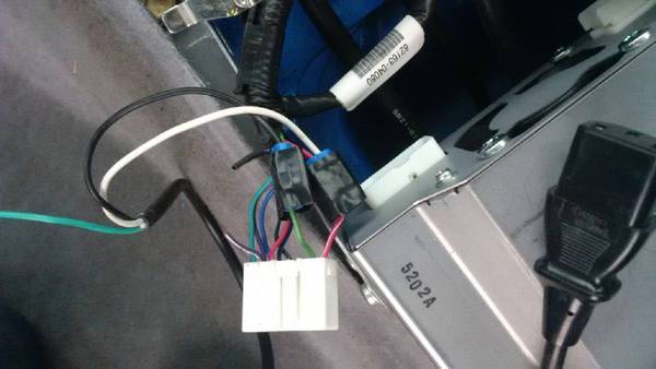

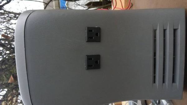

    Thanks for the writeup Adrian. There used to be a writeup detailing all the steps like you have here, but the OP took down all his posts when he left TW.
    Here's another install example, (added here instead of starting yet another post on the same topic, hope that's all right Adrian)
    rear view of outlets, quickconnects, heatshrink, solder and heatshrink to computer powersupply type jack.
    finished side view. Holes were cut with a 7/8" holesaw, then filed sqaure. 5 minute job. Outlets snap into place. Left space for a possible DC outlet. I also installed a USB power outlets, not shown in this view.
    Wiring at inverter. Note i used a computer power cord, so the console can be disconnected & removed with ease. Ground wire is connected to the obvious grounding point. I hate using crimp taps, but this seemed the best alternative, and used electrical tape to insulate it. I prefer the method Adrian did.
    for Automatic transmission - Violet w/ white stripe wire is cut, and both ends heat shrunk. (This wire is pulled to ground when the truck is moving. Cutting it makes the inverter think the truck is always at a standstill.) There is one more step, and that is to cut the violet wire, add on a piece of wire to the inverter end of this cut violet wire, and connect it to ground. Do insulate the other cut end of the violet wire! This will allow 400W all the time. Inverter is still turned on/off with the dash switch, and requires key to be ON.
