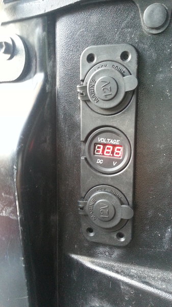

    Not sure if I posted this in here or not, but I added some 12v outlets w/ voltmeter to my bed too.

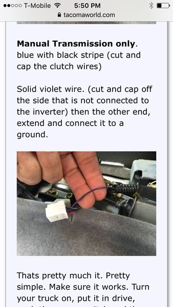

    Hey there, thanks for the rad how to! I'm doing it now! As well as wiring in a12v outlet for my fridge to the same spot from my aux fuse block!
    My question, however, is this: I did the 400w any time mod, but according to the switch, it didn't work? I snipped the violet with white stripe wire, started up and everything works the same as stock still.
    Dunno how I could have messed up cutting one wire?

    Without going back there to check at the moment, aren't you supposed to ground one end of that wire?

    the two how-to's i've looked at (including this one) just say to cap each end of the wire :notsure:

    If you're a manual I think if you're AT you ground 1 wire read OP

    Straight from the OP. I'm an AT

    Read second paragraph that's for AT

    With the AT you still have to deal with the solid violet wire. At least that's how I interpret it. The only difference for manuals is the part with the blue and black wire.

    oooohhhhhh, okay, i thought everything beyond the "Manual Transmission Only" bit was for the MT only!
    Thankyou for the clarification everybody!
