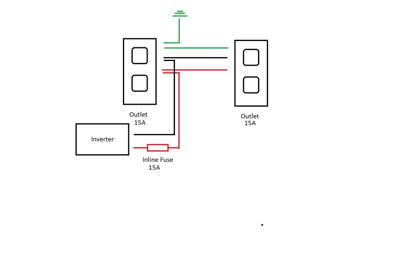

    Anyone install an inline fuse with this setup? (I didn't read all 28 pages)
    Thinking of installing two dual USB/120V outlets. One on the back of the console, another inside. I'm always cautious of my electrical wiring and never want to exceed draw. Was thinking of something as such:Inverter Wiring.jpg
    I won't be charging multiple devices at a time, just want the ability to plug in anywhere I need to. I'm just curious why I'm not seeing anyone else (in the first 5 pages I read) install one. Is there no need?

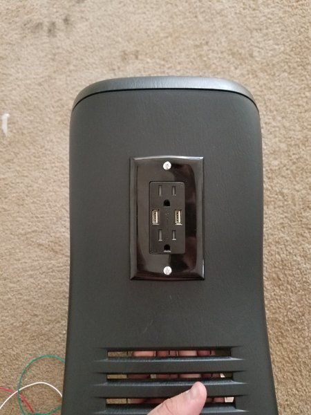

    Garrett
    CA desert
    2015 DCLB
