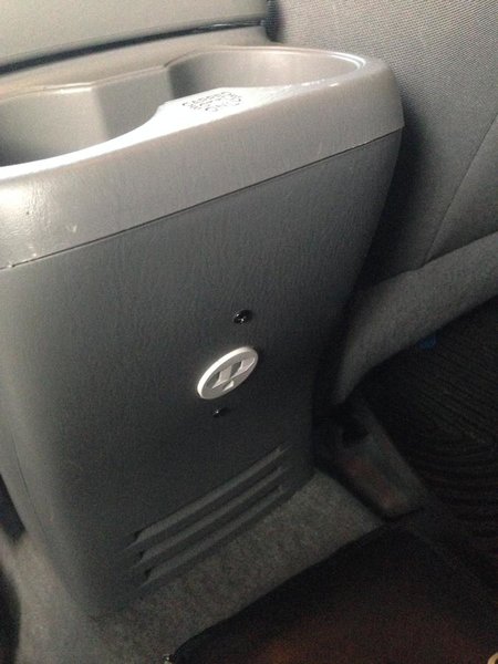

    Taking it apart takes about 3 mins

    Did this mod and the all time 400w at the same time took about 1 hr taking my time and tested with meter to verify 120v at the outlet.

    I used the single white like you did as i couldn't find one in black locally i will probably order a black one as i dont really like the white. I choose the standard single recpt for the ease of install . Used a dewalt hole saw and drill.im not good at making square holes.lol and im an electrician by trade so i have lots of hole saws.

    I post a pic later of the final install but as for the wiring its pretty straight forward your write up is easy to follow.

    Yea I used the white because to make sure it wouldn't get loose (nut holding it) I think with the black eventually it would loosen with the glue you'd be using to hold it in place. Thanks. I tried to make it easy for everyone.

    [​IMG][​IMG]http://www.Amazon.com/Leviton-5361-E-Industrial-Receptacle-Grounding/dp/B003AU3EM8/ref=pd_sim_sbs_hi_3?ie=UTF8&refRID=1VKQ2FH0STNPK6EP57Q2
    here are the two color options i was thinking of but no one local carry's them so i pulled this from Amazon.i will probably order these when i get around to it as i dont like the white so much.for some reason the are cheeper so i will go with those as it dosnt matter cause even the 15 amp is over kill as someone already said at 120v @ 400W is 3.33Amps
    here is a pic how mine came out!

    Sweet. Did you use nuts on the back of the screws?
