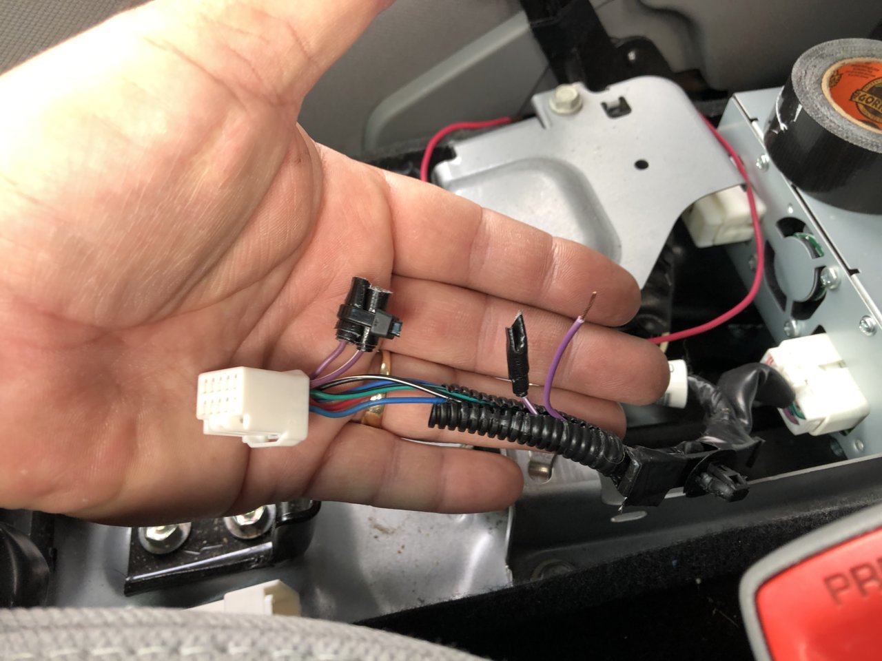

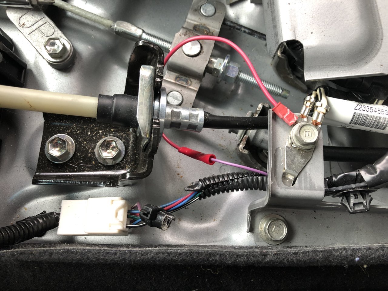

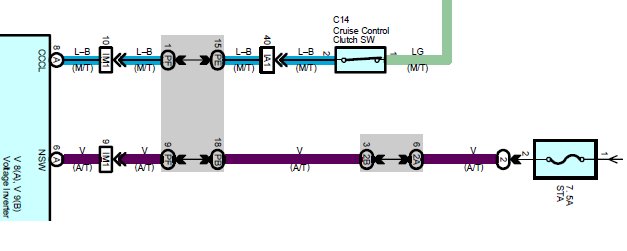

    So I tried to do the 400 watt anytime mod to my 2008 TRD sport with the manual trans 6 speed. I cut and capped the blue with black strip. And then I cut the solid violet and tapped the end coming in. The solid violet end that comes out of the invertor was ran to ground. However the 400 watt will not stay on. It works up until the truck starts moving a couple miles an hour. The clutch doesn’t shut it off anymore but the speed still does and I’m not sure what’s wrong. As far as I can see I followed the instructions. If anybody could help it would be appreciated.

    The solid violet is for A/T only...
    The violet with white runner is speed for both types of transmission....
  10. Dec 21, 2019 at 3:39 PM
    #590
    mthew96
    mthew96 Well-Known Member
    Feb 2, 2018
    #243284
    77
    mathew
    Western Massachusetts
    2008 tacoma TRD sport access cab 6 speed
    Bilstein 5100 kit and 1” spacer 265/70r17 duratracs BHLM DRL mod anytime fog light mod stubby antenna TRD shift knob LED tail lights TRD cat back exhaust
    With all due respect are you sure about that? The post on page one says for manual transmission only thegoes on to explain what to do with the blue and black wire. And then what to do with the solid violet wire. Check it out. If what your saying about the violet with white wire is true then my guess is I need to cut and cap that wire also. But now I wanna make sure that I was supposed to do what I did to the solid violet wire lol.

    I was just reading a thread in Toyota nation forums and in the beginning of the thread they weren’t sure if manuals needed to do the solid violet to ground or not. I continued reading through and a couple manual guys got back to the OP and said they had to do all three wires including the solid violet to ground. I’m not sure what the story is there. It looks like from your diagram it’s a neutral safety switch feed. Is it possible that the manuals have a safety switch other then the one at the clutch? Can anyone else confirm manuals don’t need the solid violet? Or do you have any referencing from other post you could share with me? If I wasn’t supposed to do that wire should I revert it back to connected? Should I leave it? Lol

    How about just de-pin the Speed Sense (violet w/white) and verify your 400W works first.

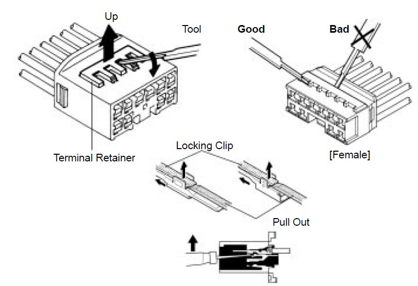

    Do you have any recommendations to make it easier to pull the pin out of the plastic plug? Iv always wanted to do it that way. I think it’s a much better option cause it can always be plugged back in should you want to revert it. However i can never seem to get those suckers out of the plug.

    Use a leather sewing needle...they are stronger, just be patient. If you get a 3rd hand it's easier. One holding the connector and prying the lock under the pin (after releasing the terminal retainer) the 3rd pulling lightly on the wire.

    Iv been at it steady for the past hour and it hasn’t so much as budged. Iv always hated these damn pins. I can rebuild an engine but god forbid I be able to get some little pins out of a plastic connector Smh
    Iv tried all I can think of to get that tab to release with nothing being closer then the last. Along with multiple different tools, even tried making my own “de pin” tool.
    However I’m almost fairly certain that once that wire is separated the 400 anytime mod will work. Knowing what I now, know about the wires and what they are for I looked closer at the plug and noticed that even though the end of the plug coming from the invertor has the solid violet wire that I ran to ground. The other mating plug doesn’t even have a solid violet wire, or any wire at all in the opposing spot to plug in to the solid violet wire going to invertor. So it doesn’t make a difference on the manual (at least my truck) if the solid violet is grounded, capped off, left alone, de pinned, none of those should change anything. It never had a signal source in first place.
    So at this point I’ll prob just leave it grounded until I get that pin removed and verify the 400 watt works. Then I will play around with that solid violet wire and post back what I find.
