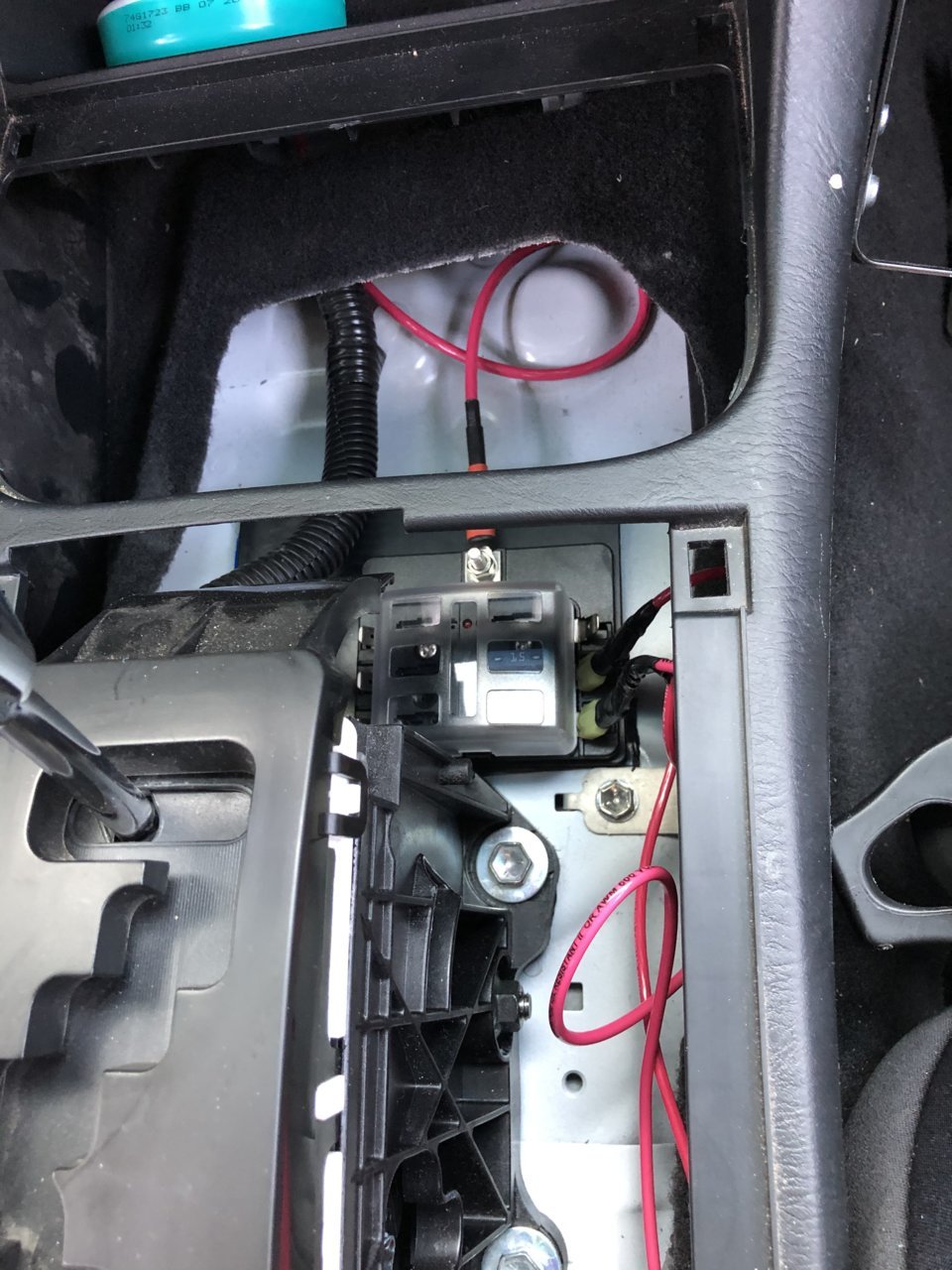

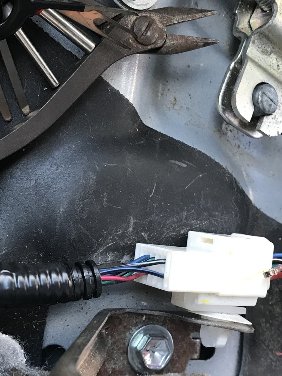

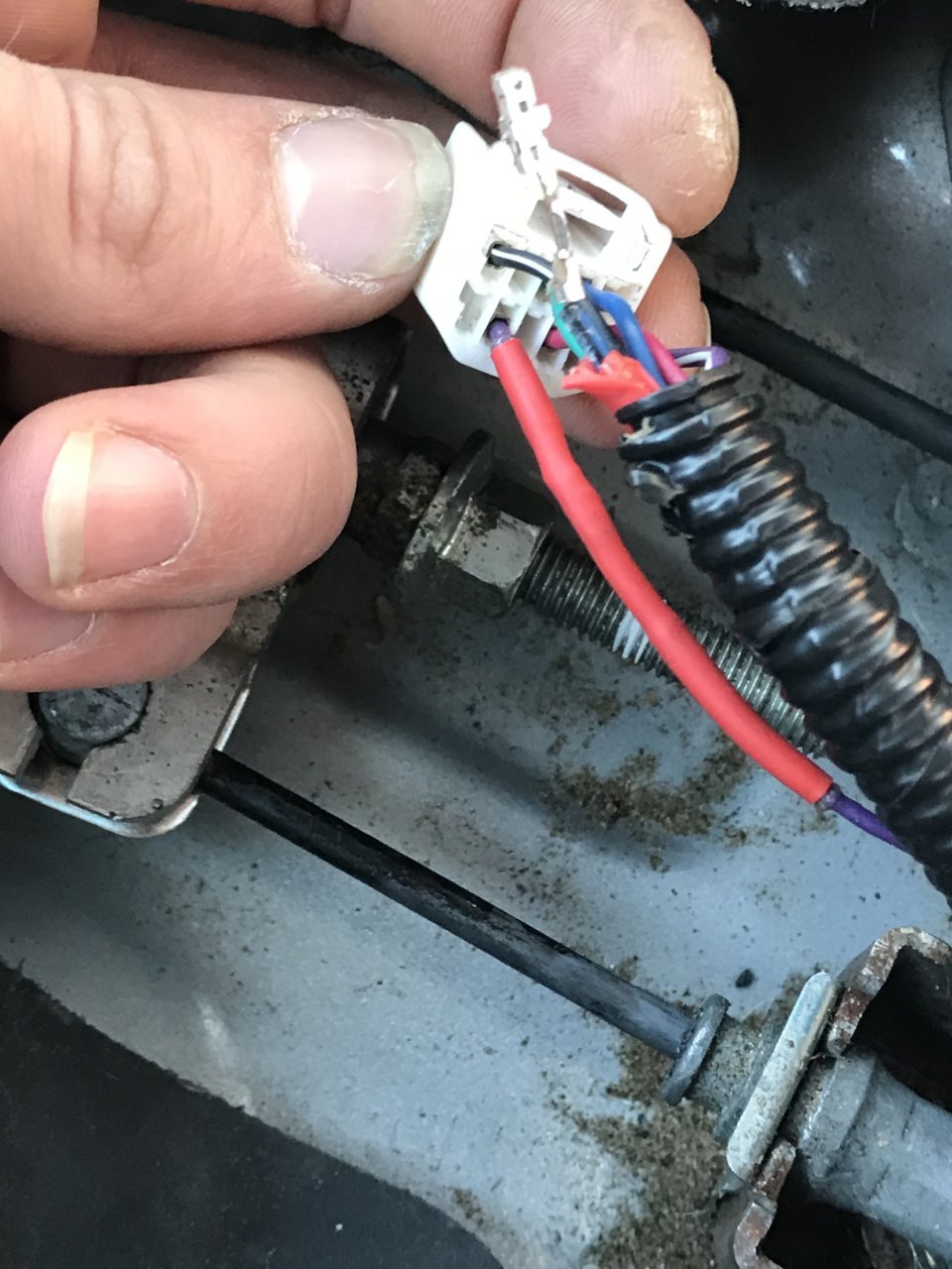

    Okay so I finally got a chance to work on my 400 watt mod and test everything to report back for the guys with manual trans, on what is actually required to pull this mod off on a manual truck.
    So the blue/black wire is clutch switch wire, the violet/white wire is speed sensor wire, and the solid violet wire is neutral safety switch. The confusion lied around wether or not the solid violet wire (neutral safety) had to be ground or not.
    On a manual trans truck you will notice that the plug that comes from under the dash doesn’t even have a solid violet wire going to it. In the picture it should be the pin slot to the left of the blue/black wire (clutch switch) which you can see is empty. 35773E0A-E101-40A2-9EE9-EC8EC6A8128B.jpg
    However the other side of the plug going to the invertor does have the solid violet wire. You can see that in this picture (Don’t mind the red heat shrink you can see on the ends that is the solid violet wire and it’s right next to blue/black) So in the factory configuration this solid violet wire can never receive a signal. 28557959-DFF4-4156-9729-8B7FDB5E8682.jpg
    So one would think this violet wire doesn’t need anything to make this mod work on a manual trans. Especially since we don’t have neutral safety switches. However that is not the case. As soon as you remove or cut the blue/black wire (clutch switch) to do this mod you will loose 400 watt mode entirely (doesn’t matter if your parked or not) until you ground the solid violet wire.
    It seems that the invertor relies on a signal from the clutch wire (even when pedal is not depressed, I didn’t test it far enough to know but maybe it has 12v all the time and when the clutch is pushed it breaks that 12v signal I’m not sure) but when it no longer receive that signal from the blue/black wire (clutch switch) the invertor reverts to wanting ground from the solid violet wire (neutral safety switch).
    So in order to complete this mod on a manual transmission you need to cut/de pin the blue/black wire (clutch switch). You need to cut/de pin the violet/white wire (speed sensor). And you also need to cut the solid violet wire and extend it to ground.
    Basically the only difference between manual and auto trans is the blue/black wire (clutch switch). Auto trans guys won’t have that wire and will have to do just the solid violet wire to ground and cut/de pin the violet/white wire

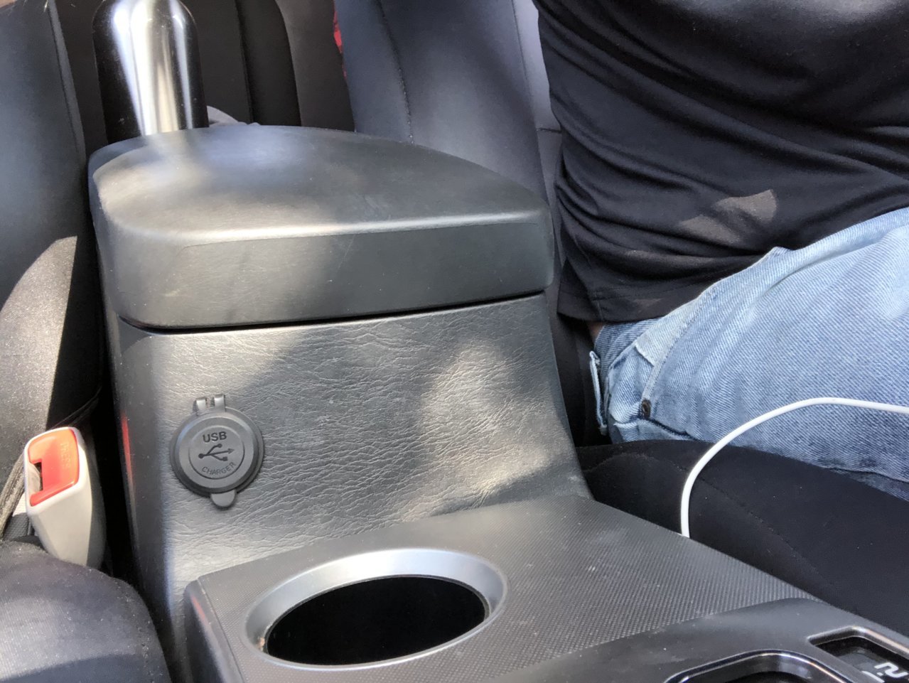

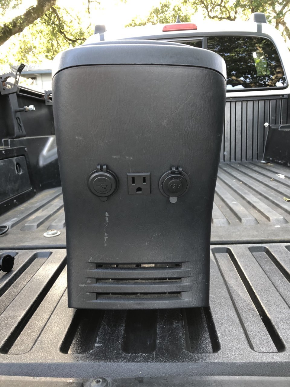

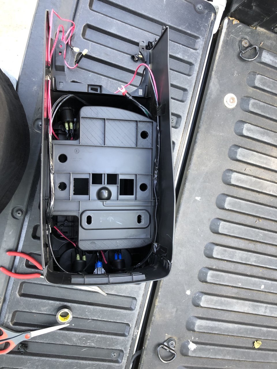

    Here’s mine. Nothing special, but sure is nice to have some extra power in the cab. I wired the 12v stuff directly to the battery. I put in a small fuse block For interior power while I was at it. Just wanted to say thanks to the OP and others who helped make this mod easy.
