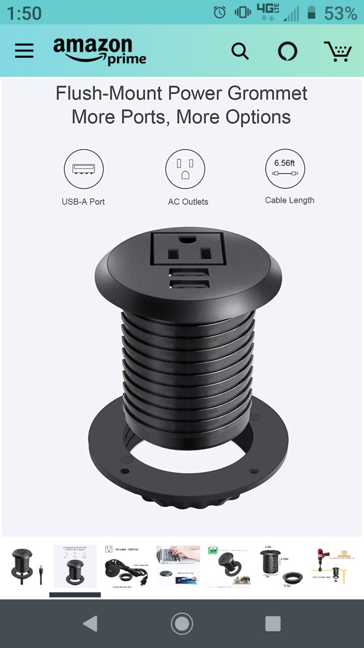

  15. Nov 10, 2020 at 12:49 PM
    #635
    JOHNNIE TOY
    JOHNNIE TOY ToyLover
    Jul 2, 2017
    #222962
    56
    Johnnie
    Tucson,Az.
    2017 Toyota Taco TRD Off Road
    2.5" Bilstein lift, 285/70R17 BFG ko2 tires. Method 17" Race Wheels, K&N air intake system, custom mesh grill, upgraded LED lighting throughout the whole truck, including light bars ditch lights rear bumper lights, Taco Tunes 1000 watt plug and play system.
    How much room is there behind the console? I'm looking at a signal plug with two usb ports it's 2.5" deep and takes a 2" hole to mount it

    plenty for that. I ran a USB, 12v and 110v
    The 110v did get a little tight and I had to bend the prongs on the usb and 12v but they fit. Take it off and check the best spot to put it might be between my two.

    So how deep was your plug

    09 Off road build
    RCI skids/armor, SPC UCA, Fox 2.5 front 2.0 rear 16" TRD PRO rims/ 285/75/16, SS3 Pro fogs, Sherpa Roof Rack
    The 110V is 2 inch deep and the USB and 12v are 1.6 The 110 didn't have any issues fitting the USBs were really close to the tray so if you do the one your thinking and do it up by where I put my 110 you should have no issues fitting it.
