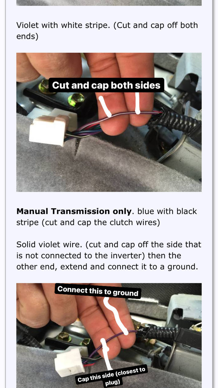

    I found this part to be ambiguous as well. But I just did mine yesterday and it worked, so here's what I did:
    Cut the violet + white wire, cap both ends.
    Cut the violet wire. Using this picture as a reference:
    the section that is to the left of his fingers gets capped. The section to the right of his fingers (the part that runs to the inverter) needs to go to ground.

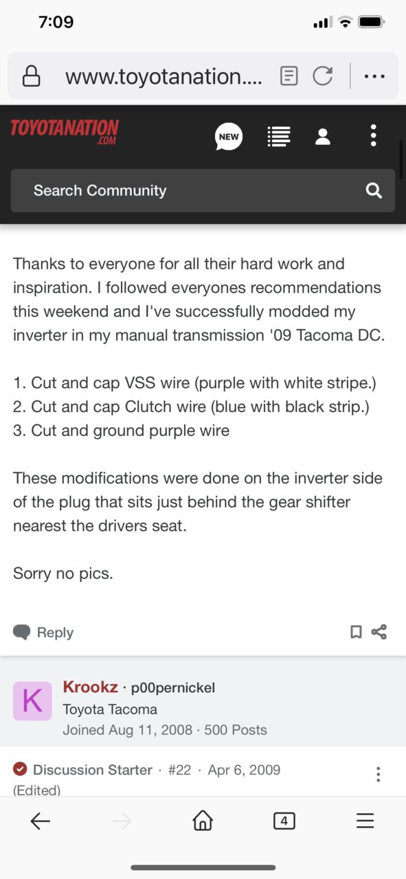

    I finally went to do this to my truck.
    The DIY for a manual transmission is incorrect. I didn’t bother to go through 33 pages to see if someone posted the correct info but here it is…
    3 wires need to be modified, not 2.
    Here’s the correct procedure

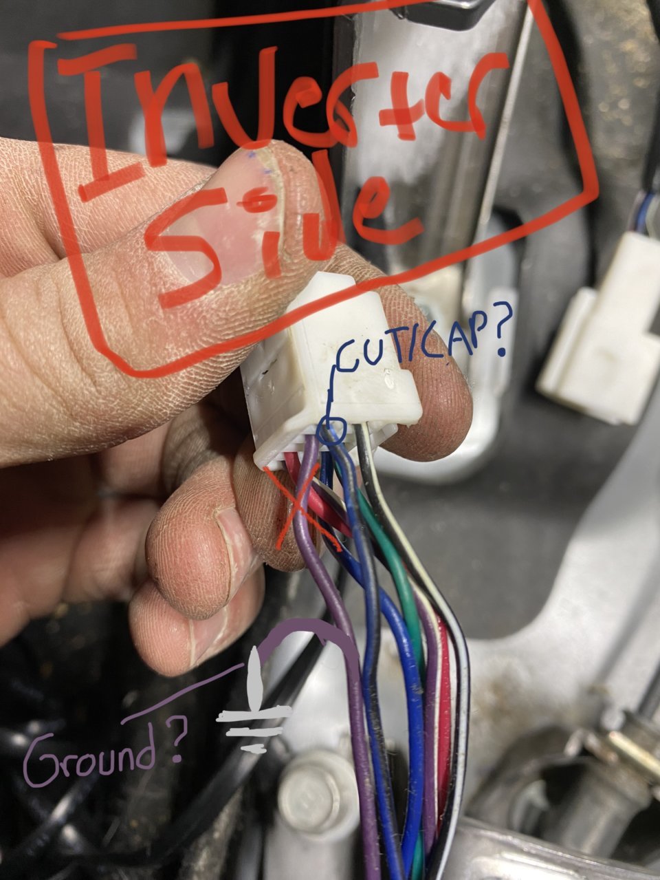

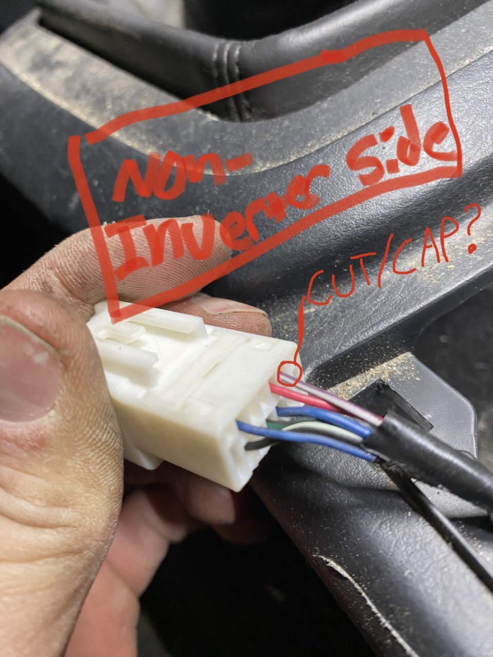

    I had my center console apart today because I was running a remote wire from my amplifier to my hidden dial. I figured I’d attempt this mod while I had it apart. I got the original harness untapped and was confused by the instructions so I am wondering if someone can point me in the right direction with my 2012 Manual Transmission. Here are some pictures with my drawing of what I think I am being told to do. Correct me if I am wrong… or tell me to make the cuts. Please and thank you.

    All the wires are on the same plug in the pic you labelled "inverter side".
    If you have an auto trans you don't have to worry about the blue/black wire.
    You are correct in cutting and grounding the purple wire. The purple/white wire to cut and cap is in the same plug.
    To cap my wire after cutting it I slid a piece of shrink tubing down the wire. Then I put a silicone bead on the end of the wire. While the silicone was still wet I slid the shrink tubing back into place and shrank it. I think it would be fine with just the shrink tube but the silicone is added protection.
