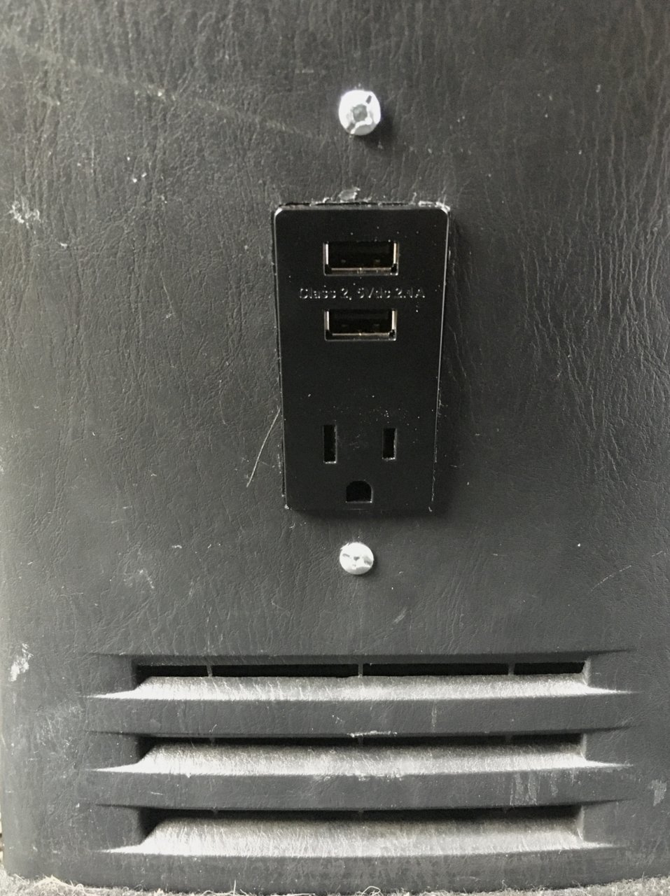

    The plug is from a Ford or Lincoln product, I think the part number is in a post earlier in the thread. It's nice in the fact that it's covered when not in use, kind of a waste IMO for an interior installation unless you got a kid that might stick something into the socket when powered on, considering what the mod takes, buying a harness seems like a waste of $. With a typical socket it's just 3 wires, with the ford outlet you need connectors and a crimper to make the connection at the rear of the outlet, overkill IMO. I chose a dual outlet with 2 USB ports mounted on the back of the console and added a 3 wire connector so the console with the mounted outlet can be removed out of the truck easily. I think I got $20 in everything. I use it mostly to keep a power bank charged that's hooked to my fridge. Running the fridge directly off the socket means it's not powered when the truck is off and anytime I forget to push the button which is about 25% of the time, with the power bank it works great, the truck easily charges the bank while the bank is powering the fridge.
    https://www.amazon.com/MOCW-BC3Z-19N236-Assembly-Lincoln-Console/dp/B09FSNR7TZ?smid=A3T5KU9MQ2GAZ2
