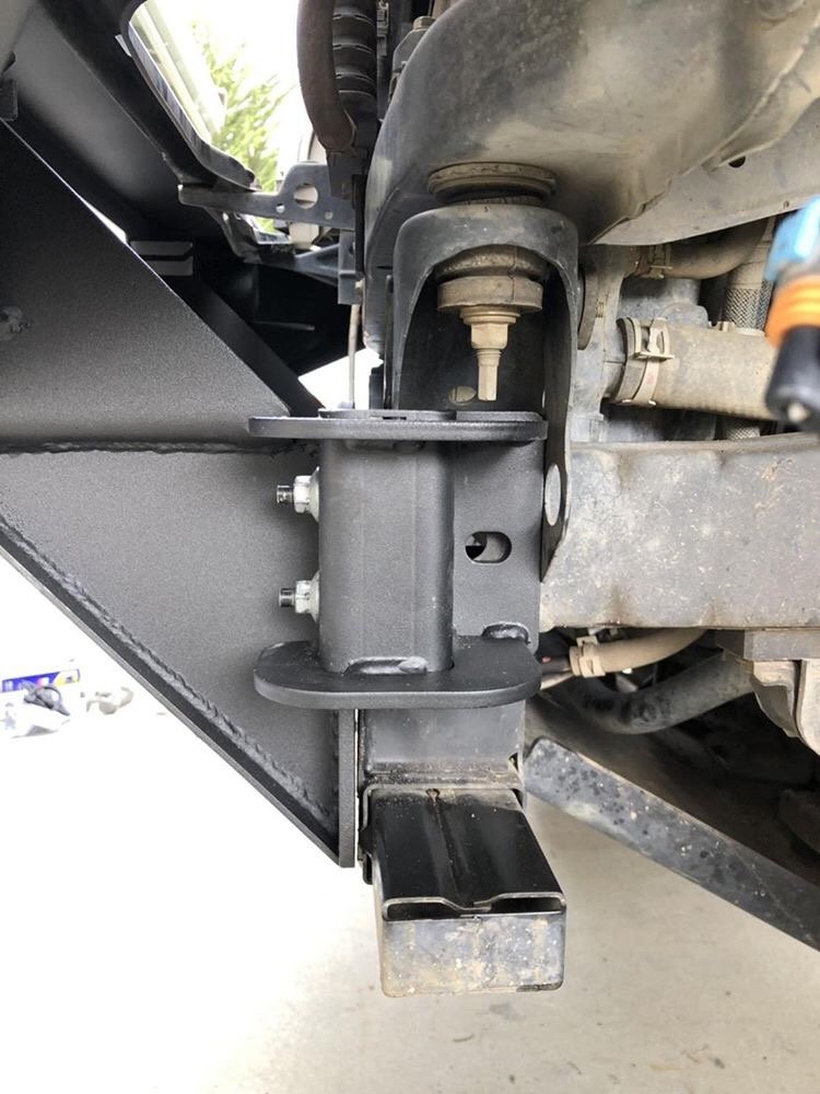

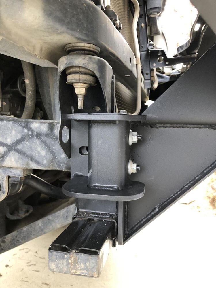

  14. Mar 12, 2019 at 4:25 PM
    #314
    jberry813
    Jan 21, 2011
    #49636
    28,471
    Jason
    Lake Tahoe
    2012 DCSB Sport
    ...too much shit to list.
    No instructions as they are prototype brackets. They go on after the bumper is installed and sandwich the bumper to the frame.
    Knock out the plastic plug in the frame on both sides.
    You will have to source your own hardware.
    You will have to drill out the hole on the bracket for the through-boot. That’s why these were “prototype.” You can see the slot doesn’t line up with the frame hole. Just drill the slot out with a step bit or next size up drill bit.
    3EBC7FF5-2F92-457E-8982-B8369E42D813.jpg 5FE43104-10FD-47EB-B94B-6ECBC966F6BA.jpg
