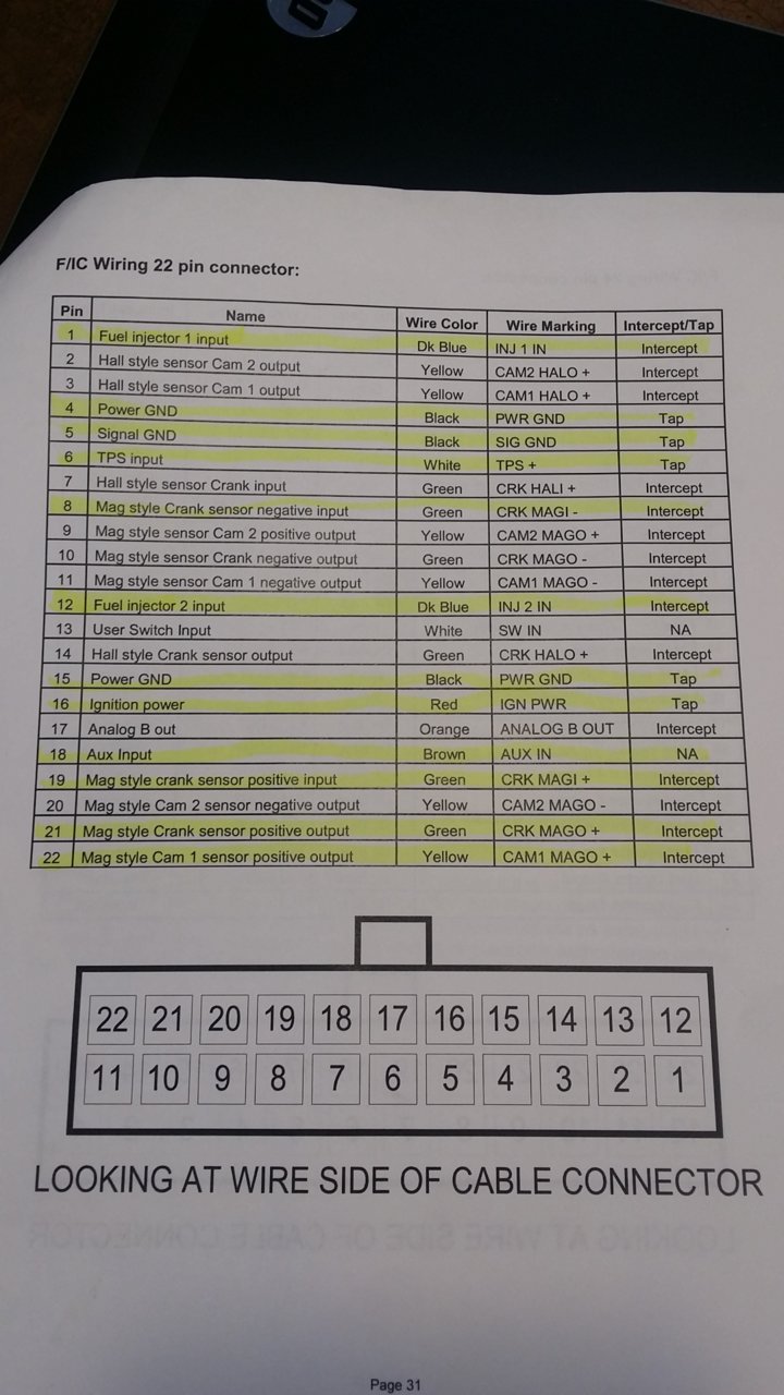

    Can someone who has their FIC installed tell me which pins I'm missing? The yellow lines are the ones that Boomslang wired up the white ones were not tapped or intercepted and I know that at the very least cam1 mago- should be in place. What about the rest of the cam pins, and what about the crank pins? Any others that should've been tapped/intercepted? Thx

    what $150 patch harness?
    most harness i seen for sale is $350+

    @mudthedoor @TMFF @Clay_916 @vasinvictor

    I went by this and didn't use the bridge resistor. Still running strong today.

    I wired the same as @Clay_916 and added the cam resistor but did not use the resistor on the AF1+ connection as my truck is wideband vs the older narrowband.

    So, you both ran the resistor in line on the cam? Positive or negative? What size, 10k, 2k?
