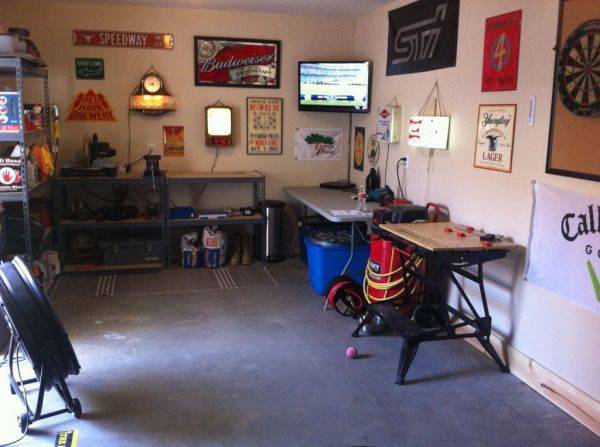

    Well I suppose I owe all of you an update. I ended up buying one of the stand up portable air conditioners, and running the vent tube through the wall into my two car garage.
    I'm not concerned about the heat accumulation in there (since the other day it was 120 in there even without the AC venting), and I've been monitoring the humidity, and the max I've seen is 32%. So looks like I'm good to go.
    I've also been working on insulating the shop more. The attic and exterior walls were already insulted. Today I bought and installed a kit to insulate the garage door (pictured below)
    So far I'm pretty happy with the setup. It was 101 today and the unit cooled the shop to 85 in a couple of hours. That about all I can ask for without spending a few grand.
    Here are some pics of the shop. Thanks everyone again for all of your ideas.

    Sweet job!
    Humidity won't be a problem on the exhaust side. The condensation happens on the evaporator coil, which is the cold side, and should drain into a pan on the bottom of the unit.
    The "hot" side of the system is simply blowing air over the compressor coils and venting so there's no increase in humidity on that side.

    Shop looks awesome! I'm :jellydance: . Didn't know they made those garage door insulating kits. Might have to pick one up for the house.
