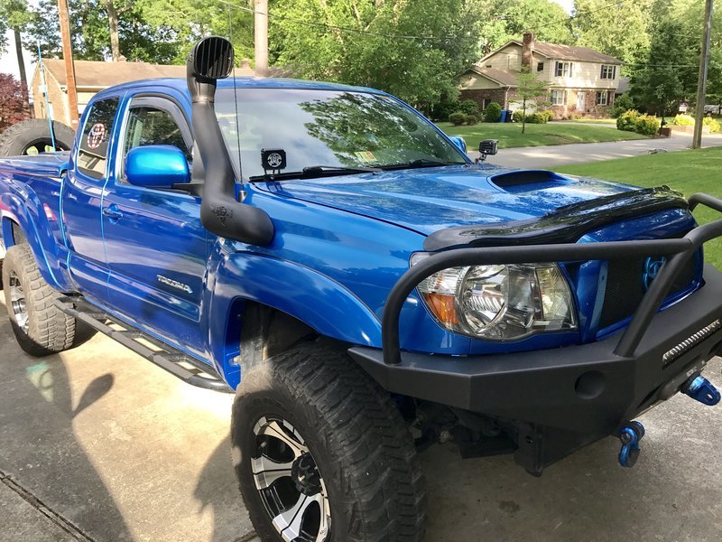

    Dave, that looks great. How much did the snorkel change the engine tone? Both inside and outside the cab. I've seen videos of people installing various CAIs and those really change the sound quite a bit. I was wondering how much the snorkel changes it.

    Just drove it for the first time this morning. Changed some but honestly with the tire noise it's hard to tell. But I did notice some difference. Let you know after I've driven it more.

    Looks good Dave. Sorry I wasn't able to give you a hand. Work is always getting in the way.....
    Mine got quieter after putting on the snorkel because I removed the CAI and installed the stock intake.

    Thanks. Wasn't to bad. After I got past the "scared shitless about cutting the big hole" thing. Went pretty good.

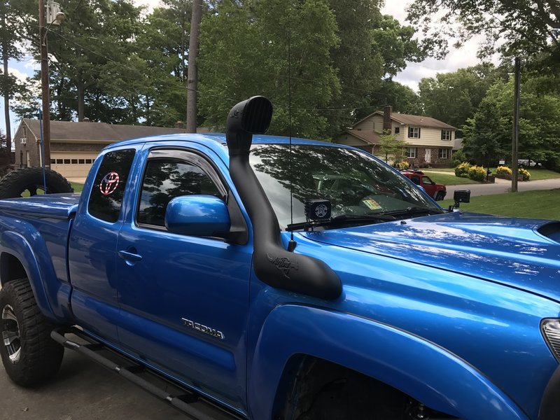

    Truck looks great man :thumbsup:
    BTW yeah take it easy on with the heat gun on the elbow. It doesn't take a lot of heat to shrink the end :thumbsup:
