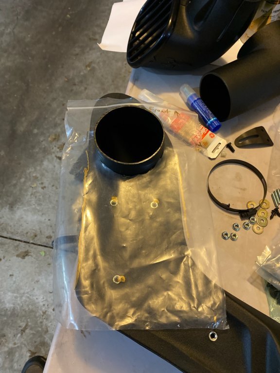

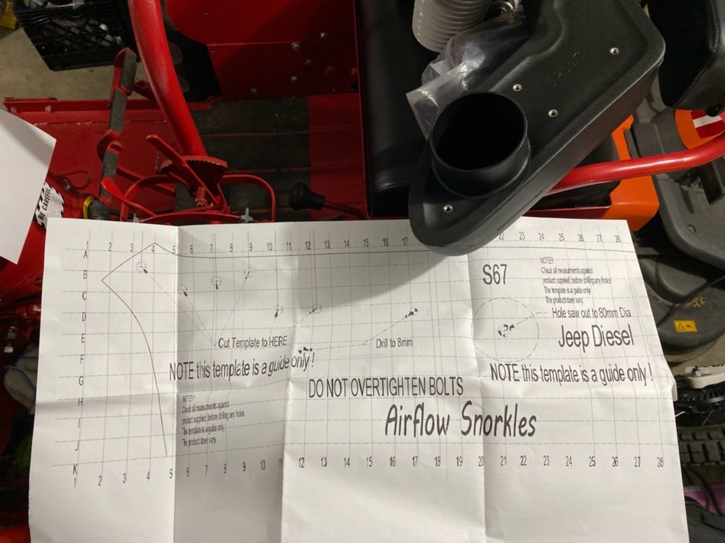

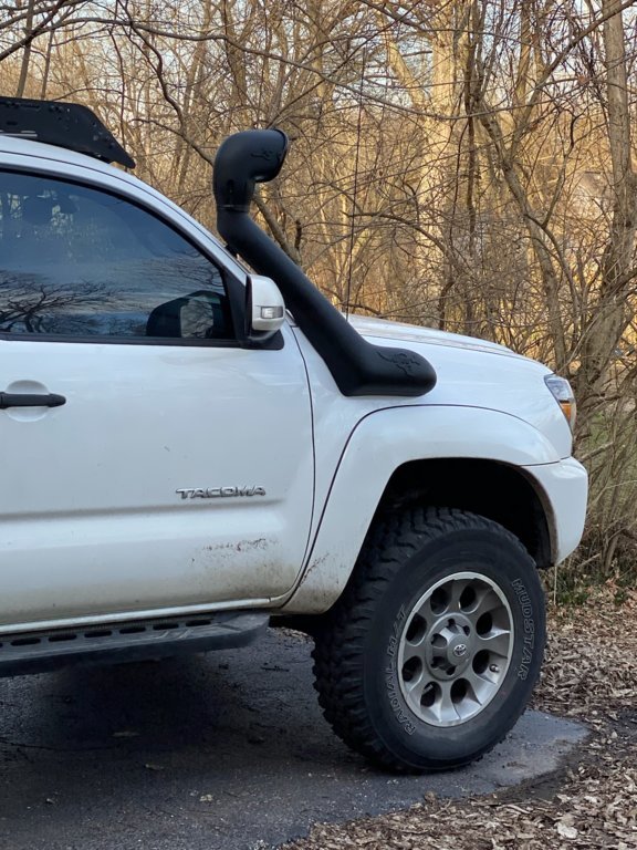

    Did this today...not terribly hard
    Worst was getting the inner fender liner out and the gut check prior to cutting a 4” hole in the outer fender.
    The wrong template was in my kit...it was for a Jeep
    So took one parts bag, cut it to make one sheet of plastic, laid over snorkel mount area to mark as a template and transfer to the truck...that actually worked very well...
    Happy with the results!!

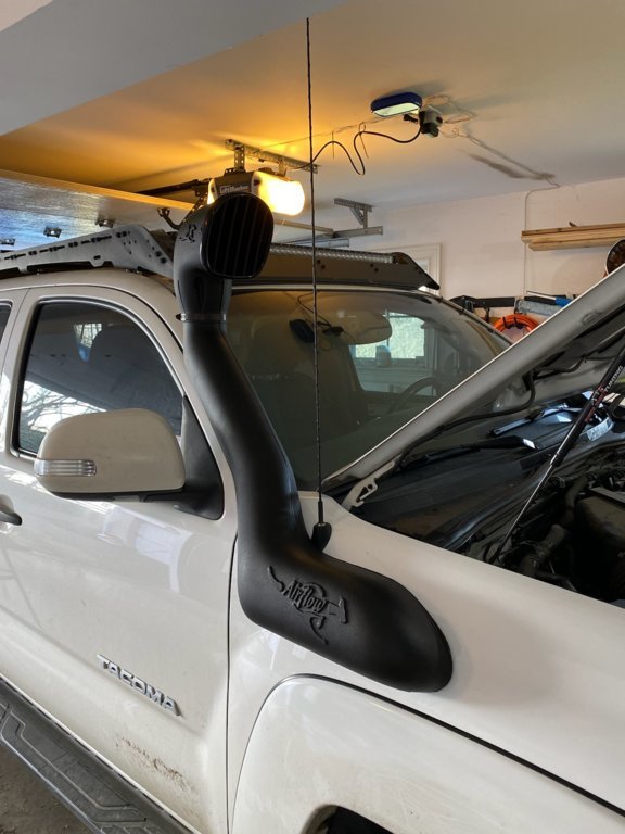

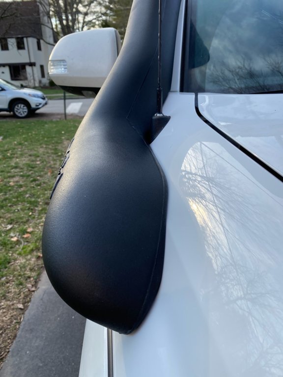

  7. Jan 13, 2020 at 1:30 PM
    #87
    EdinCincinnati
    EdinCincinnati Well-Known Member
    Mar 11, 2013
    #99457
    2,454
    Ed
    Ohio
    2014 4x4 TRD OR

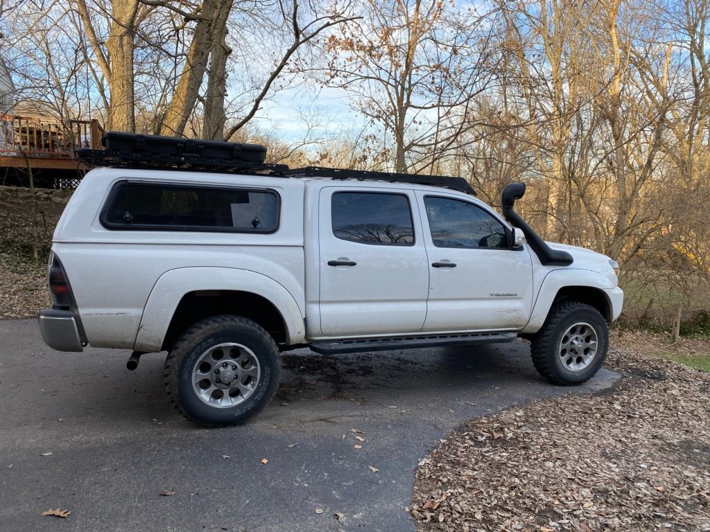

    Front_Tint_Jan2020.jpg I've had my Airflow for a few years now. I love it. Cooler temps, cleaner air and turns heads like crazy. It's fun building the kind of truck you used to play with as a kid.
