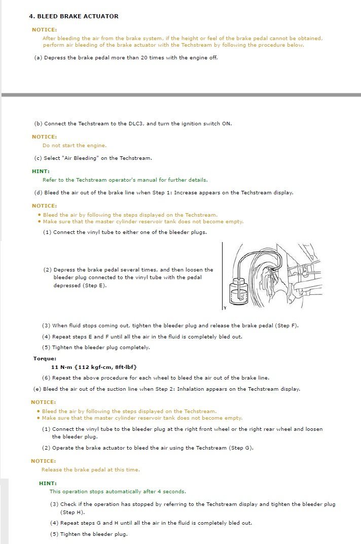

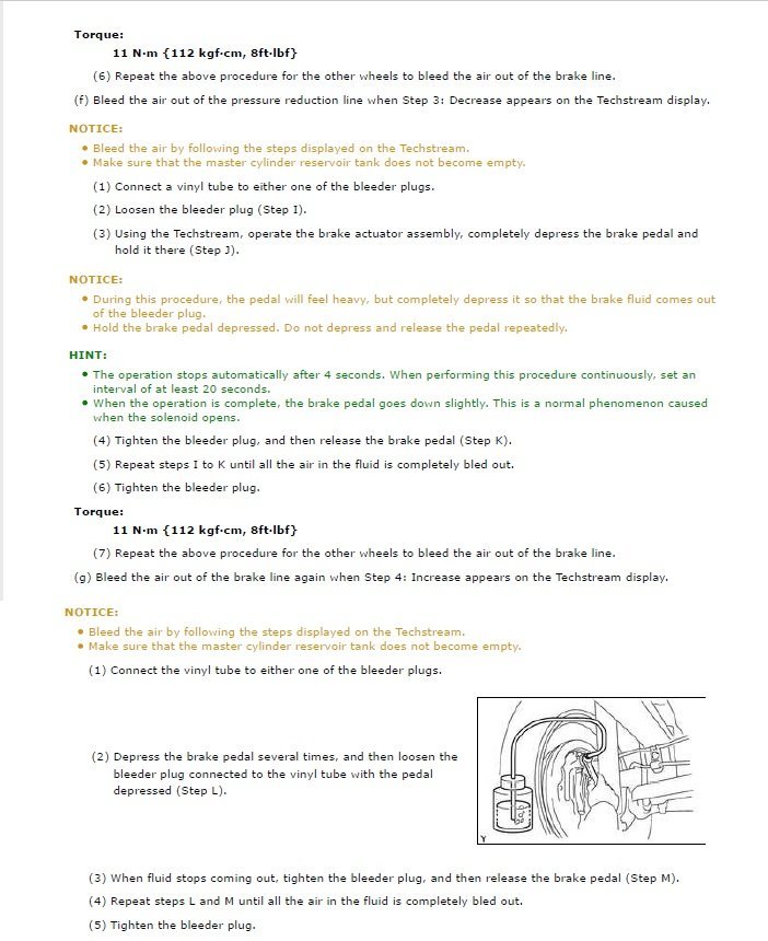

    Probably air in the abs module...

    I found this:
    (use at your own risk)
