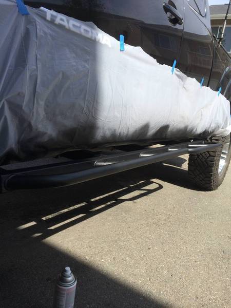

    Had some time this weekend to work on mah shit. Replaced the air box and adjusted the chain on my motorcycle. Then got really dirty grinding/brushing rust off my sliders and re-coating.
    Looks much better :D

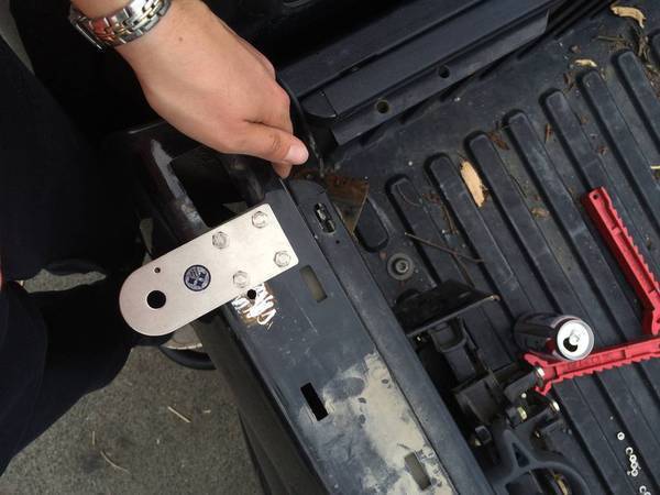

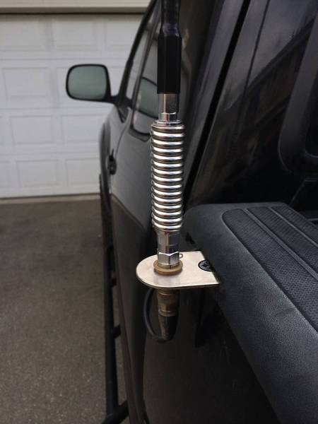

    Re-did my CB antenna mount with a stainless mount. the mount is nice and solid and makes a great ground. I was having problems with my CB broadcasting but I was able to test it and it is now crystal clear :D.

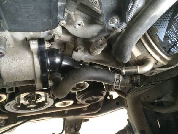

    Did the water pump/coolant flush/t stat last weekend. At about 105k. was not too hard, just took time and patience. (neither of which I have a lot of) Took about 5 hours total, with beer breaks. I think the worst part was finding and getting to the driver side coolant engine block drain... Found a great write up on here that helped a lot.
    new t stat in

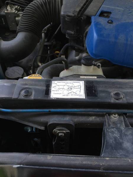

    printed this off and stuck under the hood. in case I ever need to do a field repair on the belt and get confused...

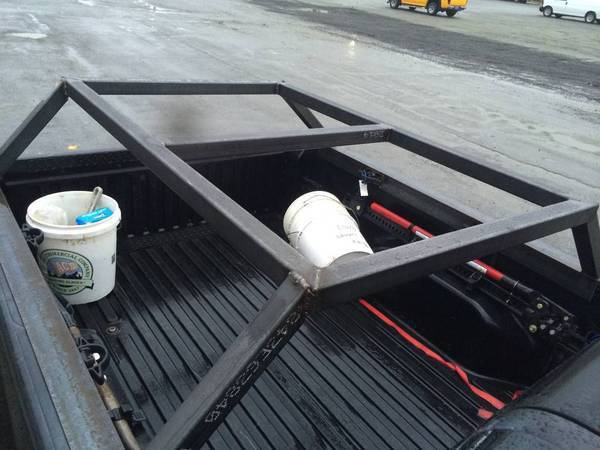

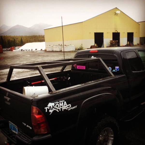

    Played with my welder this week. Made a tent rack for another member... and am modeling it on my tacoma until he can pick it up :D

    lol. looks nice! hows it ride? I'm out of town now, but if you give my wife a call, she can come pick it up. you should have her number in a pm.
