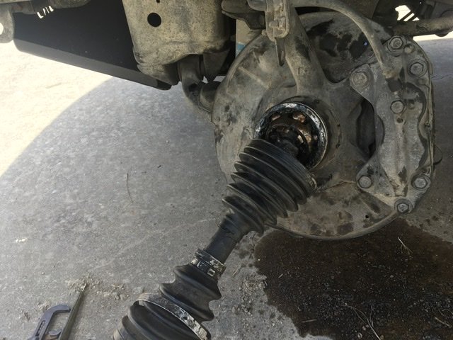

    I’m in a jam. Can I just remove the front axle and keep rolling down the road?

    You could but you'll leak front differential fluid out and it will be rotating with no oil... depending on what side CV you remove. I forget if the driver or passenger side is always connected to the diff and making it spin, even when in 2WD...

    No. The CV axle nut it what holds the hub & wheel bearing together.

    Without the CV axle nut in place you'll toast your wheel bearing, ask me how I know. Cross threaded mine once and that was enough to ruin the wheel bearing ~300 miles later

    If it's already f'd up, just bang the crap out of it to remove the center section.
    Leave the hub and the outer end of the CV attached there to hold the hub/wheel bearing together.
    If you can separate the inner CV section, this will keep the fluid from leaking out.

    Well I banged on it a bit but then I caved in and went and got a new axle at Autozone. Lower ball Joint plus axle job. Thanks for all y’all input. Greatly appreciated

    Awesome info, glad that this thread is still around. I did my passenger side today, and it took about 45 minutes. Didn't need to take the springs out, or do anything with the tie rod. Thanks again

    For installing new Dust Seals, Nothing special is needed.
    I use the Dust Cap. It's a perfect fit.
    Place the cap on top of the seal, and hit the cap gently, going around the outside perimeter in a circular motion with a Rubber Mallet.
    Drive it home.

    I found some of the aftermarket axles from parts stores do not come with dust seals, have had to remove them off the old axle and put them on the same way mentioned.
    I don't know why they thought to sell some axles without dust seals, the wheel bearing is exposed without them

    The dust seals came installed on the new axles, but one, the flange of the ring was bent. I fixed it, so it should be OK.
    The inner oil seals were not included, hence my exponential frustrations dealing with parts people that don't know how to USE the old fashioned, "Look it up in the catelog"

    yeah inner axle seals (the ones in the diff tubes) don't come with new axles, they should be fine when swapping CV axles but they do occasionally get damaged during removal/install, or they sometimes just go bad with age. I had to replace the one on the passenger side last time I changed that CV.
    Those seals are not fun to install. I ended up just putting it on the edge of the tube and let the CV axle drive it in all the way.

    I tore both of them out. Made a splattered mess everywhere. I figure, new axles = new seals while I'm in there.
