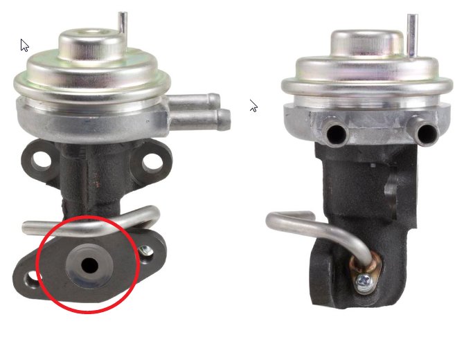

    The EGR will be on the intake side of the head towards the firewall on the 2.4/2.7. It is held on by 3 bolts and has a vacuum line and a hose IIRC. It is fairly easy to remove.
    The 5VZ does not have an EGR.

    It looks like similar to this

    thanks so much, the shop tried changing the vacuum lines today for a PO402 error, already changed the EGR temp sensor. They advised me that if the light comes on again, I will need to replace the EGR Vacuum sensor. So that is the whole assy, I would need? The pic above?
