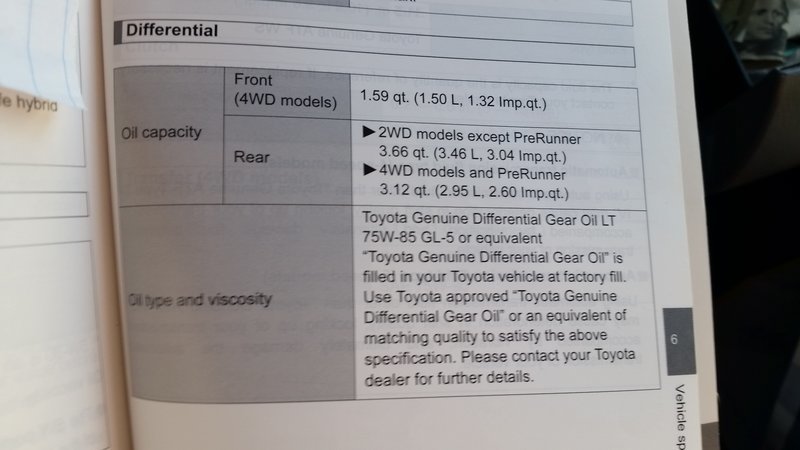

    Put a pan under it and remove the fill plug on the side. Remove the fill first because if for some reason you can not get it out after draining your screwed. After removing fill plug remove the drain plug on the bottom and let drain for 5 min or so. Clean area around drain plug and reinstall. With fill plug removed take your bottles of oil and cut the cap with wire cutters or a knife and hold them horizontal and squirt the new fluid in. When it overflows out the fill plug that is the proper amount, your vehicle needs to be level front to back and side to side when you do this.
    Oils weight should be listed in your owners manual but I show it as 75W-85 and 1.43 quarts to fill.

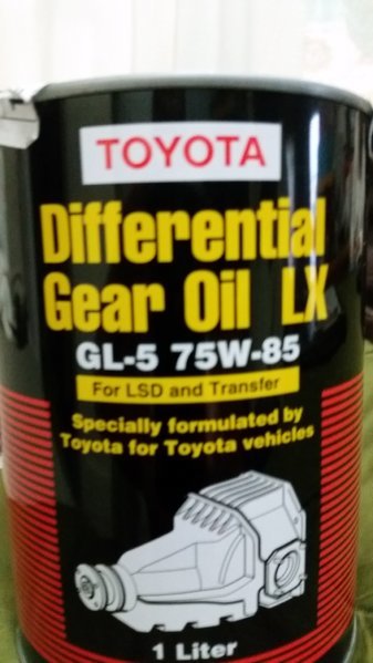

    1320Fastback I went to All auto part's stores around my area n they Don't carry the oil per The Book.
    in the Dealer they toll me my truck use this oil $79.00 per qt, Do i need this??20170131_152021.jpg 20170203_144027.jpg

    For rear diffs, the higher the second number in the oil viscosity rating, the better. 75W85 is not as good as 75W90, which in turn is not as good as 75W120 or 75W140.
    75W90 is the most common weight found in stores. Just buy whatever major brand (Mobil, Valvoline, Castrol, Lucas, Quaker...) that's on sale. Typical price is $12 per quart for synthetic.

    Check eBay. I purchased some Toyota LT 75W85 gear oil for $20/liter including shipping. Local dealership price was $27 each at wholesale pricing plus sales tax.
