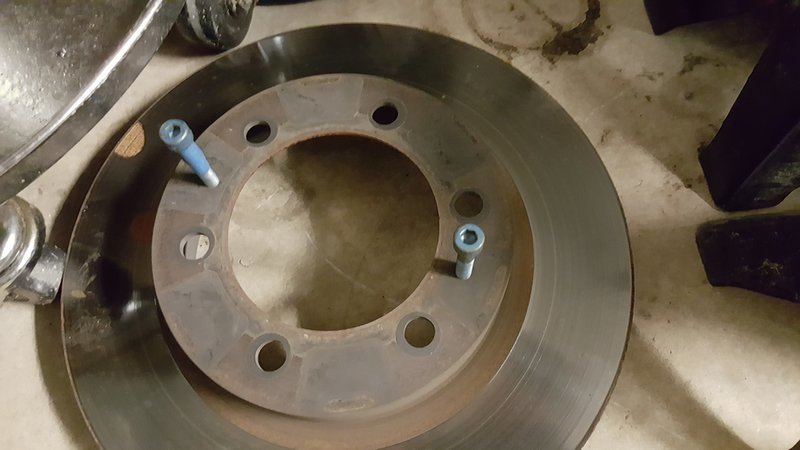

    I used this thread toady to change my pads and rotors. The 1 thing I want to add is I had a difficult time removing the rotor. Beat the first one for a while and it never broke loose. Ended up using two M6 bolts to break them loose.

    Nice post. You can use the same trick for the rear drums.
