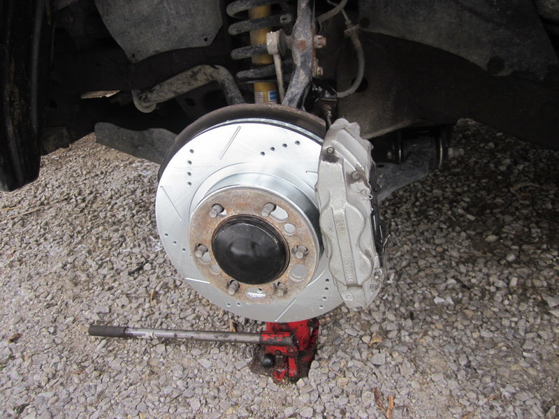

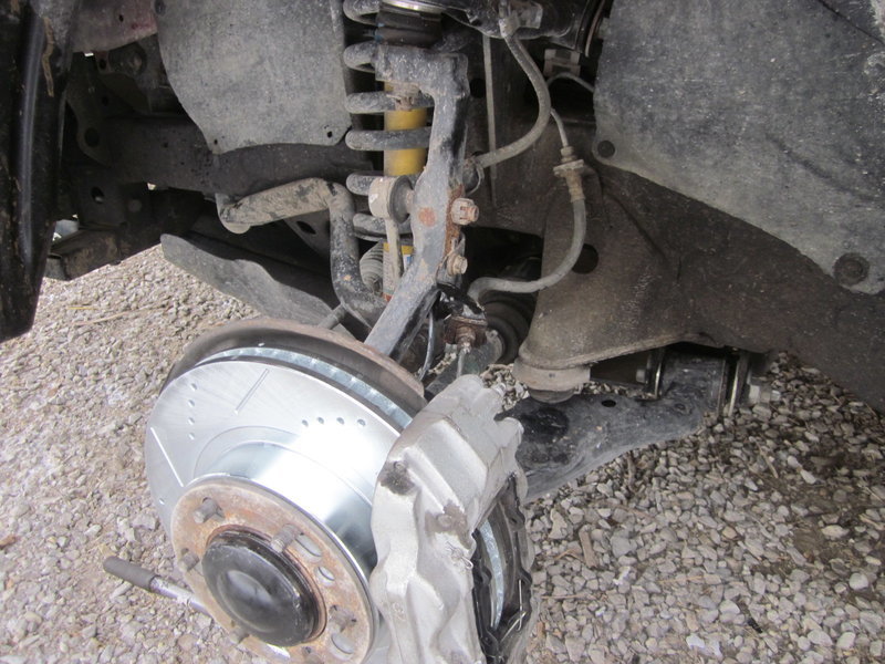

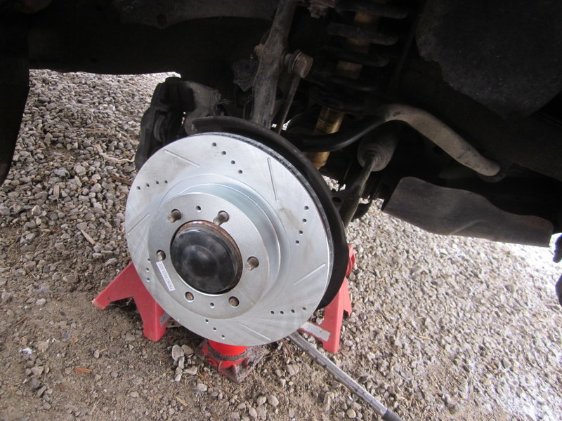

    Just put the Powerstop pads and rotors on my 2006, and love them! The kit comes with everything, but a little extra grease for the back of the pads would be helpful.
