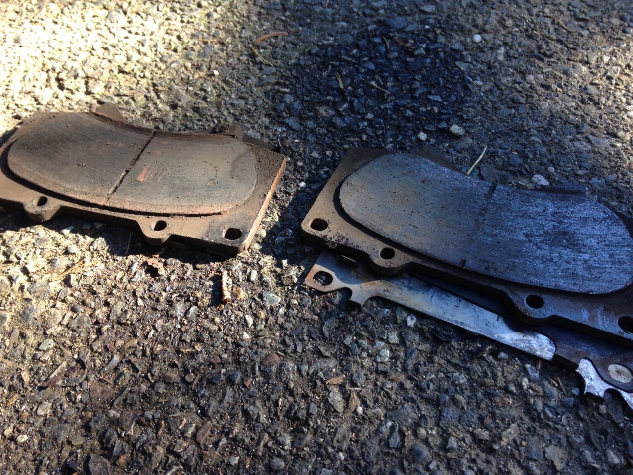

    Thanks for the video! Here are my old pads with 96K. Went ahead and bought the brake caliper tool which made the job super easyIMG_3944.jpg IMG_3947.jpg
