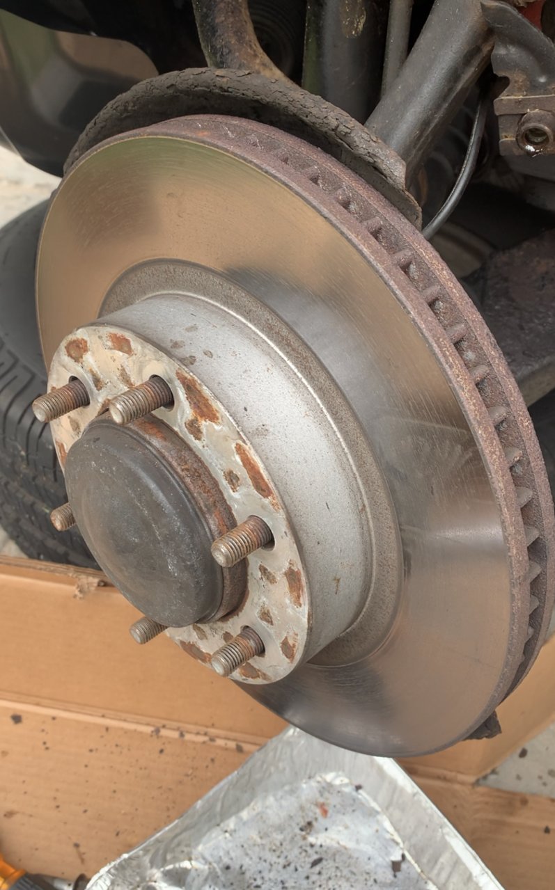

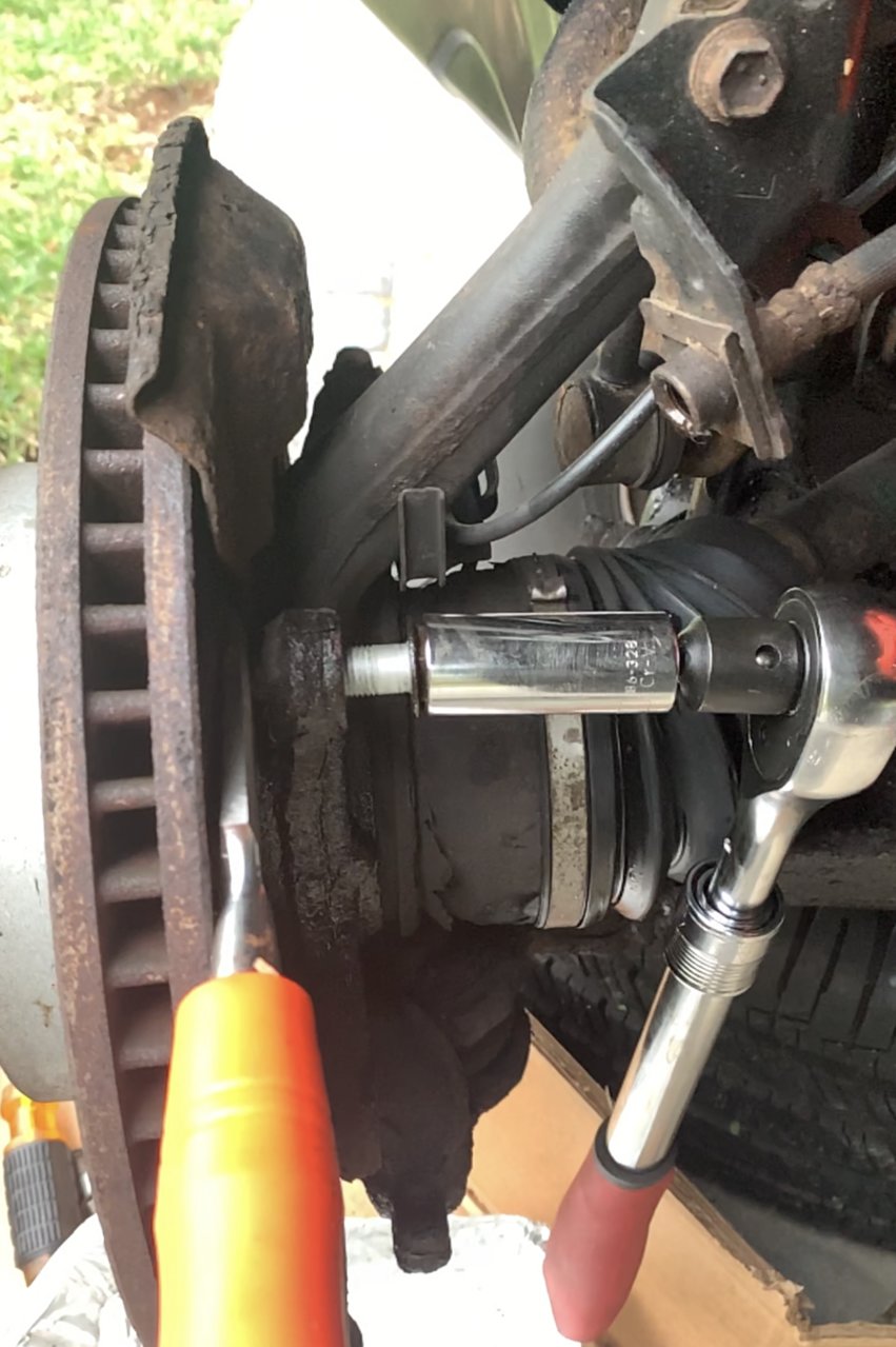

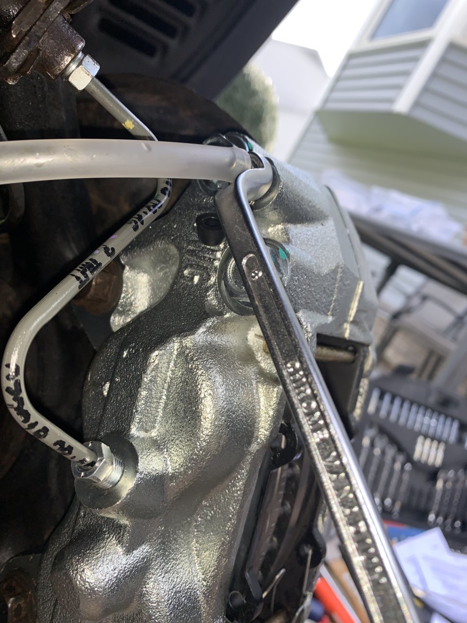

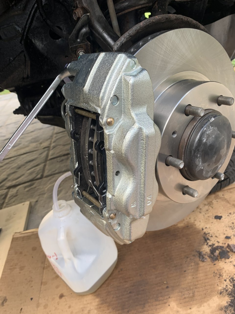

    This weekend I followed this procedure to replace: Calipers, Pads, Rotors and the hard brake line pieces that connect to the calipers. The hard brake line was badly corroded. I bought a kit from Rock Auto: KCOE137 which included just about everything except the hard brake line. Kit includes pins, clips, grease packets (for the back of the pads). I bought those from a Toyota dealer:
    Part Number Part Name Price Quantity Total
    47318-04110 Tube Front Brake No.8 $4.70
    47317-04050 Tube Front Brake No.7 $4.70
    These numbers are for Gen 2, V6, 4WD.
    The hardest part of this was getting the rotor off. The ones that were on there did not have threaded holes. I beat on one side for an hour and was looking for good ideas beyond getting a bigger hammer. I don't have an air compressor / impact wrench. It dawned on me that you can use the brake caliper bolts (and bolt holes) to apply force to the back of the rotor. It worked! I was able to get the rotor that I pounded on off almost immediately. On the other side I followed the steps below and was done in 10min. I am assuming others have done this but just in case someone else is stuck here are the basics and a few pictures.
    How to Remove Stuck Rotor with Caliper Bolt:
    Assuming your caliper is fully off the rotor.
    1) Go ahead and beat on the rotor with a hammer between the lugs (that does help this process work).
    2) Apply some penetrating oil to the caliper bolt and threaded bolt hole. (The caliper bolt does not normally go all the way through during regular use so the back part of the hole had rust etc that needed to be cleaned out in my case).
    3) You need a steel spacer about 1/4" thick to bridge the cap from the end of the Caliper bolt (fully inserted). I used a 1" wide chisel which was perfect. I could guide it in there, it is made of strong carbon steal, and it is relatively flat.
    4) Turn the bolt until it is flush against the chisel and ratchet until there good pressure on the back side.
    5) Then wack with a hammer from the back.
    6) You can try this on the 2nd caliper bolt also if one bolt is not doing it. That would spread the force load on two bolts, two holes etc. You do NOT want to damage the caliper mount points!
    7) Once your done, clean out the oil on the bolt / bolt hole with break cleaner before reassembly. Some people swear they should go in dry so they don't back out. Better safe than sorry.
    Be careful not to overdo it!! (You could bend or brake the caliper mount point). Use common sense and watch as you ratchet.
