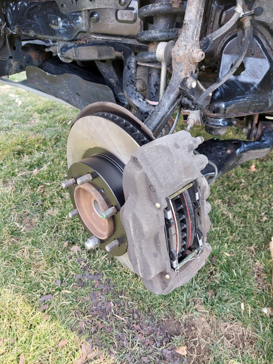

    I would also add that the PreRunner(2008) also is 91 ft. lbs. for the caliper bolts.
    Thanks @LoadedTaco for the writeup! Appreciate that. Used Toyota OEM parts. Pads + rotors + pins+ pin hole clips and anti-rattle springs. Used the copper anti-seize on the caliper bolts and the back of the pads and top and bottom as well. Silicone paste on the caliper pins.
    This is only the second service on the brakes for this truck(original owner). That was a BG brake flush @~66,000 mi. I was expecting to encounter stuck caliper pins(had my Kroll ready), but they came right out with no problem. Broke loose the caliper bolts with a breaker bar. Both sets of pads had uneven wear(as LoadedTaco mentioned).
    I cleaned up and reused the spacers(two for each brake pad). Cleaned what little rust was on the hub with a wire brush.
    I have one small problem. A small amount of brake fluid overflowed out of the reservoir when compressing the pistons. Brakes seem to function AOK. Not sure if I need to bleed the brakes or if I can just remove some brake fluid from the reservoir.
    I'm going thru the thread now to see if this is covered.
    Other than taking a long time to accomplish(me being careful not to forget a step or three) and the brake fluid issue, all went remarkably well.

    +1 on the brake fluid overflowing the reservoir. How did you remedy that?

    One way to remedy that is to remove some brake fluid from the reservoir before starting. You can use a "turkey baster" to suck out some fluid.

    Thanks. That seemed like the only easy way to do it.
