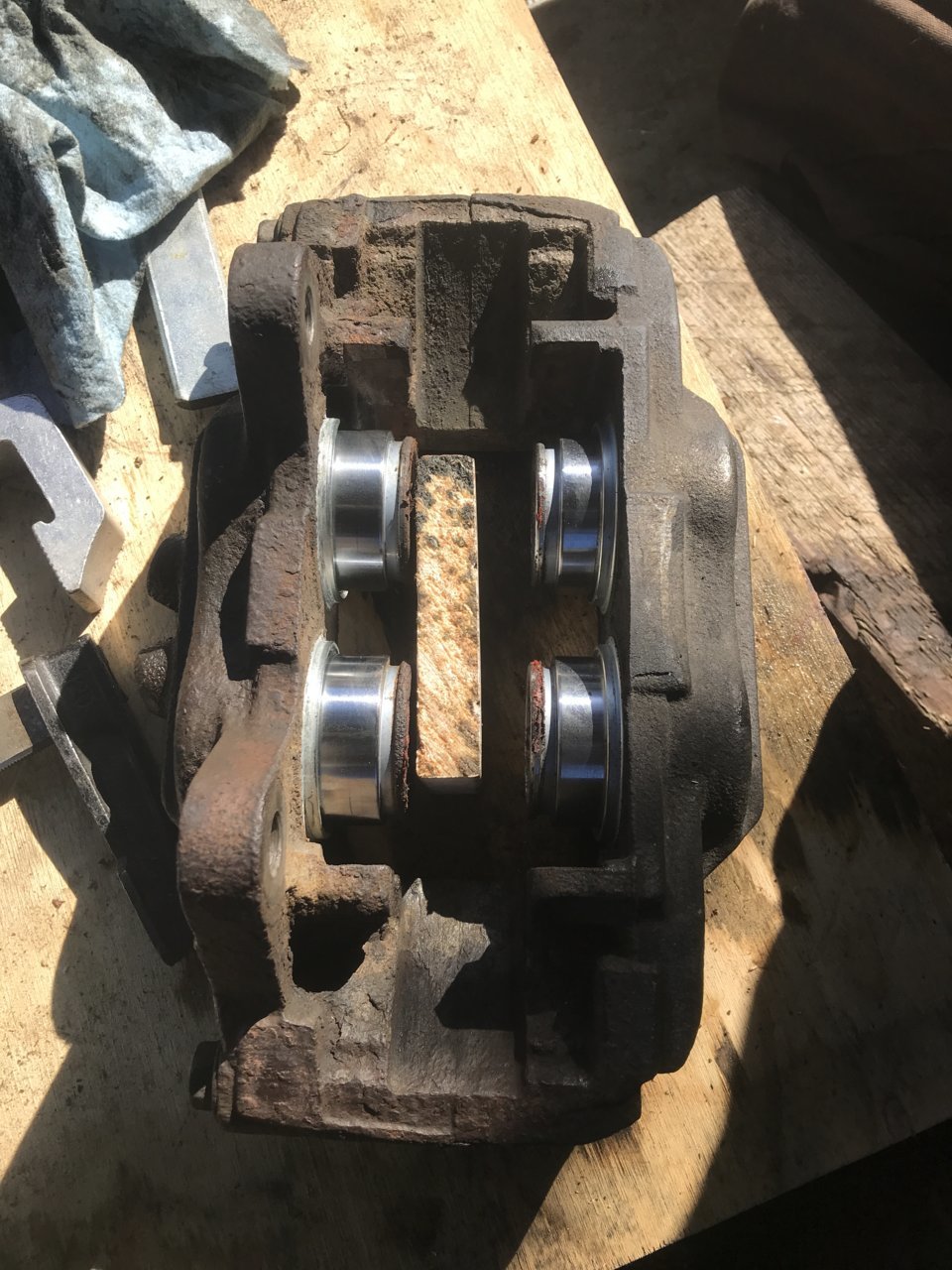

    OK we rebuilt our calipers and a BIG thank You for this suggestion!
    Our brake fluid was clean, changed every 2-3 years, but behind the pistons was the black granular material mentioned above.

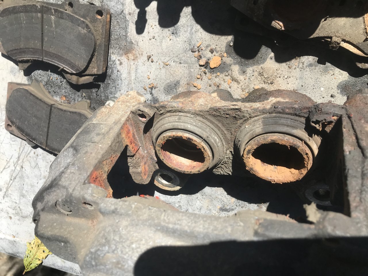

    No pistons were frozen ,,, but we had the drtvers side inner lower very rusty inside , see pic as was the inner lower on passenger side. Design fault where these two locations have water in them a lot ?

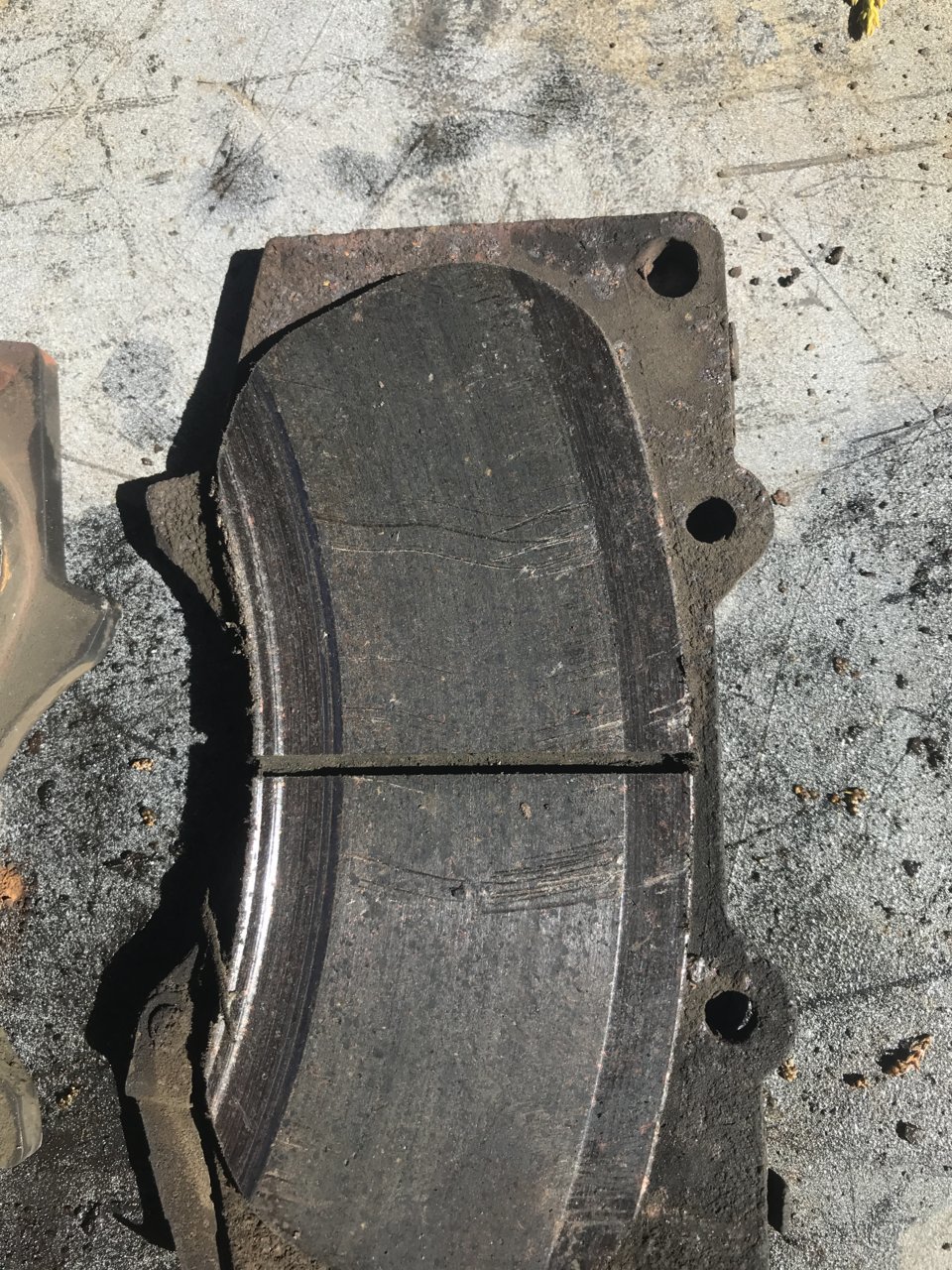

    Drivers inside pad was scored , rock from logging road caught between it and the rotor? Pads have 80+% left on them, this one worn much more than the other 3.

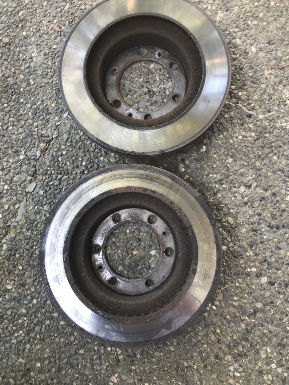

    Rotors good, very little runout, they are original turned once, you can see the rust build up on the lower one where the damage to the pad was

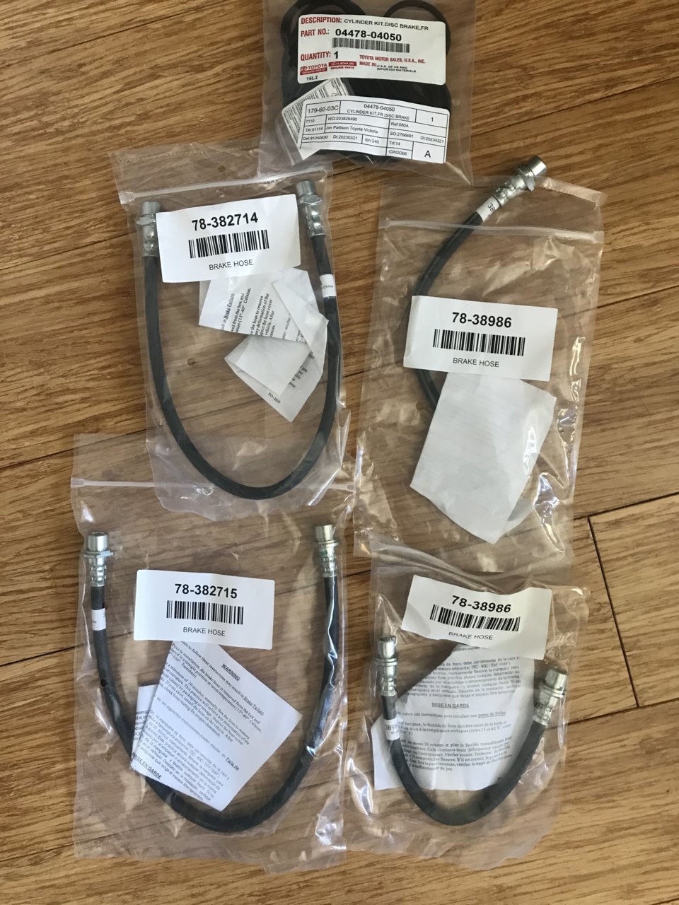

    Kit ( can) is here along with the new hoses we are going to replace
    Pistons come out easy with 20lbs air pressure, see this video, https://www.youtube.com/watch?v=qoQlAW4DPnA
    Kit Number in Canada
    Rebuild Kit OEM
    04478-04050

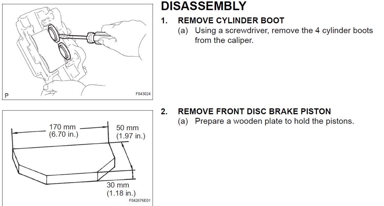

    OEM Manual instructions for spacer to press out the pistons
    Be careful work slowly, we had to reinsert a couple of pistons to get them all out far enough to pull with our fingers.
    Cleaned everything, very careful not to scratch pistons or caliper linings. We cleaned the calipers off most of the rust carefully, the factory plating ( paint ) is still good. Outside surface of the calipers is very nice still.

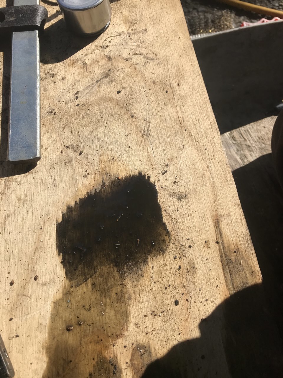

    Pic of the dirty brake fluid behind the pistons
    To test accurately we replaced everything as is, bled the fronts only ( temporary ) and found the wobble in the brakes completely gone. They had a slight pulsing you read about all the time in these forums, reason for this rebuild.
    Long story short, the pistons were not closing at the same rate, we believe. Solved a problem that has been vexing me for a while.
    I was pleasantly surprised to find the worn pad groove as well, it was surely causing issues. Never see anything like that. We are on logging roads, whcih have sharp blasted rock as road base.
    We are replacing the hoses, the 2 small hard lines on each side of the fronts, and new rotors and pads. I'm not keen on the rusty look of non-coated rotors, so may try one of the more modern brand.

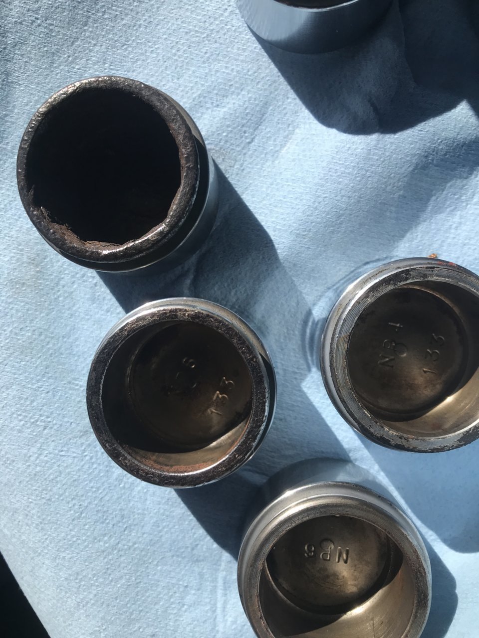

    2 Lower inside pistons have so much rust, I am buying replacements and will change them when we do a brake job. The others cleaned up beautifully.
    No scoring or damage to the mating metal surfaces. Just the interior as you can see in the pic below.
    Many thanks for the suggestion quoted above !
    Hope this helps someone along the way. Would only recommend this one for guys already doing their brakes.
    You need tools , air compressor, pics to remove seals, not difficult, but takes time. Plan a day.
    Build the insert block, say 3/4" ply plus a piece of 1/4" and cardboard shims (?) to get to the 1.18" This will save using woodclamps etc and you will get all 4 pistons out near the end out their throw, close enough to wiggle out with your fingers.

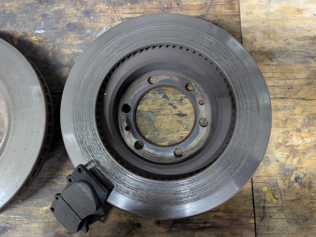

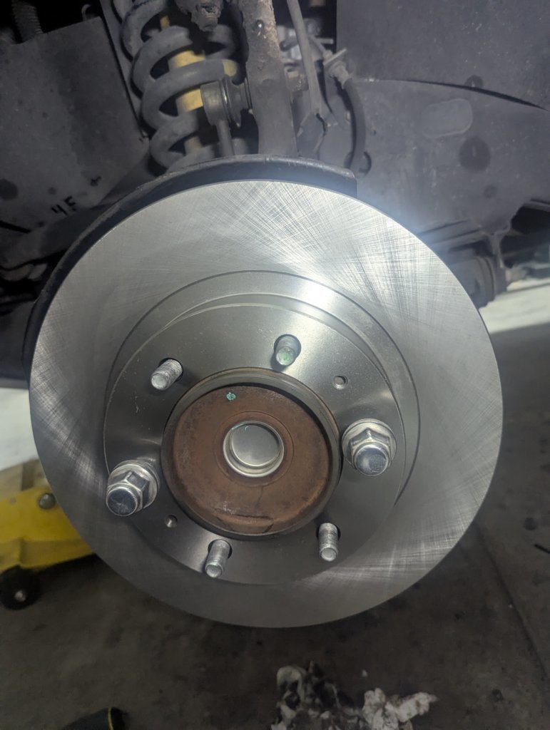

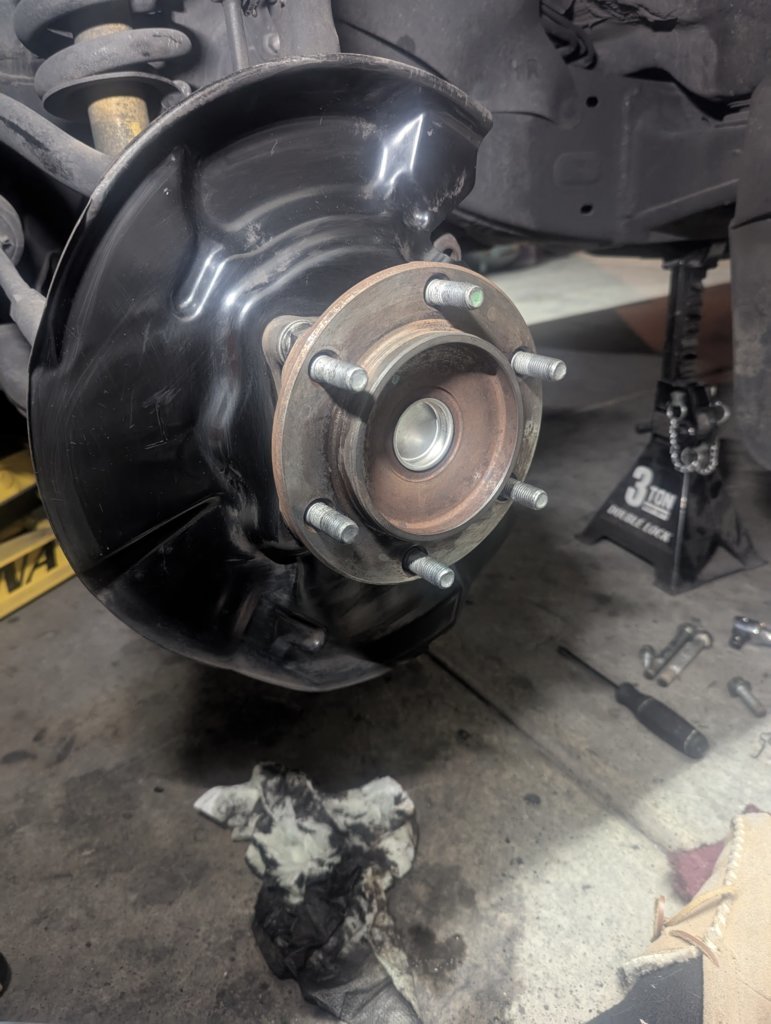

    The previous owner included rotors and pads from Detroit Axle. Did the front driver side today and will knock out the passenger side tomorrow.PXL_20250110_021540245.jpg PXL_20250110_022239738.jpg PXL_20250110_032405504.jpg PXL_20250110_032358230.jpg
    Update
    I changed the passenger side and quickly discovered the source of the shuddering brakes! I can see why the previous owner had new rotors on hand!
