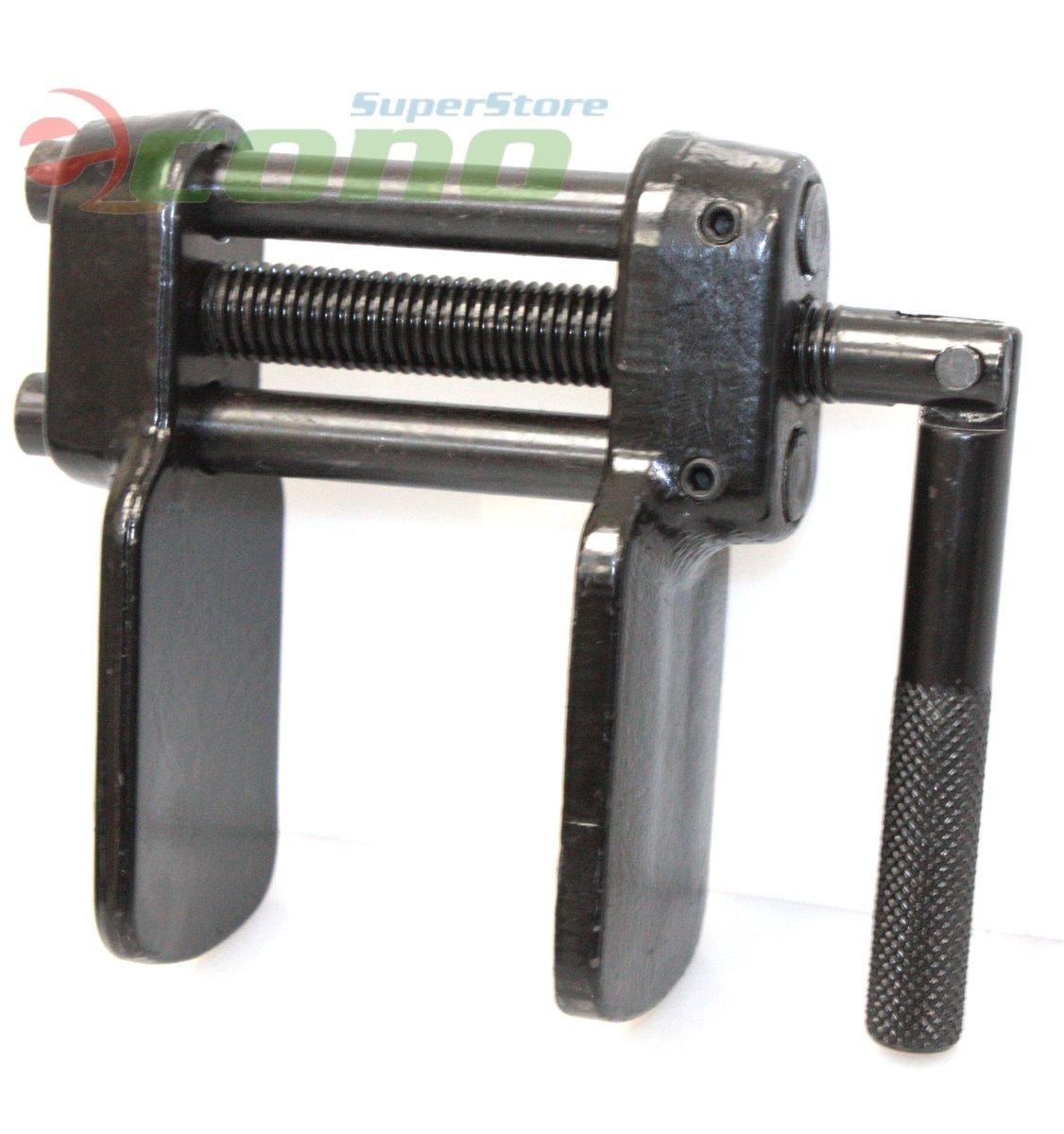

    Just wanted to confirm, is it ok to spray brake cleaner on the entire assembly (rotors and inside/outside of calipers)?
    Also, I don't have the tool that separates the brake pad and rotor. Any recommended ways to do that without marring up the rotors?

    yea I know he used a tool he specifically bought on Amazon, but that is not addressing my question...

    I did not reuse the shims.
    Yeah brake cleaner is no big deal.
    $20.00 ebay
    http://www.ebay.com/itm/Disc-Brake-...1224440188&pt=Motors_Automotive_Tools&vxp=mtr
