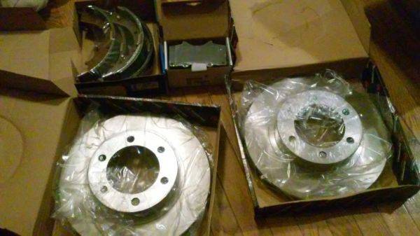

    mine just showed up on my front porch yesterday (my wife "ordered" them for Christmas) i, i mean she, went ahead and ordered me some shoes for the rear too as they have been getting pretty loud. ill be pretty busy between Christmas and New year's
