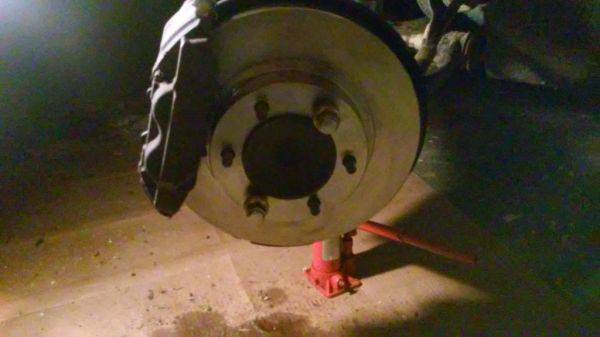

    I just installed an EBC Stage 4 Brake Kit. My 1st diy brake job. OP's write-up was extremely helpful. +1 to LoadedTaco!
    Rotors were difficult to remove. But I just kept hitting the hat between the studs & it finally broke loose. I used a wood framing hammer with a smaller head to minimize the chance of hitting or damaging wheel studs. That was hardest part.
    My Harbor Freight 25" breaker bar made caliper bolt removal a breeze. Definitely a handy tool for brake jobs.

    Some pics:

    Kit looks sweet! Be sure to follow the EBC brake in procedure and enjoy the improved braking

    Hey Chas. This is the left rotor installed on my driver-side. Did I get it right? Are the slots facing correct direction?
