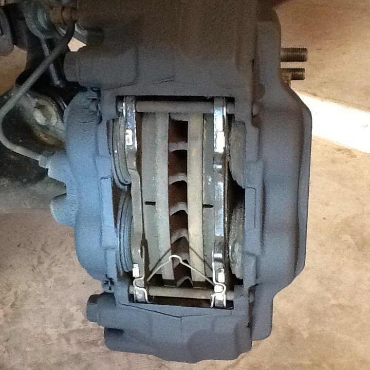

  5. Apr 14, 2015 at 4:33 PM
    #85
    Boilerman
    Boilerman Well-Known Member
    Apr 18, 2010
    #35501
    570
    Brian
    Texas, northwest of the Big Pond
    2010 Prerunner SR5 Magnetic Gray 2.7L
    Was thinking I needed to probably change all the pads at 82K. Still got a lot of pad left. Guess I can take the ones I bought back. Went on ahead while I had the wheel off and painted the calipers black.

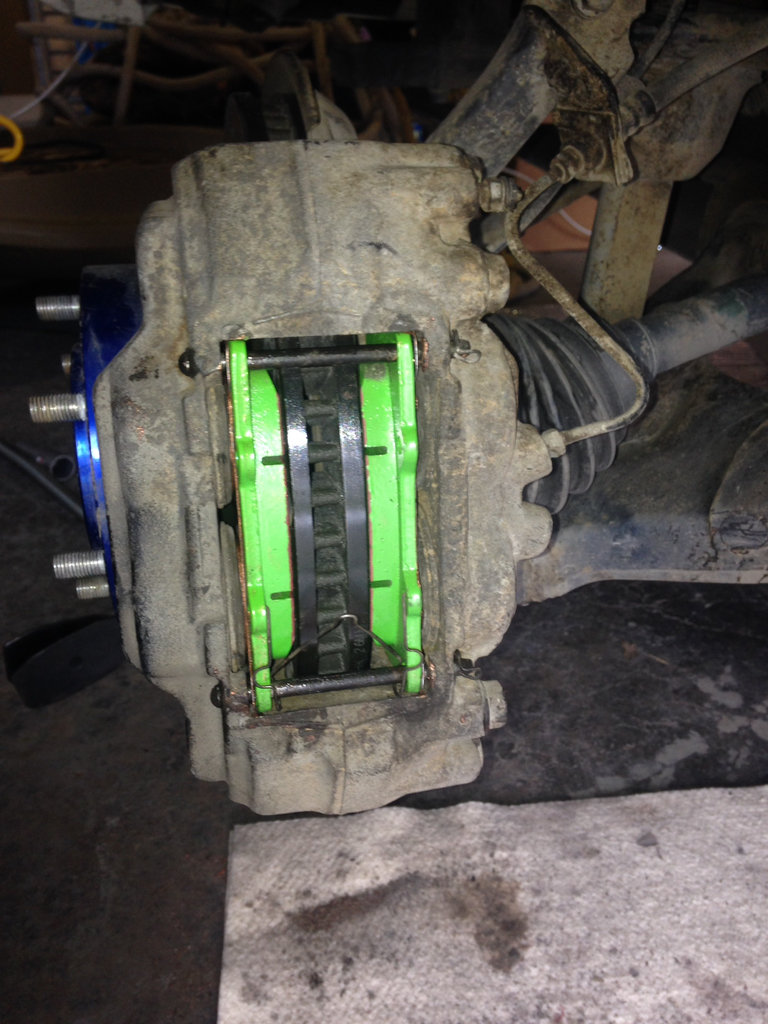

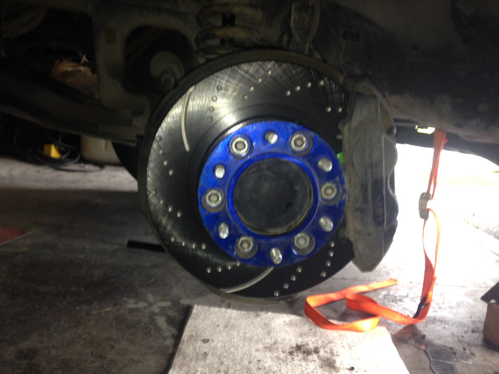

  8. May 21, 2015 at 7:41 PM
    #88
    uscg2008
    uscg2008 Well-Known Member
    Nov 6, 2009
    #25537
    2,879
    coby
    San Diego, CA originally from Huntington Beach, CA
    06 trd sr5 four door 4x4
    CLICK ON SIGNATURE>>>>
    Got mine done
    3b2b372e151d655df118f9a4a23372ef_zpsitya_e2f79b0a4f0bedbbae2a14ba7558d22de2411f72.jpg
    d1a81dac8e48dd493ac64de2b3009700_zpslsho_9f8da1e7e2c2b49126610ed918920e4d4b8f6af2.jpg
    feb90f6922b9bd3b86029f8c4bf85fb6_zpsh95m_c3eb992429881036b44a30c00b4858316bcfea5e.jpg

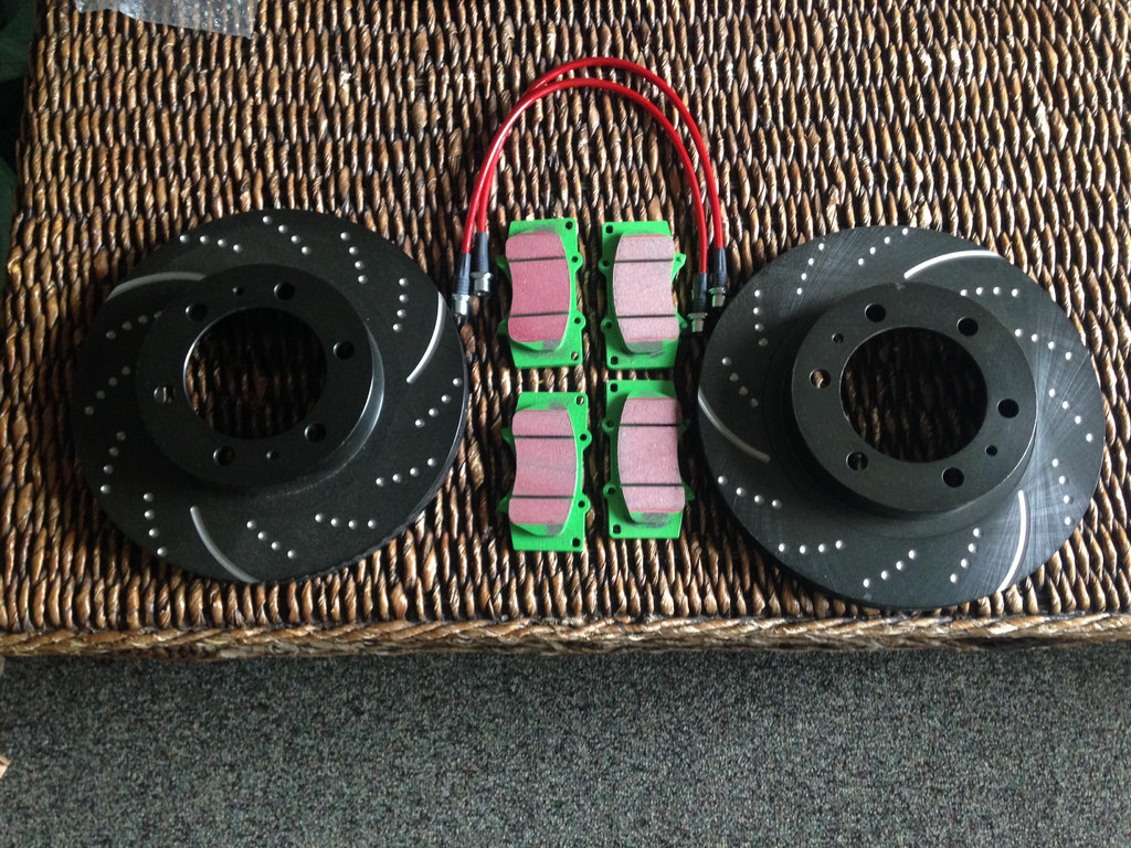

  14. Jul 2, 2015 at 9:30 AM
    #94
    kingston73
    kingston73 Well-Known Member
    Aug 8, 2009
    #20845
    3,036
    North eastern Ohio
    09 SR5 4.0L 4x4
    OP, thanks for the video. I just changed my pads and rotors today. I have to say, I'm very disappointed in the EBC green stuff pads. I installed mine at 30000 and now at 65000 they were completely worn. I expected more than 35,000 miles out of a set of pads, is this an unrealistic expectation?
    I replaced them with Akebono ceramic pads and centric rotors, hopefully will get more miles out of these.
