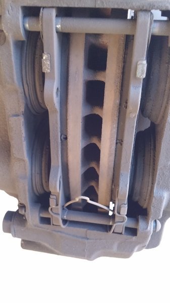

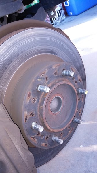

    Hello everyone, I'm thinking of changing my brakes for the first time. My current 2008 tacoma has 73k miles. I have no problems with stopping and no noise issue. Here are some pictures of my passenger brake and rotor. Do you guys think it is time to change or I can last another few thousand miles? Driver side brakes and rotor looks the same as passenger Thanks for the advice. If you have any advice for brake and rotor kit recommendation. Considering the EBC Stage 4 Signature Brake Kit.

    #174
    QChawks
    QChawks Well-Known Member
    Jan 18, 2015
    #146678
    886
    Davenport, IA
    2009 TRD Sport DCLB
    ^looks like quite a bit of pad left. I'd let it go another 10-15k miles and check again.

  15. Feb 23, 2016 at 6:12 PM
    #175
    xJuice
    xJuice My spoon is too Big!
    Oct 24, 2007
    #3208
    9,910
    Josh
    N. Texas
    19 Tundra MGM
    TRD Front & Rear Sway Bar, TRD Pro LED Headlights, Undercover SE, Rear diff. Relocate, console organizer, debadged, color matched handles, mirror caps, and grill
    Yep still some good pad left. I use that slit down the middle of the pads as a wear indicator. Mine was just a little more worn than these and changed them and the rotors just because of the mileage I had on them (105k I think) and was getting a little rotor wiggle. I never actually got to the actual metal tab screeching indicator....
