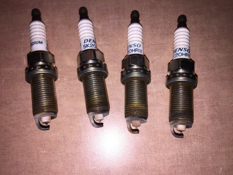

    Great write up! I waited until 120k. Attached is a pic of the plugs I pulled out. Running smooth as ever after the swap!image.jpg
