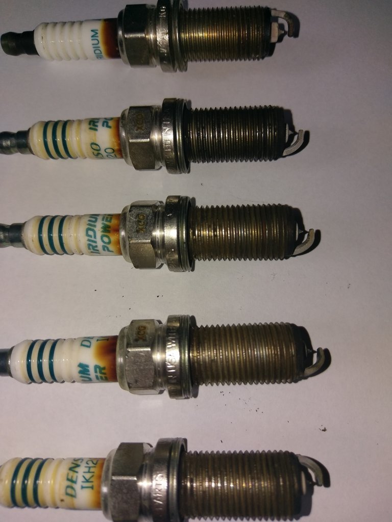

    The one at the top is one of the original plugs pulled at 90K. The rest were just pulled at 131K. When i bought them, there were two options of denso. I grabbed the wrongs ones (IKH20). They worked ok, but i don't think they last as long. Developed a little bit of a stumble lately so i went ahead and swapped em. Hopefully that cures it. Went back to the factory Denso SK20HR11 plugs that it came from the factory with. The interesting thing to me is how much further the tip extends out on the SK20HR11 plugs.
    seems the ones i just pulled have a bit more carbon build up on them well.

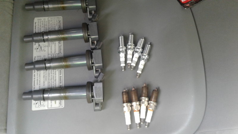

    I just replaced my plugs last weekend @ 108k (assuming original plugs but they were NGK so not sure). I don’t have a lot of experience working on engines so I don’t have a good feel for when the engine is having trouble. That said, since I bought the truck @ 103k it has had a random backfire on ignition and occasionally when reving it. I thought I would start with plugs and go from there.
    Good news/bad news is new plugs made a world of a difference. It’s not that the truck feels more powerful, it just feels as strong as it should be. It’s running smooth and reliable now and I see just how bad it was getting. Hopefully, no damage was done from waiting so long to change them.
    Changing them was fairly easy. If you are in this thread because you think it’s time, stop thinking and do it!

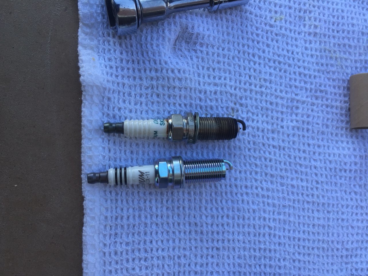

    Just changed mine out this weekend. 2.7 with about 58k. Pulled the stock Denso SK20HR11 out, and replaced with NGK LFR6AIX-11. I tried to find the stock ones locally, but ended up with these. Anybody else try these before? I used this great writeup, and anti seize and dielectric grease. Didn't adjust gap cause scared of damaging the tip.
    Maybe I'm just being paranoid, but truck seems like its lost a bit of power?? Not filled up tank yet so I haven't checked my mileage now. Just curious yall's thoughts on these particular NGKs. Thanks.

    What’s even funnier about this is i’ve been watching your build thread for a while because of the similarities of our trucks. I just mentioned it to my wife last night because I was asking her how she liked the look of the ARB bumper. Not only do we have very similar configurations but I also bought a White shell and painted it (I went Black though).
    As for the plugs, the ones I removed (presumably the originals) are NGK ILFR6T11. The new plugs I picked up from the local Toyota dealer are Denso SK20HR11.

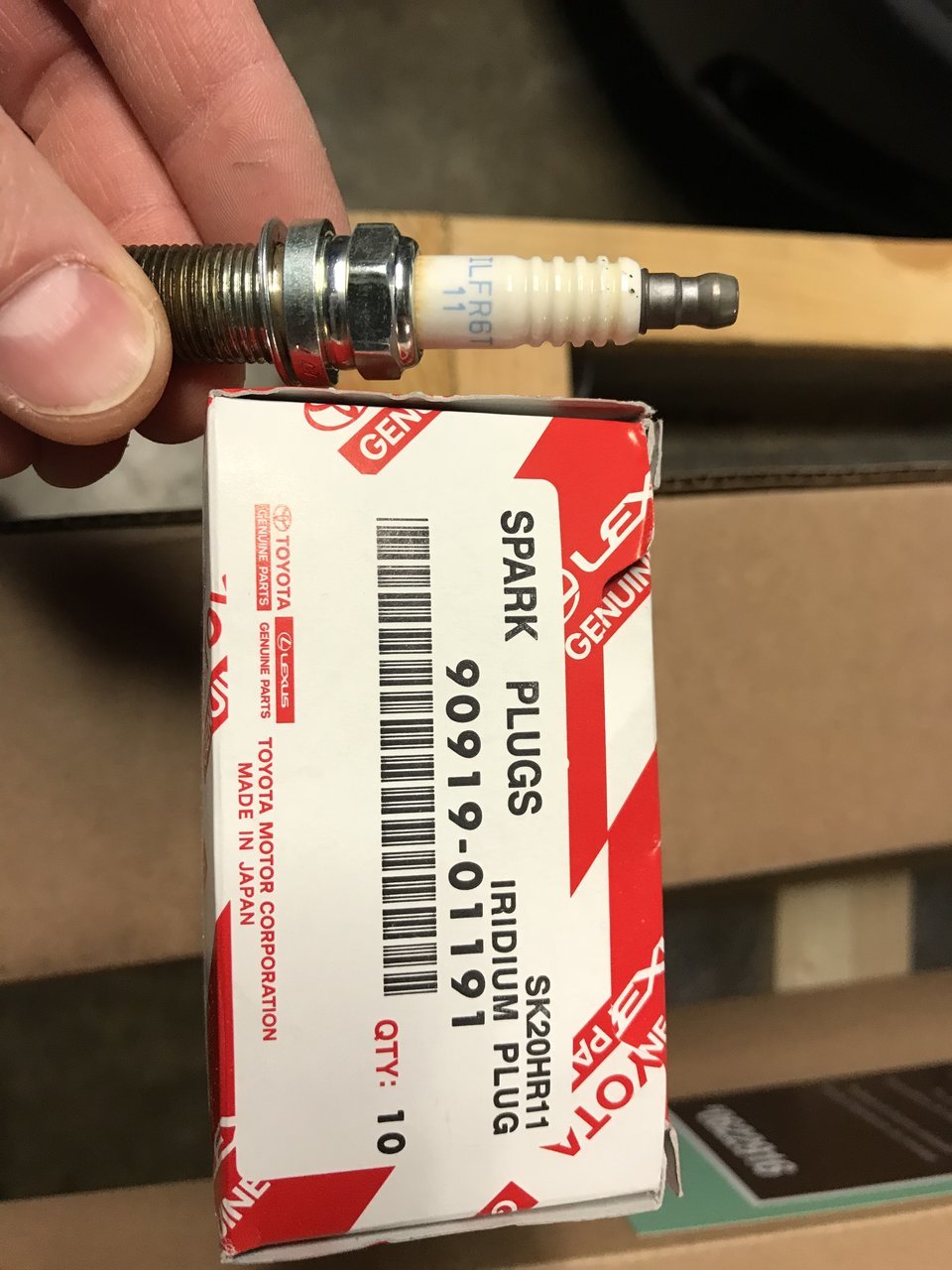

    I used the Haynes manual as my main reference and it gave me the wrong part number. When I went to order the wrong ones Amazon tried to tell me they wouldn’t fit but I decided to trust the Haynes manual instead. That’s when a friend told me spark plugs are one of the thing you should just get at the dealer, and i’m glad I took that advice.

    Thanks a million for the part number! I ordered those earlier this morning based on the sk20hr11 numbers i saw in this thread, but having the true # will make it easier when searching for them in the future. Im definitely adding it to the list of #s for reference that i have in my build :bowdown:

    I used the same NGK plug when I did mine this past summer. I didn't adjust the gap either because I didn't want to risk messing up the tip.
    I didn't bother checking the PN of the plug that I pulled, though they were NGK plugs. 58k miles is way to early to be changing Iridium plugs. The factory change interval is 120k miles.
