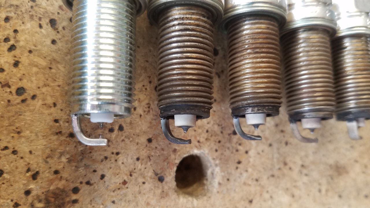

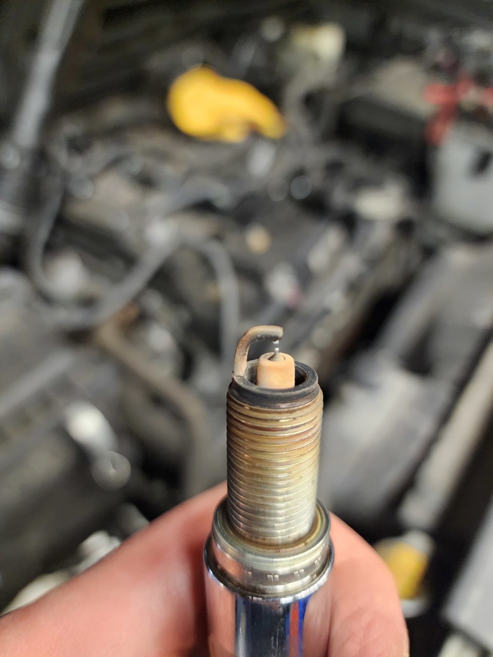

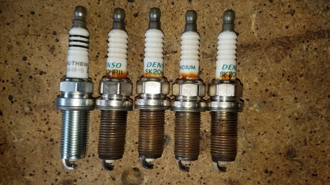

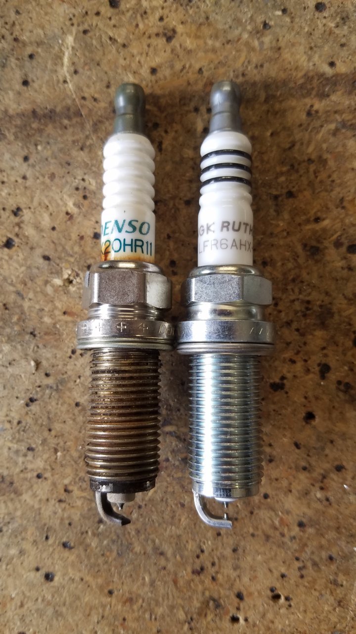

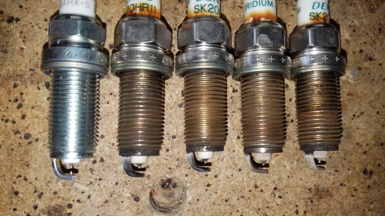

    Just posting for another data point for fellow 2TR owners.
    Swapped plugs on my 2011 this weekend for the first time. Truck has about 105K miles, was running great, just replacing plugs per maintenance schedule. After seeing the old plugs, I'm glad I did. Some notable wear on the ground strap of all the plugs. Nothing crazy or concerning, but the 100K mile interval is about right.
    For the new plugs, went with the NGK Ruthenium LFR6AHX-S (94122). They were only about $2/plug more than the factory Denso's, so figured I'd give them a try. I'm hoping they fair even better than the Denso's over the next 100K miles.
    For the installation of the new plugs, used anti-seize on the threads and torqued to 18 ft-lbs. No perceptible change in how it runs after the swap.

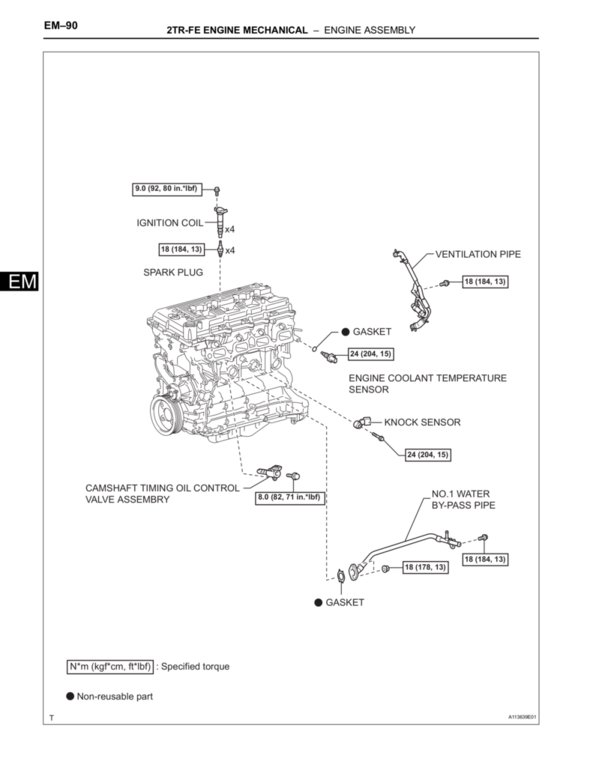

    I'm planning on changing my plugs in the next few months, and looking at the torque specs- it shows 80 ft./pds. for the coils.
    80 ft./lbs. for a little 10mm bolt? Hell, the lug nuts are 83 ft./lbs.
    I have this horrible vision of stripping off the heads at 80.
    At 12:25, the Car Care Nut states that the coils only need to be "snugged down".
    How to change Toyota Spark Plugs on 4 cylinder engines
    any opinions, or anyone have any bad experiences stripping off the heads at 80?

  5. Mar 20, 2025 at 11:31 AM
    #165
    BassAckwards
    BassAckwards Well-Known Member
    May 3, 2016
    #186002
    27,919
    2009 Tacoma AWD Turbo 2TR-FE
    Full-time AWD & BorgWarner EFR 6258
    80 inch lbs. or 6.66 ft lbs
    Steves104x4 likes this.
  6. Mar 20, 2025 at 11:36 AM
    #166
    TacoDell60
    TacoDell60 Well-Known Member
    Nov 25, 2024
    #461246
    256
    that's inch pounds not ft/lbs

  9. Mar 20, 2025 at 11:50 AM
    #169
    TacoGlenn
    TacoGlenn Nobody Makes a Monkey Outta Me!
    Sep 7, 2014
    #137821
    1,389
    PNW
    '13 MGMAC 2.7L SR5
    Hellwig 1251's, Leer 122, Kahtec smart stop delay flashing 3rd brake light, de-chromed, de-badged, WeatherTech mats, WeatherTech side window deflectors,
    Thank you!
  10. Mar 20, 2025 at 9:27 PM
    #170
    Sep1911
    Sep1911 Well-Known Member
    Oct 2, 2015
    #165670
    1,237
    2016 Taco
    Because if I tell you the torque spec is 1.45 lb-ft on bolt A, then 2.1 lb-ft on bolt B how are you going to get those torques in? Lb-in is for smaller fasteners and lets you fine tune your equipment. There’s even oz-in. It’s consistently in N m (newton meters) if you fancy the metric system. The bolts might get along better too. Also fun fact, ft-lb is a unit for work, the unit for torque is actually lb-ft.
