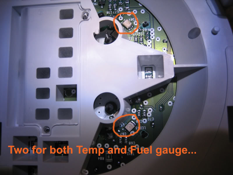

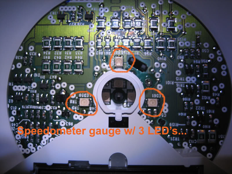

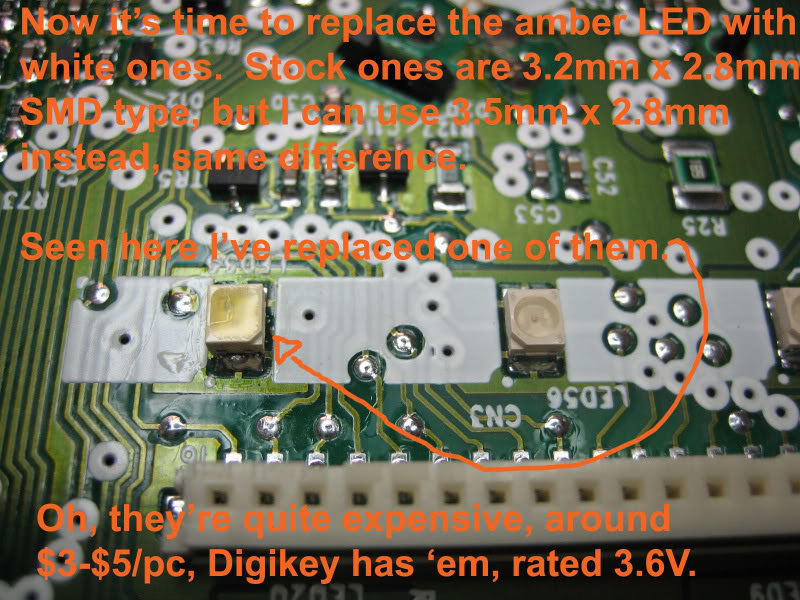

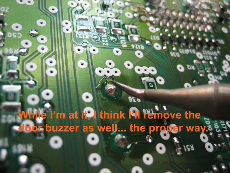

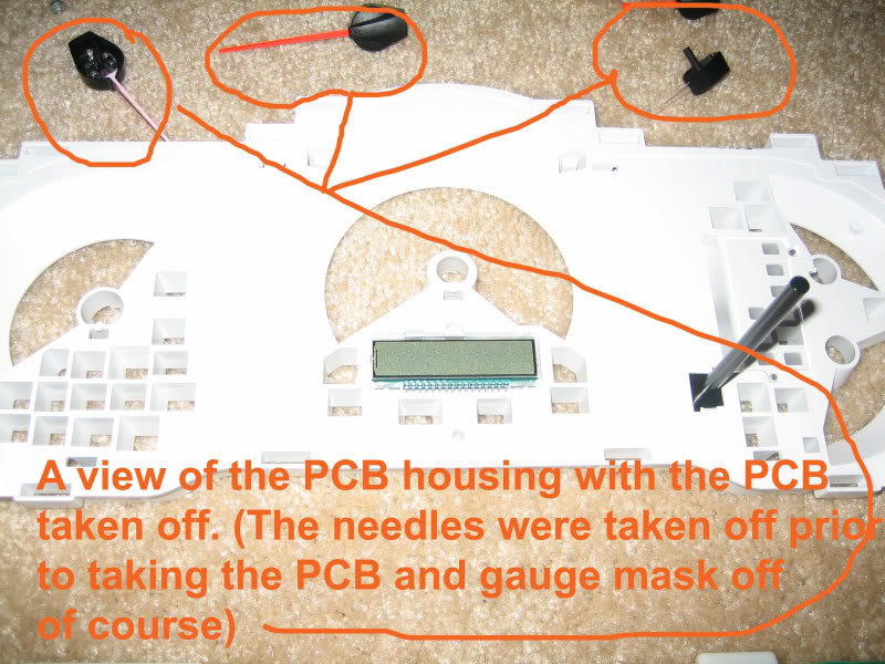

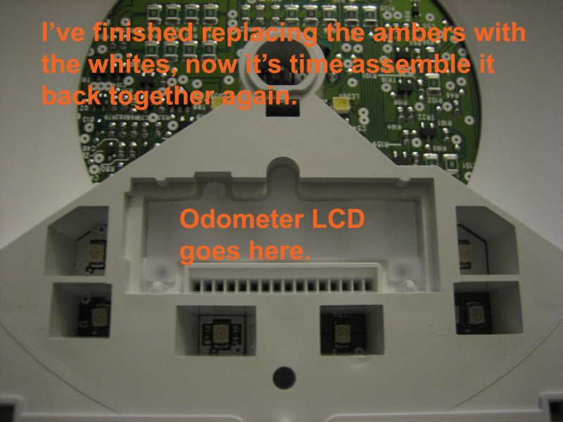

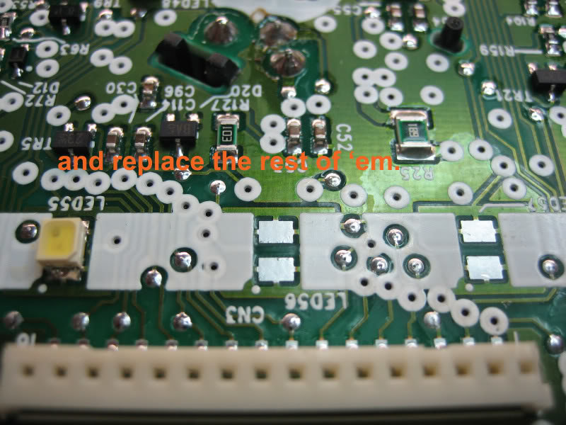

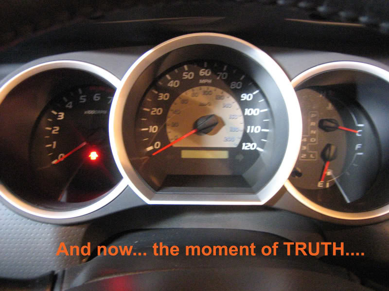

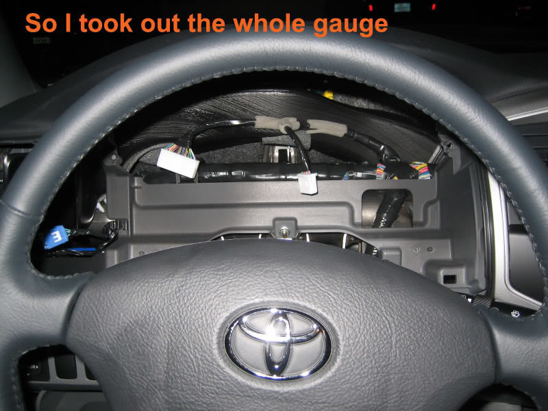

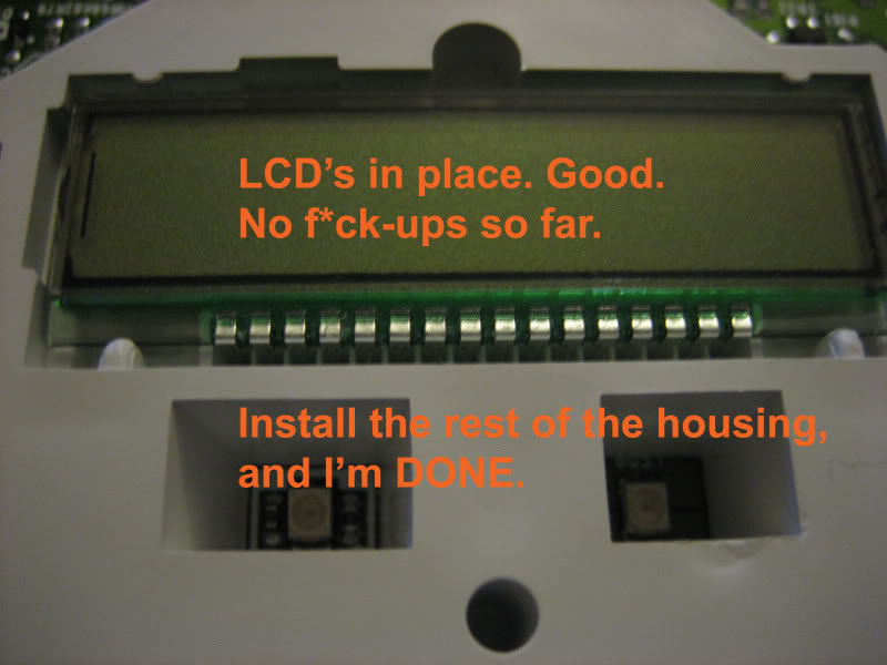

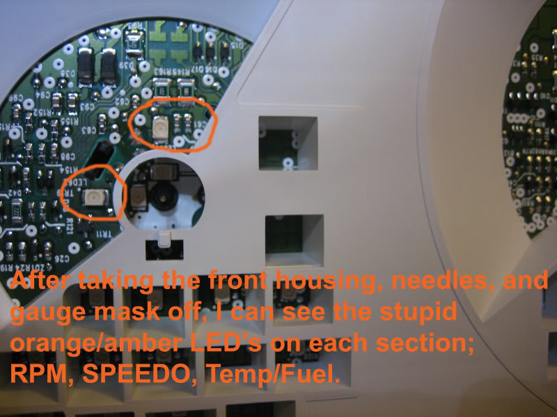

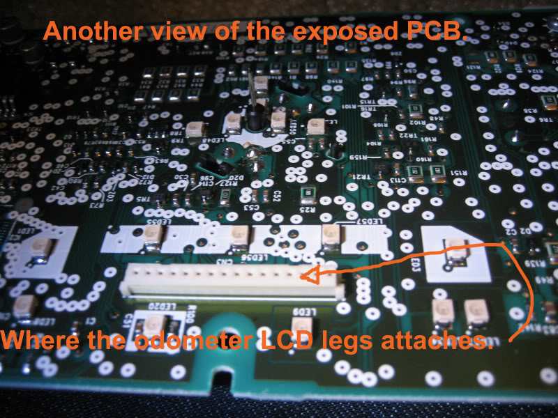

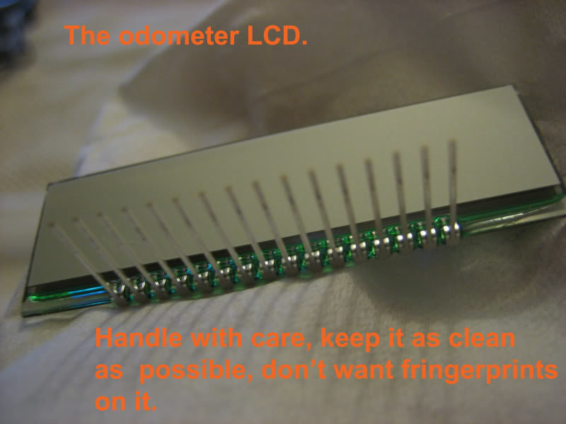

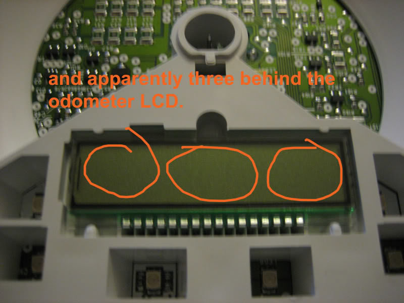

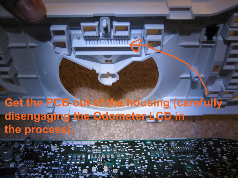

    I love my '07 Taco but I treasure my eyes alot more, so, following instruction from the sticky from CT on how to remove the gauge:
    http://customtacos.com/tech/index.php?article=225

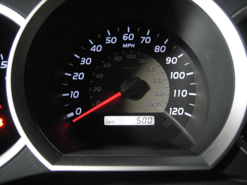

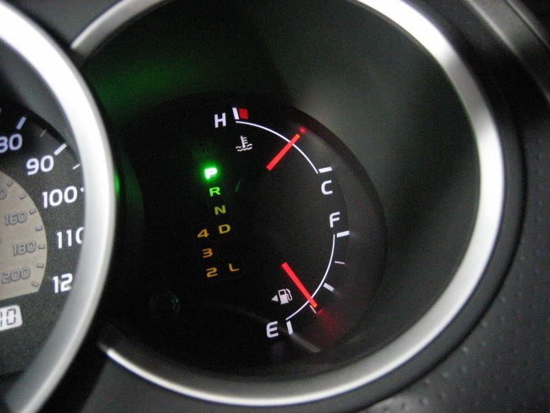

    I began my obsession to have a better viewing when I'm driving:

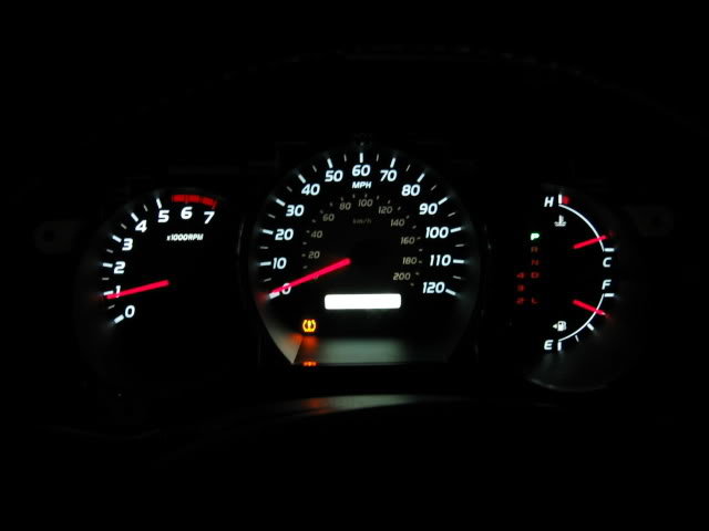

    You see how hard it is to read characters in f'in amber?
    There were 10 LED's total that I replaced. (should be 11 really).

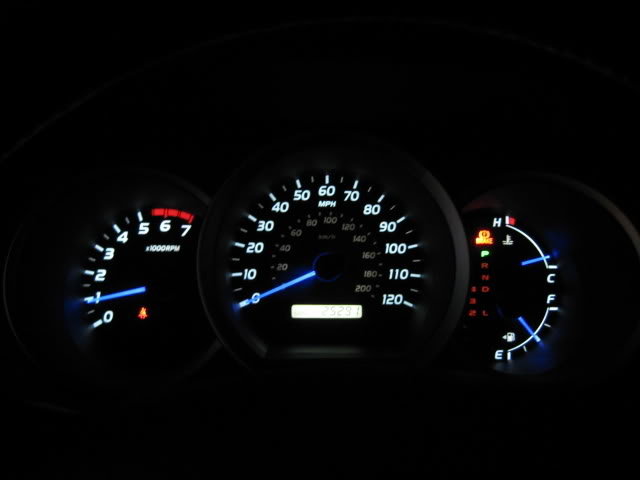

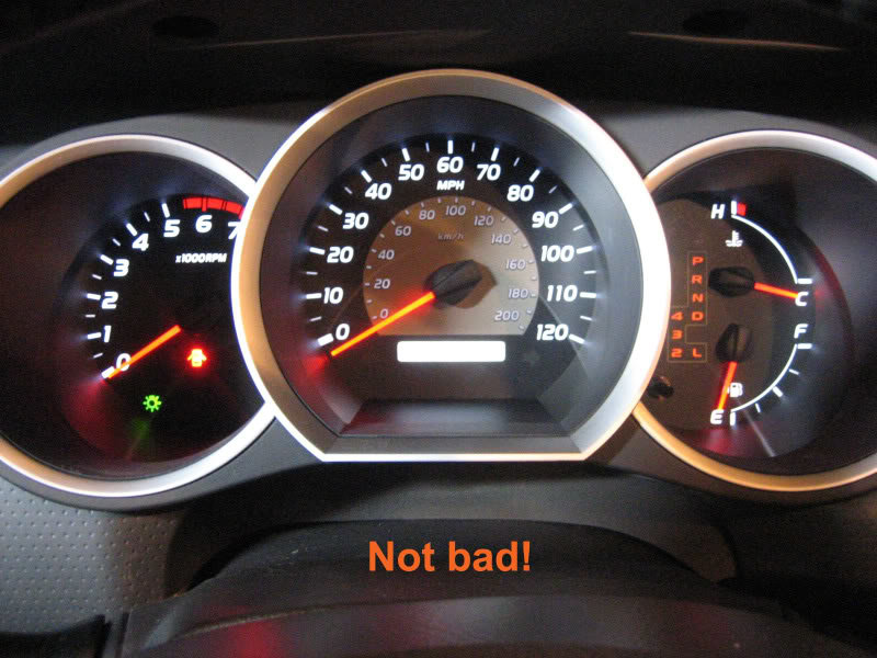

    Now I can Ride In Peace :smokin:
    Additional image:
    LED's can be purchased here:
    http://www.oznium.com/plcc-2

    Nice clean write up, been done before but some great pics here. Nice job :thumbsup:

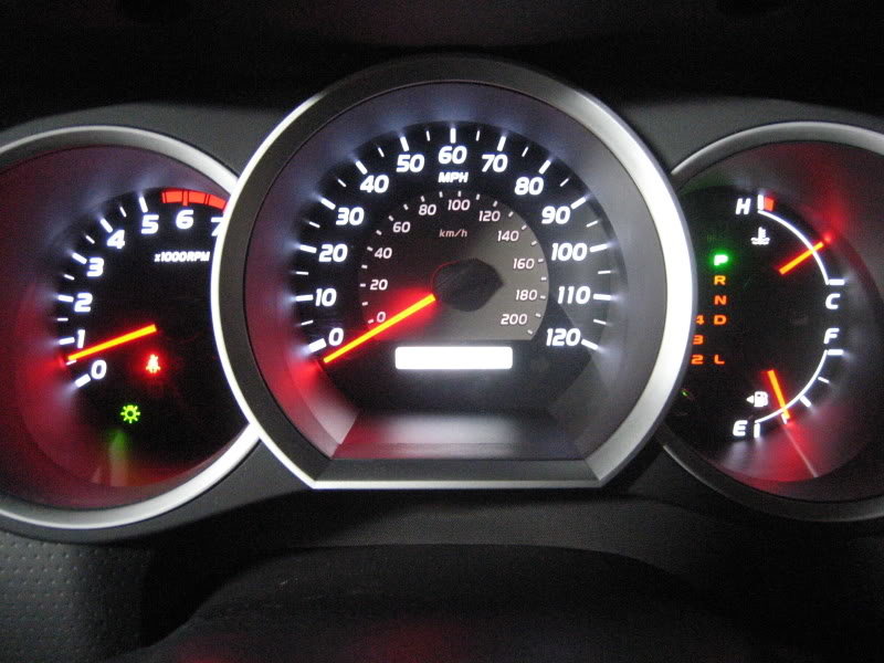

    i love the white dash lights....reminds me of my parents lexus's

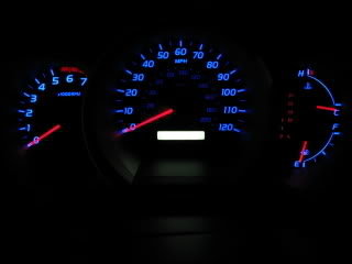

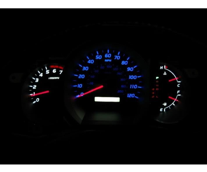

    Almost any color!
    Here are some that I have done:

    WOW those look great thanks for the information.

    Man I love the look of the blue gauge's! I think it would look fantastic with my new Alpine HU. Are those LEDs something that could be found locally somewhere or do I need to purchase them online?

    I think they look really great. The Blue and white LED's make them look more modern. But, there is a scientific reason why the dash is amber. They did research and found that amber light is the easiest for the eye to adjust to when looking down at the instruments then back to the road. While Blue and Green and white look cool, they actually take longer for your eyes to adjust too and they hurt after long drives.
    If you look at any BMW, they have been using amber dash lights since the 70's right down to today. Even their iDrive system uses a brown background, even though I think it's ugly, because the eyes can easily adapt. Just FYI... nobody kill me for pointing this out :)
