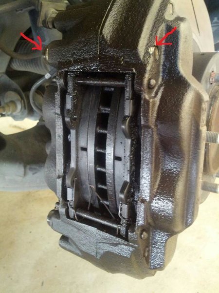

    You should just be able to take your tire off and look at the back of your caliper? You can easily see the pads and how much is left on them
    Ignore the red arrows that has nothing to do with the brake pads lol
