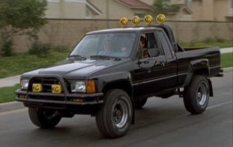

    How much for the Marty Mcfly package???

    :rofl: I like your style
