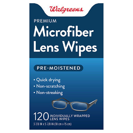

    Gotta new tip for how to clean your Cluster/Instrument Panel Lense without scratching it all up. For minor dust, film and finger prints simply use Microfiber Lense Wipes made for glasses. They are inexpensive and can be found at any drug or department store. Won't scratch

    In most instances it'll be more about the dirt thats on there doing the scratching rather than the thing you're using to do the wiping. Sure, those wipes don't scratch when cleaning classes that just have finger grease on them. But, get the glasses covered in dirt and you'd still risk scratching them. Dirt/debris will turn pretty much any material into a fine form of sand paper.
    The best solution would be to use any clean cloth that you'd use for cleaning your paint or other delicate surfaces. Then use a good quality liquid cleaner that has lubricants in it. Good lubrication will help prevent scratches. Then, use a polishing compound periodically to remove fine scratches and swirl marks - because you'll never avoid them entirely.
