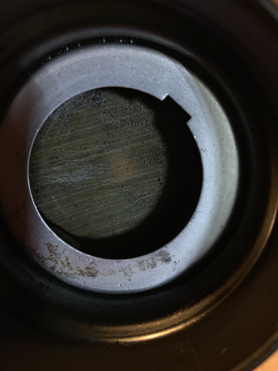

    Once the mesh is out it can’t go back in from what i remember. Rinse it with gasoline a few times till it rinses clean with no chuncks in it.

    The mesh is attached to that metal ring inside the reservoir, and that ring is held in by a few dimples/indentations around the outside of the reservoir. If you can figure out how to undo those dimples you could pull the mesh assembly out. But really, you don't need to remove the mesh once you have the top off the reservoir. You just need to find the proper cleaner. I couldn't figure out the proper cleaner to use to dissolve all the crap that was caked onto the mesh. Brake cleaner didn't work for me.

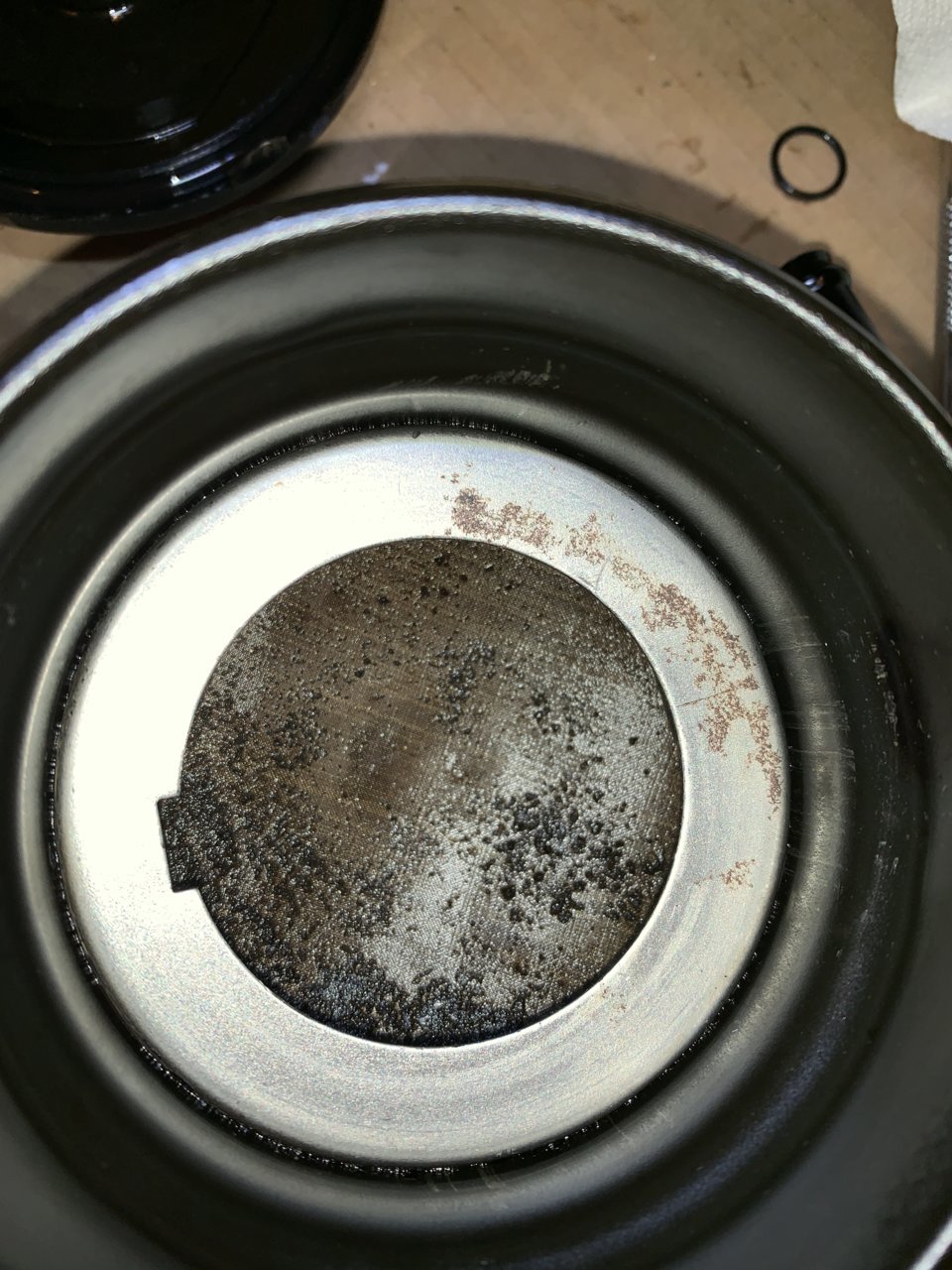

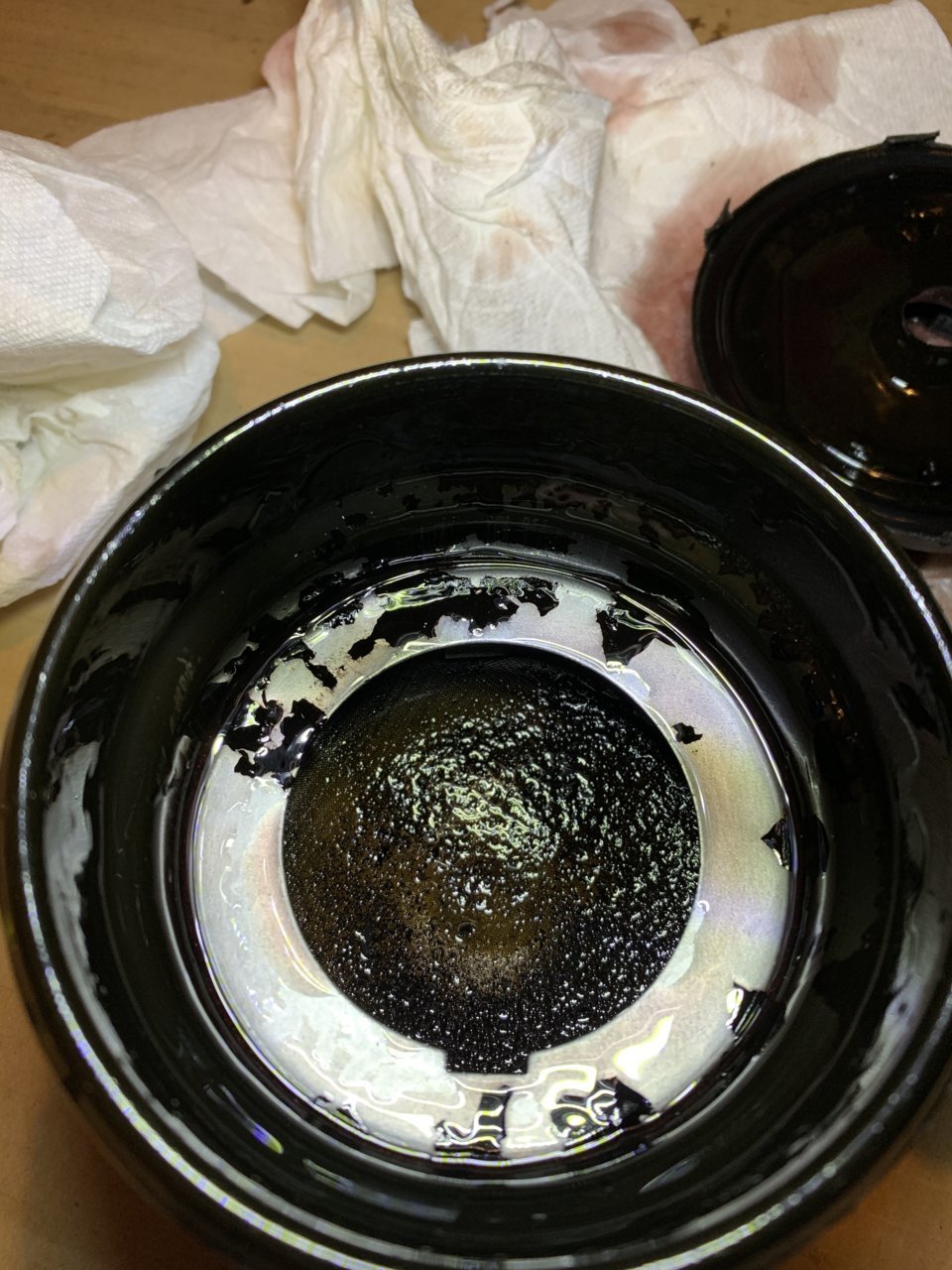

    Figured it out as best I could. Used a whole bottle of brake cleaner and then very very gently dragged a flat head screwdriver across the mesh, then wiped the crap off on a paper towel to get the crap out.
    I had to be careful because the mesh was already torn around the edge (about an inch or so around the edge where it was connected).
    I bled the system and possibly got it figured out. Letting the truck cool down before I let my hopes up. Tmrw morning will be the real test. There’s a chance I had just enough gunk in there to cause some cavitation (didn’t know what this was before I started doing this). I guess we’ll see if this worked. If not I will be replacing the idler pulley and of that doesn’t work it’s probably an issue with steering rack.
    Second picture is after cleaning with brake cleaner alone. Third picture is after using the screw driver
