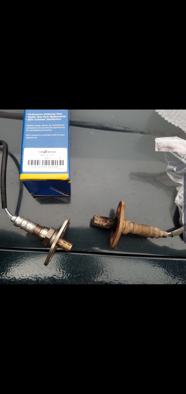

    I have a 96 with a quarter million miles and I just cleaned mine. Now it idles high. Not sure what to do now. It was idling fine before, wish I hadn't screwed with it

    I would throw an OBDII reader in, even if you don't have a check engine light on. I had a similar issue and decided to toss the OBDII reader in with no check engine light problems. Code P0120 popped up...Throttle Position Sensor. Maybe try cleaning or replacing the TPS. Cleaning the MAF sensor might help too.

    Thanks. I didn't have that code. I ended up correcting it with the washer on throttle body trick that I read about. It still takes a long time (until the engine is completely warm) for the idle to be back down to 750rpm. I don't know if this is just going to be normal with all the miles or because of replacing my precat O2 with a non OEM one that is a little smaller

    Yeah, doesn't look like the same part. Definitely could be the issue. Also, I've seen forums where people will replace the post-cat as well when replacing the pre-cat. I don't remember why.
