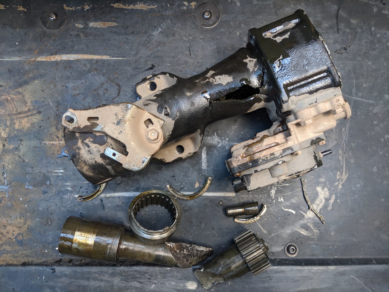

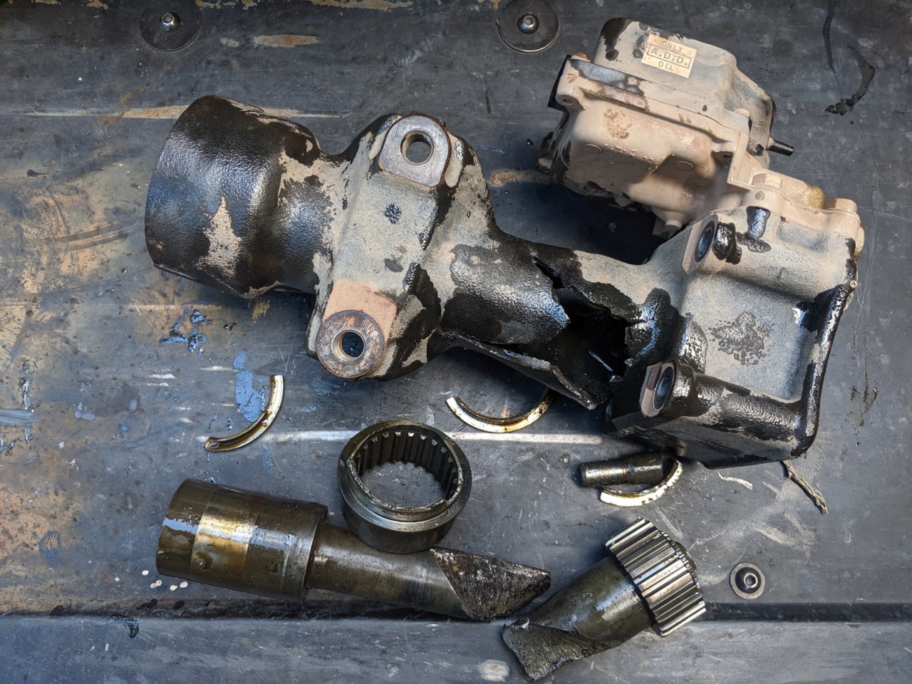

    I didn't see anything in that video I would describe as "abuse". That's generally how my homies and I wheel as well. Generally when I talked about "shock loading" it starts at bouncing hard enough to start to unload the tires. Bouncing a couple times on a ledge approach shouldn't cause any immediate catastrophic damage, but it's probably not good for the drive train. I'd think back on any other time you could have abused it. If you did anything foolish at any time before this though, it probably damaged it and was just waiting to fail. Way too many people beat the fuck out of their trucks without it immediately failing think that since it didn't fail instantly that its OK, then a week later have a break down, bitch and moan how things aren't stronger and completely disregard the stupid things they were doing the week before.

    absolutely. Ironically this is only the second trip out with the diff tube which is not to say that something else didn’t lead to the cause. I usually drive like that (smooth and controlled) but who knows.
    i just purchased another diff tube ($900 CND....) and will have the spare cv components so I don’t have to drive home with the diff spinning unlubricated.
    Was a learning experience and considering I got off the trail and made it home, I’ll take that as a win.

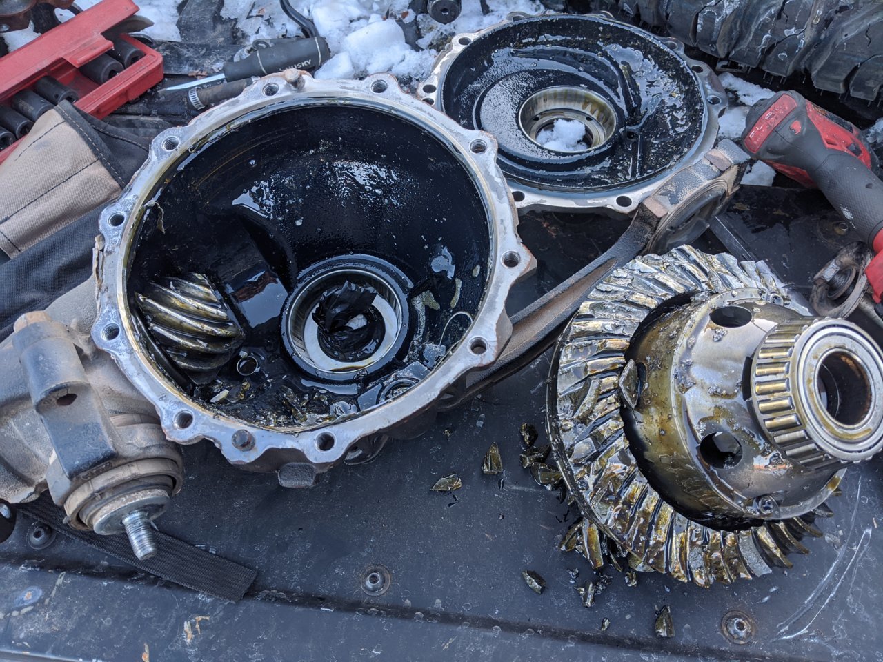

    Pretty sure something in my ADD/tube assembly is ready to go, very very noisy like a bad bearing as soon as it goes into 4WD. Any guesses before I remove it to install the spare?

    Could be a lot of things, there's a lot of parts on the shifter that could go bad or fail. The only bearing in the ADD spins all the time so if it was that I would imagine you'd hear it all the time instead of just 4wd. I didn't know anything was wrong with mine until it catastrophically blew out.

    Had the truck up in the air while running in 4WD, noise IS coming from the ADD/tube. Noise is less when holding the passenger side wheel still and letting the driver side spin under it's own power. And found no stripper glitter in the diff oil. I'll swap in the spare on Friday and tear down the broken one to see what failed.
