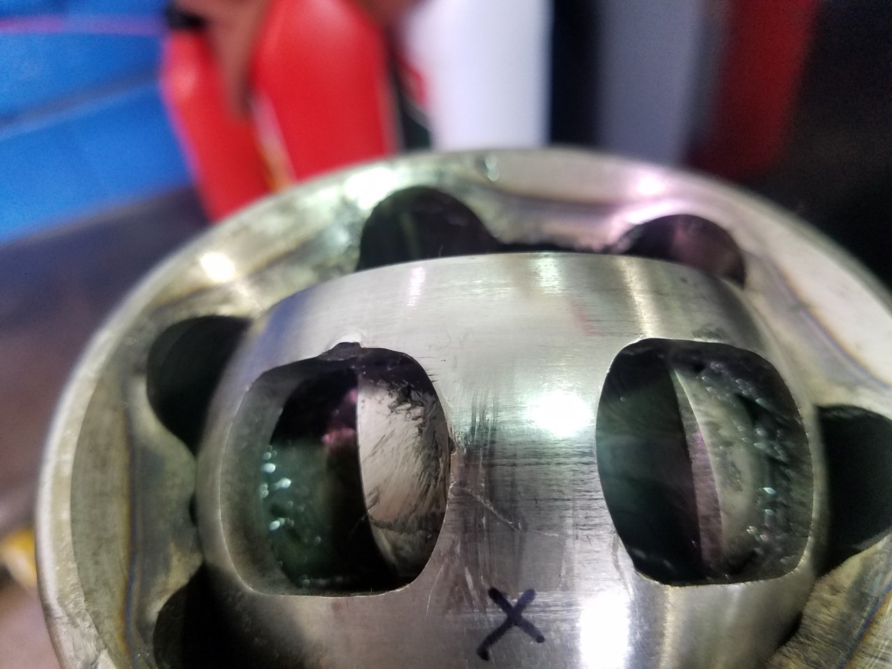

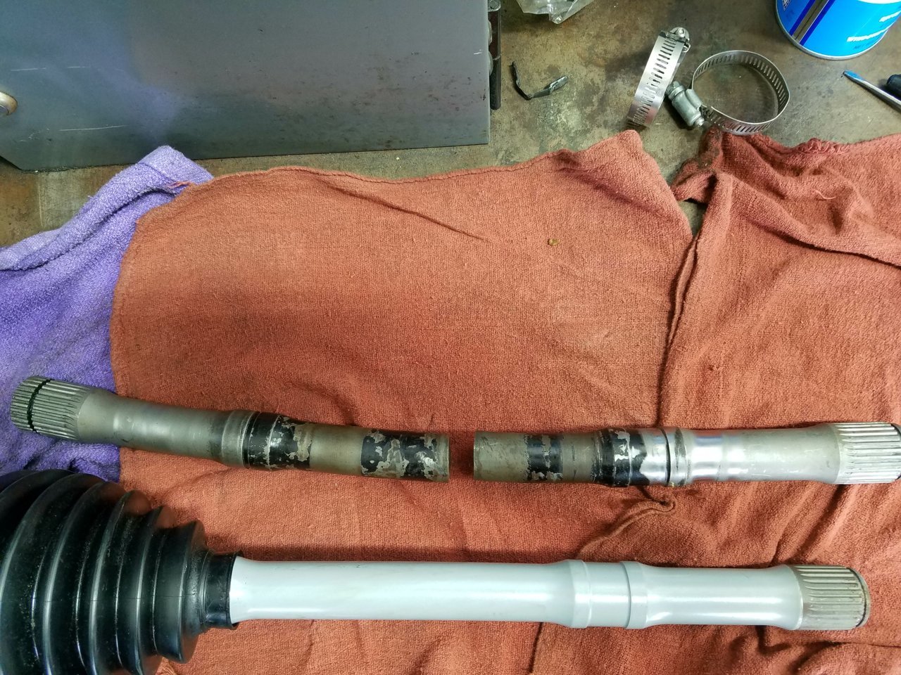

    There could be a lot of places on the shaft it could crack so look really close. After mine broke I inspected it a while later and had a couple extra cracks on the female receiver and another crack on somewhere on the shaft, all of those were hard to see without giving the shaft a close inspection.
    After my ADD broke I swapped it with a FJ tube, after that I had a obvious intermittent hum that sounded like it was coming from the transfer case, turned out the locker was cracked too.

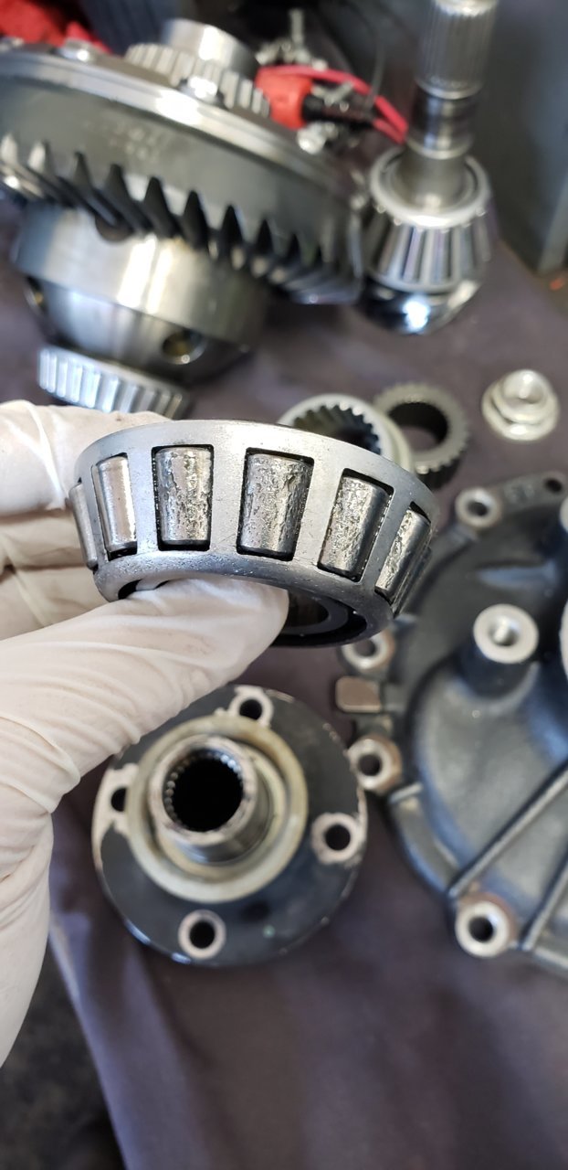

    Pinion bearing on the flange side making all the noise..

    @MonkeyProof Told ya it was ring and pinion! Well, I at least figured it was part of something that spins up on a shift to 4wd.

    Nah, diff drops on 2nd Gens. don't really equate to anything substantial..

    Except maybe a busted bearing like yours

    Diff drop wouldn't have prevented a pinion bearing failure.
    My junk has been seen it's fair share of the occasional leisurely Sunday drives :p. And keep in mind this is nearly a 10 year old setup. It's even been through a busted front Currie Interprise 4340 chromoly extend halfshaft and broken outer birf. Imagine the pressures and force inside the front diff that day. I'm actually amazed my only issue is a bad bearing after all it's been through..

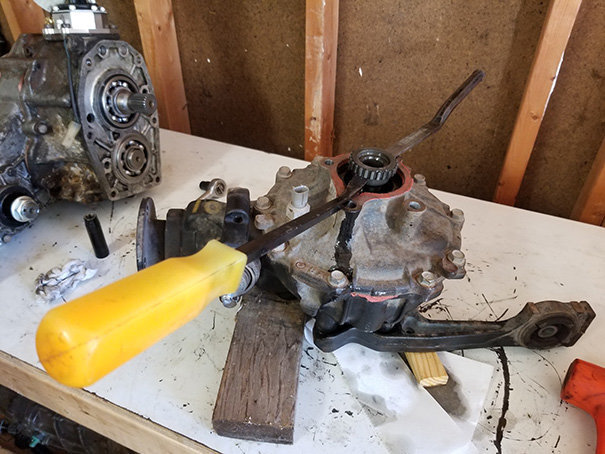

    Is there a specific orientation the ADD stub needs to be in to remove it? Would a slide hammer work better than a pry bar?
  11. Nov 20, 2020 at 8:49 PM
    #231
    ShimStack
    ShimStack Well-Known Member
    Mar 11, 2012
    #74701
    1,647
    Ben
    NC
    '91 Truggy, '98 Project, '16 DC OR M/T Locked F/R
    Dual pry bars 180⁰ apart. Quick little shove it'll come right out.
    6 gearT444E likes this.
  12. Nov 20, 2020 at 10:15 PM
    #232
    6 gearT444E
    6 gearT444E Certified Electron Pusher
    Feb 3, 2018
    #243372
    7,790
    Deep South
    Herculiner Hootus
    no orientation comes out just like a cv axle.
