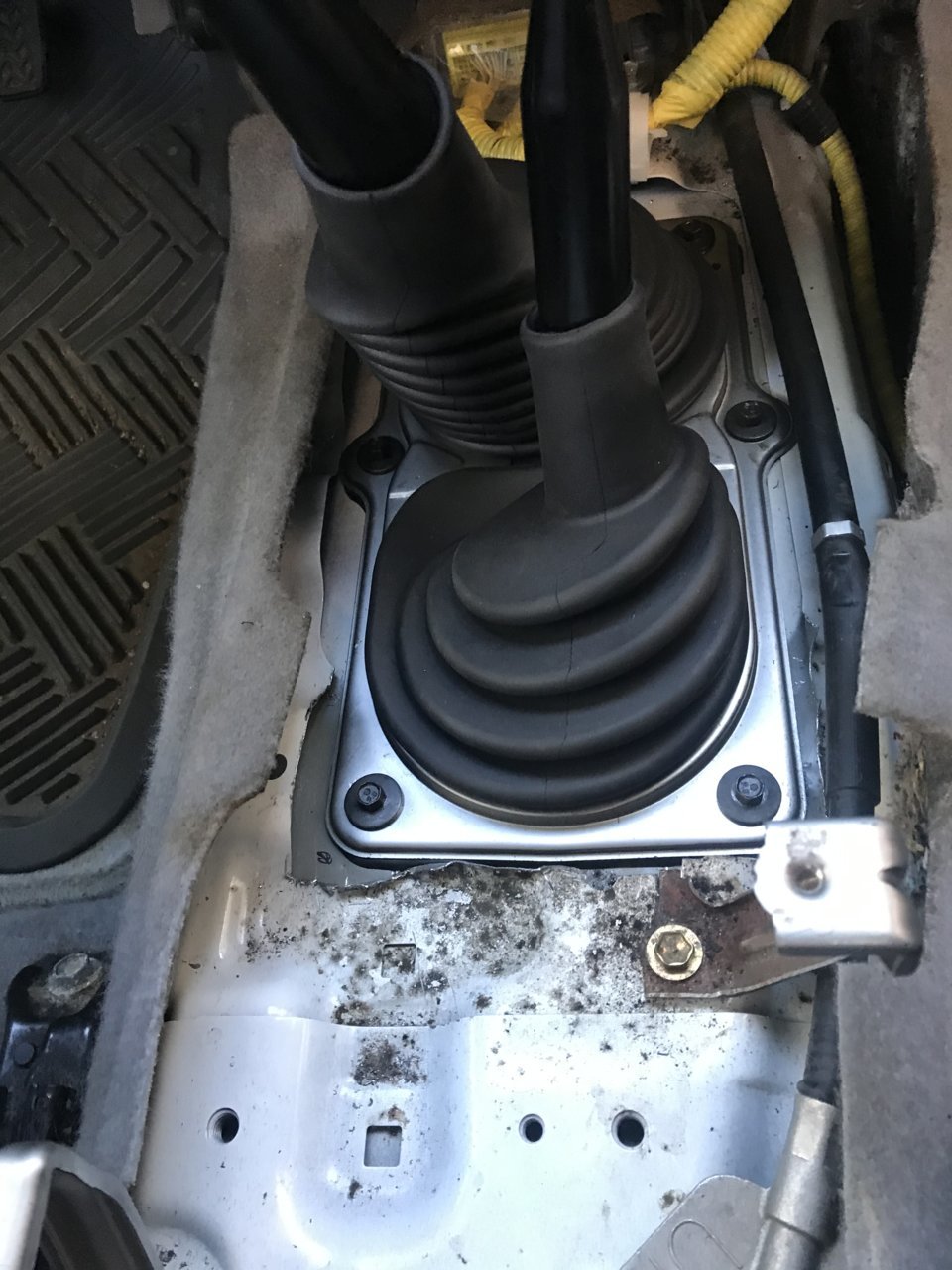

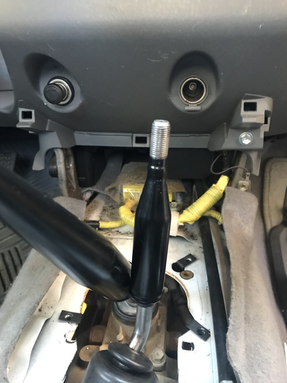

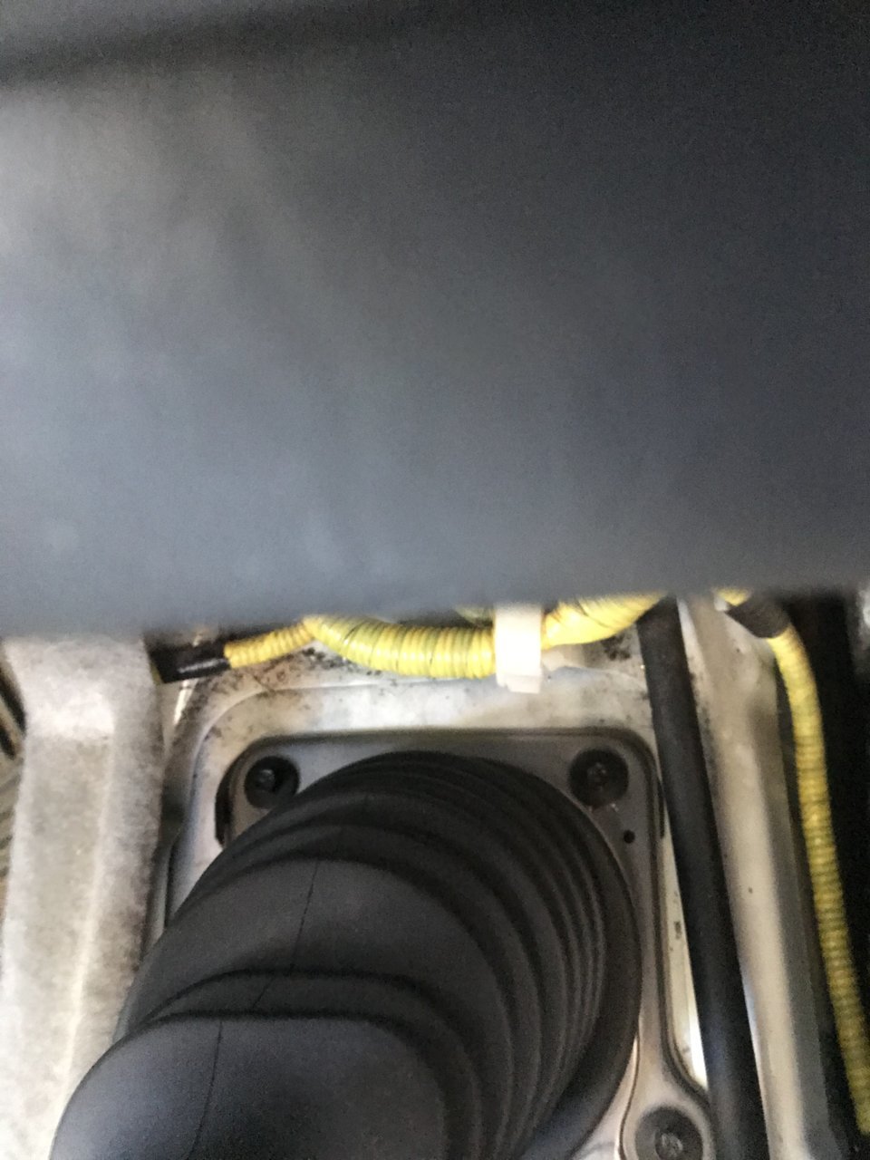

    06 single cab manual FJ swapped add delete
    Yes its all wired and the 4wd and 4lo lights both work as they should , drive lines are back in , waiting on the silicone to set up on the new add tube . Leaving the rubber boot off until I make sure I like the shifter clearances , might want to remove the t case stick and heat and bent it slightly it barely clears in 5th and the sticks rub in reverse , so I’m not sure I can live with that or not yet .

    I also have the Oem TRD short throw shifter kit on order but it’s back ordered .

    I had to test fit the boot , I think it looks factory !34E0883E-B631-496F-9D98-7007FD72D6FC.jpg
