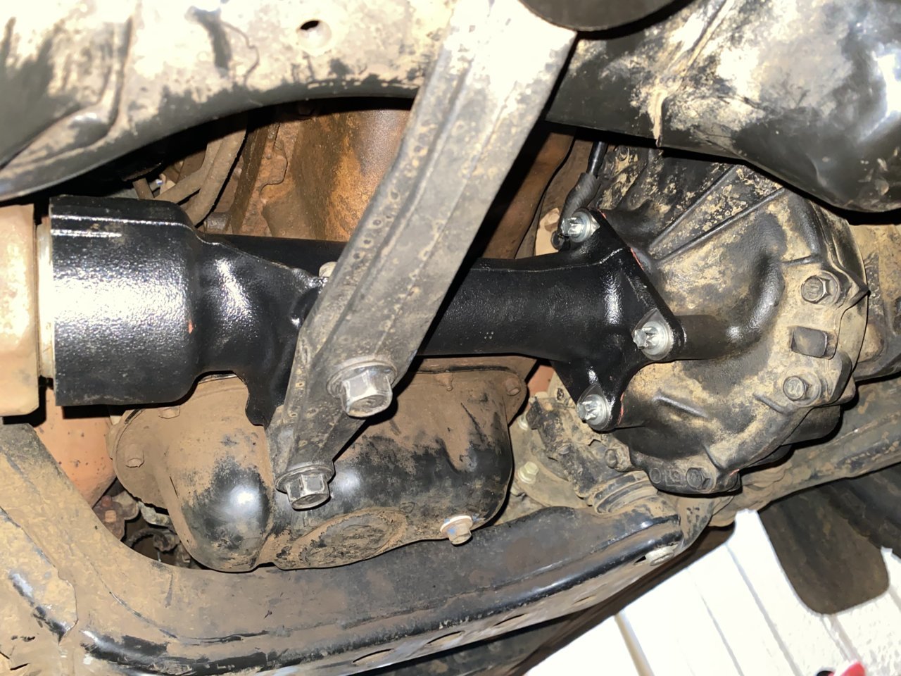

    spent about $400 for all the parts, really well documented. I just finished, now onto the FJ t-case.

    Finally did this. Why didn't I do this sooner!!?

    One of the best modifications you can do to these trucks IMO. No more mysterious "4x4 flashing" lights, the 4wd system engages any time you need it reliably for many many years to come.

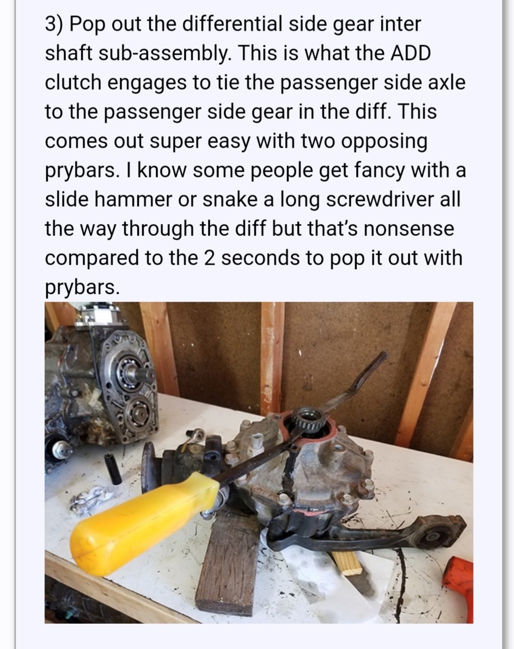

    This stub shaft can suck a left nut:bananadead:
    Edit: sledgehammer + flathead

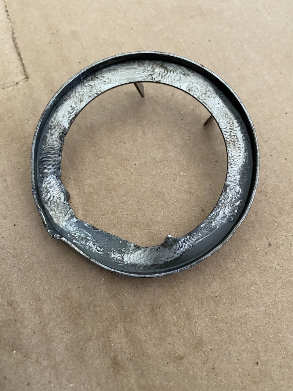

    Still need this? It came out:anonymous:093AD34B-420B-4BD2-8589-2BF8769588E7.jpg

    Yes. Oil slinger.
