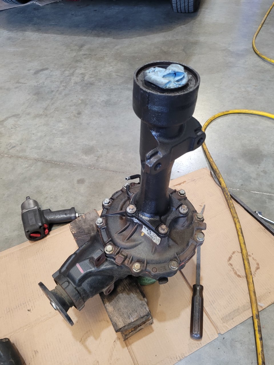

    Did an ADD delete for a friend. Picked up an entire gx470 front diff with all mounts intact. It was a bit surface rusty at a local pick up cost of $75.
    Sandblasted, painted, swapped over jackshaft tube and did ecgs bushing around 2 hours. 20230920_170844.jpg

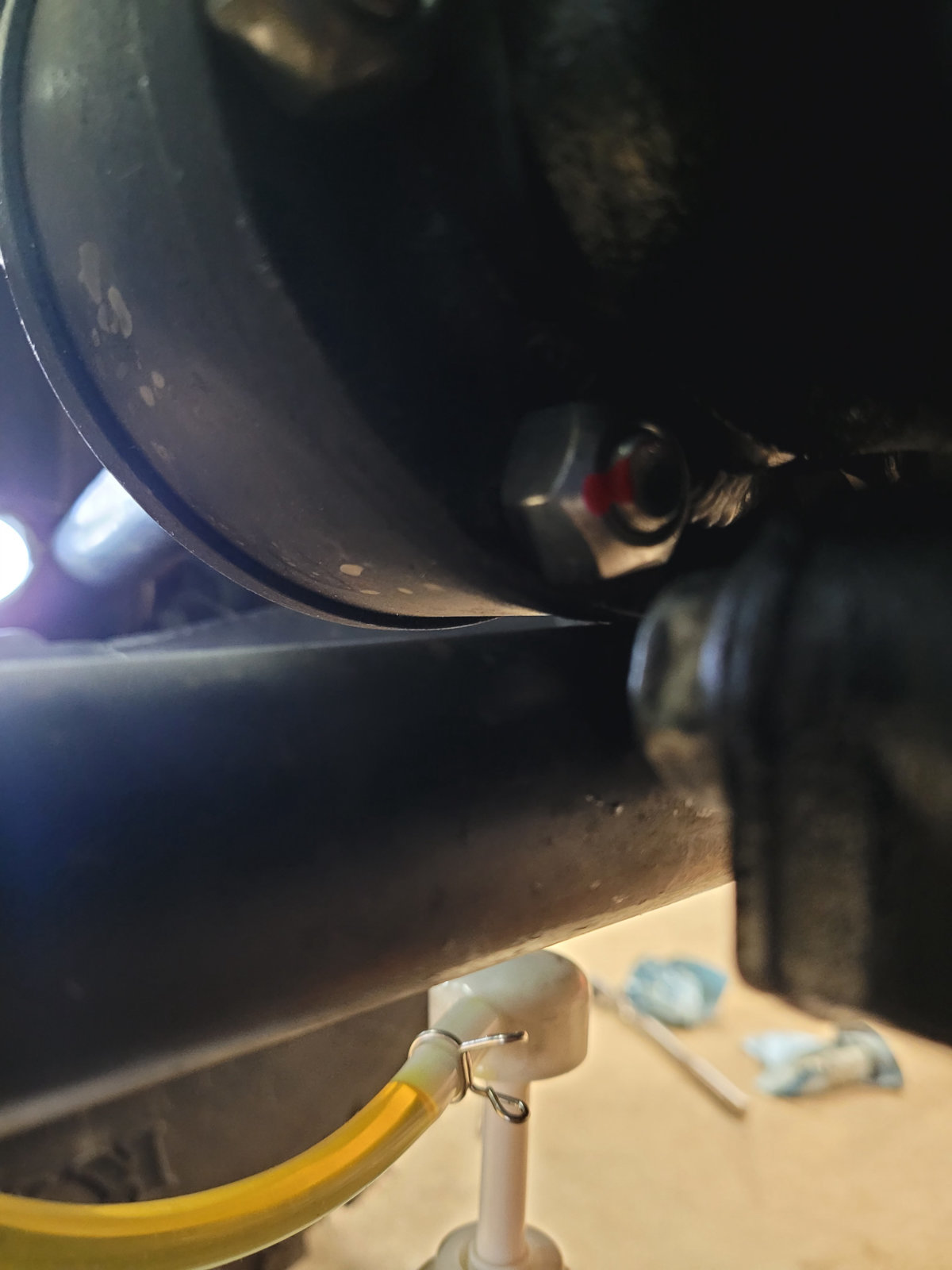

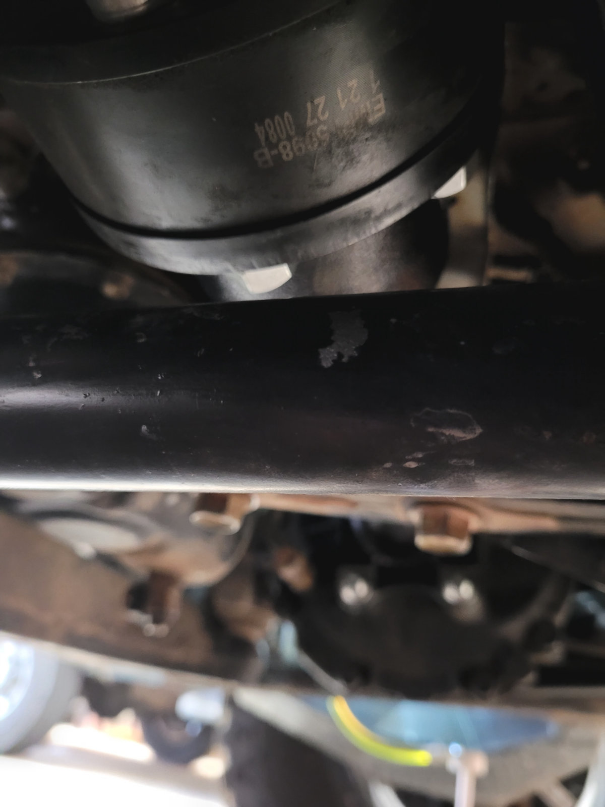

    For anyone running the JD Fab pivot kit.
    Apparently, running the FJ tube and using your original mount bracket will throw the entire front diff slightly out of level. The driver's side was almost touching the pivot kit brace and the pass side was about 1 1/4" high.
    I tried turning the mount over 180° but it just switched the low side to the pass. A pair of 3/16 washers between the mount and the tube solved the problem, no muss no fuss. Just wanted to give a heads-up.

    Shouldn’t. Maybe your FJ tube or your frame is bent.

    Seems unlikely. It's a new piece from Toyota, and I don't really see how it could be bent. You could make an argument that the mount bracket is bent (it's my original piece) but I would've noticed the CVs scraping by now as I've had the pivot kit on for 2 years now, and it's been doing it's job of reinforcing the frame since beore the first time i took the truck offraod. Either way, it's fixed on my truck I only posted as an FYI.
