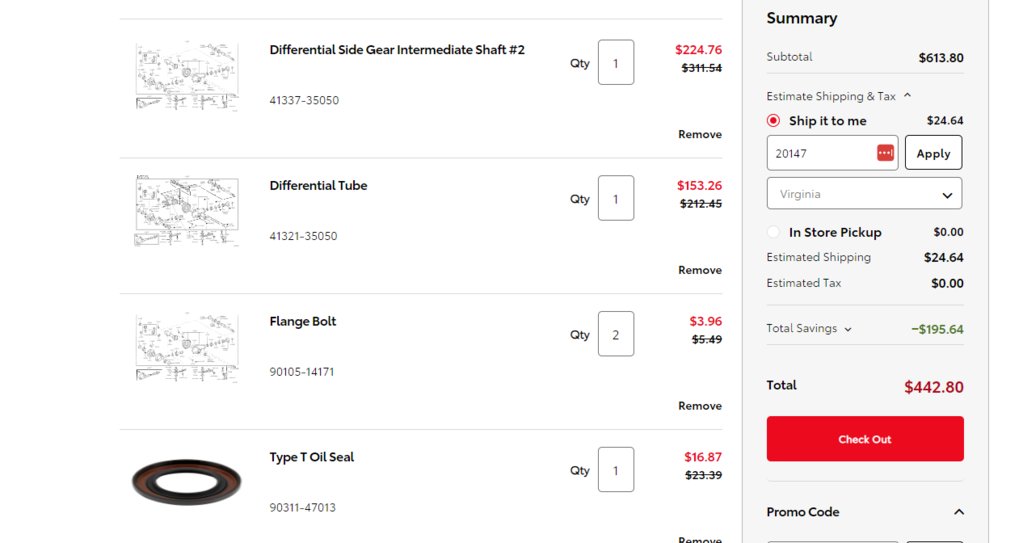

    Thanks for posting the part numbers in your original post.
    Post-covid prices are now $445 :facepalm:

    yes that is sad, I wonder how much a new ADD actuator costs though so maybe it’s linear and still fiscally even to replace a broken actuator with the manual tube :fingerscrossed:

    based on the new prices, could someone buy a FJC front diff on ebay and just swipe the tube? Used prices are looking around $350 shipped. Then maybe sell the front diff separately?

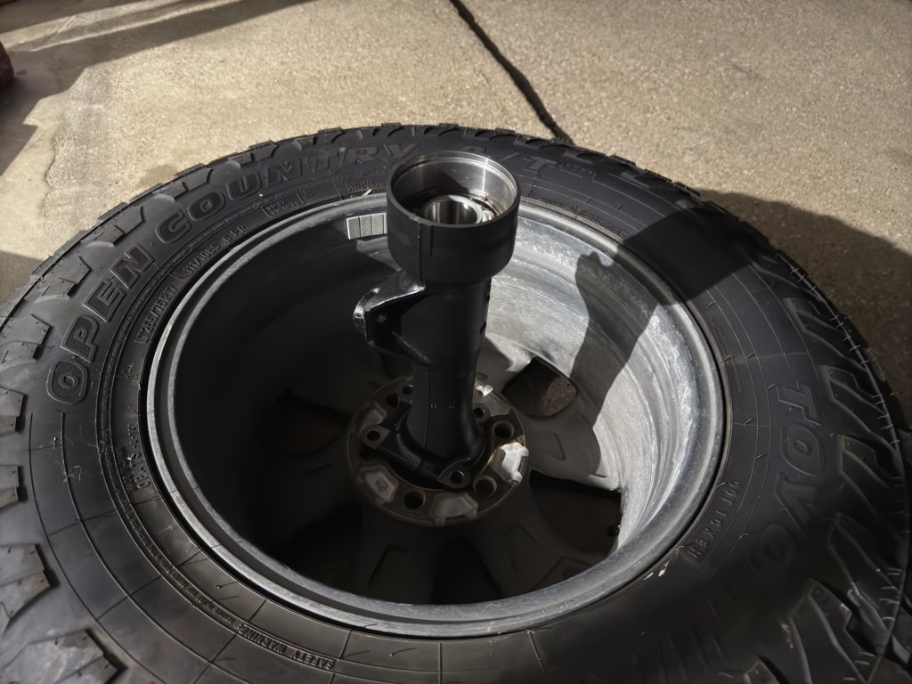

    I’ve got all the parts for this and am installing the tube to my truck as soon as I can get a seal installed to my satisfaction.
    Already built an ADD spoof harness that totally gets rid of all computer issues with the ADD being removed. 3rd gens are picky in that way. Pretty pumped for the swap! I have no real complaints with the electronic transfer case, but I really hate the idea of the ADD.
    Hoping the upside down wheel helps me install a seal straight finally. The first two seals have not gone well. Now I’m waiting on more seals and will try again, with a better method now.

    glad to see my trick might help someone else :thumbsup:. They key to installing is go slow and steady. Make sure to start the seal even and if it doesn’t then back out before it gets too crooked in the housing.

    Man, that seal is just a total pain. I had it going straight and then as I went further, it went crooked….i have installed 3 of these things now (2 OEM 1 from AutoZone) and not one of them has gone right. I’m using an ABS coupling but still, it is not going well. Very annoying.

    what I use as well that can help is get a threaded clean out and that will allow even pressure on all sides. Or use a small 2x4 over the coupler. They are definitely not the easiest to get started. Maybe try putting some grease on the inside lip of the ADD tube.
