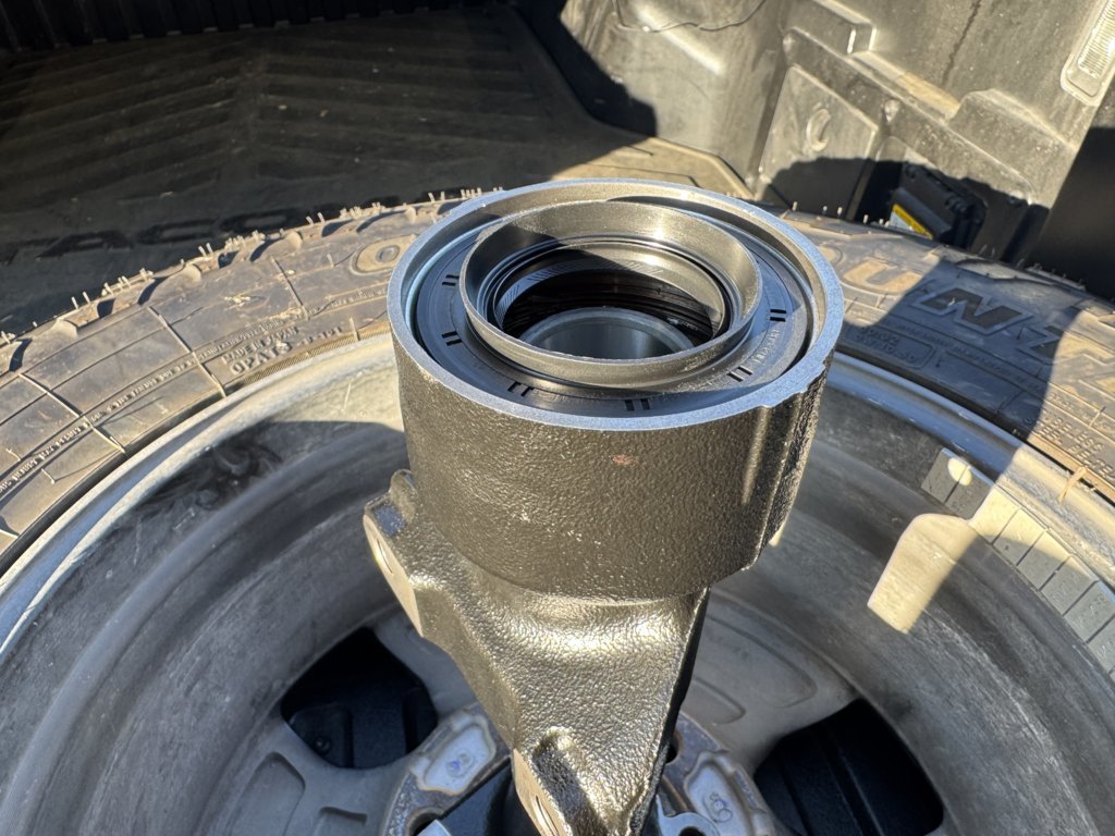

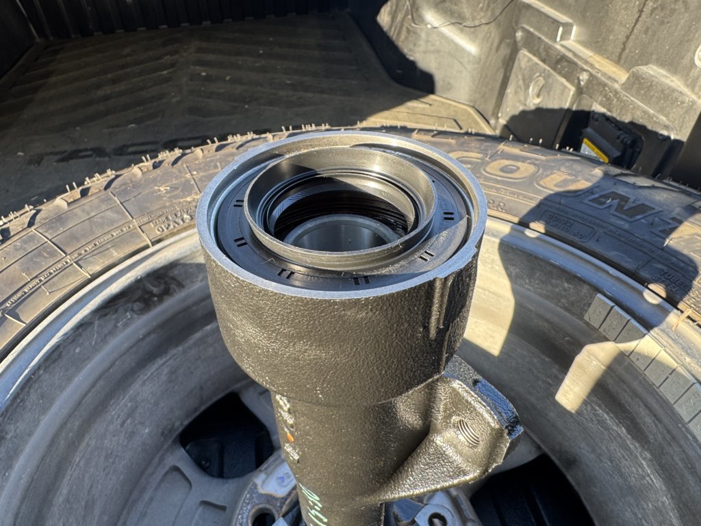

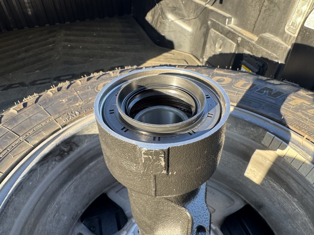

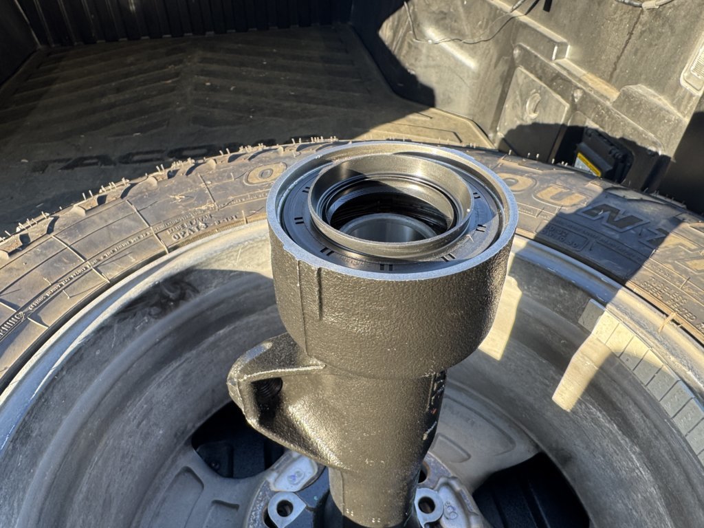

    Think I finally got it straight and to the right depth. Such a narrow range of acceptable depth. 4/100ths of an inch. It’s not exactly easy to measure consistently either since the seal face is rubber and gives a bit when measuring against it. Oh well, should be fine.

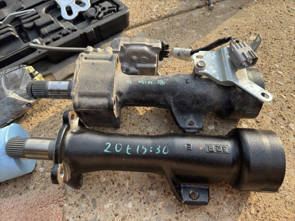

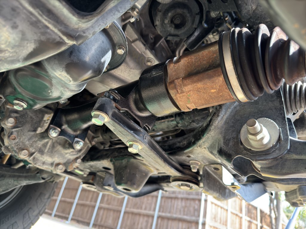

    Swapped mine yesterday in a 3rd gen. Took a few hours, around 3.5 working pretty slowly and taking a while to refill the fluid (a pain).
    Overall not too bad, just not a fan of working under the front of IFS trucks. Kind of cluttered and not much room to breathe. Anyways, things are working great now. I kept the electronic shift case, for now at least. I may swap it eventually but I don’t really dislike the electronic case. I dislike the ADD much more. I just don’t think the ADD is a great thing to have, in theory or in practice. I don’t care about negligible loss of mpg or added “wear.” The parts spin but at no load and they are lubricated, so I really don’t think there is even a wear argument to be had.

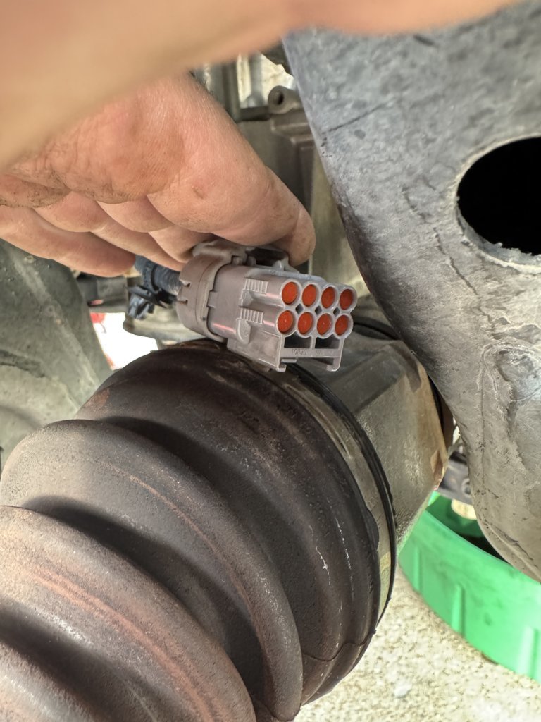

    RC60F Transmission ADD delete with FJ full-time tube FJ Metal Clutch Pedal OEM Mexico-Spec Condenser Fan 265/70R16 Michelin Defender LTX M/S 2 OEM 1-Piece Lug Nuts Custom Built Switch Panel for all Electrical Accessories Rigid Amber Pro D-SS Ditch Lights Rigid 30" SAE High Beam Driving Light Bar Rigid SR-Q Pro Back-Up Light Kit (Recessed) VLEDS Tail Conversion VLEDS Foot Well Light Kit KC HiLites Cyclone V2 Under Hood Lights Operable (Switched) Clutch Safety Bypass
    You mean in the cab for fooling the ECU? If so, I have a 3rd gen which wouldn’t apply. If you mean the plug for capping the ADD jumper harness connector shown in the pic, that is
    https://www.corsa-technic.com/item.php?item_id=1261
    and (8) https://www.corsa-technic.com/item.php?item_id=841
    need to zip tie the harness afterwards so it
    Doesn’t fall down on the CV. In stock form, the harness is mounted to a bracket bolted to the ADD diff tube. The FJ tube has no wiring and so it has nowhere to bolt the bracket that supports the wiring.

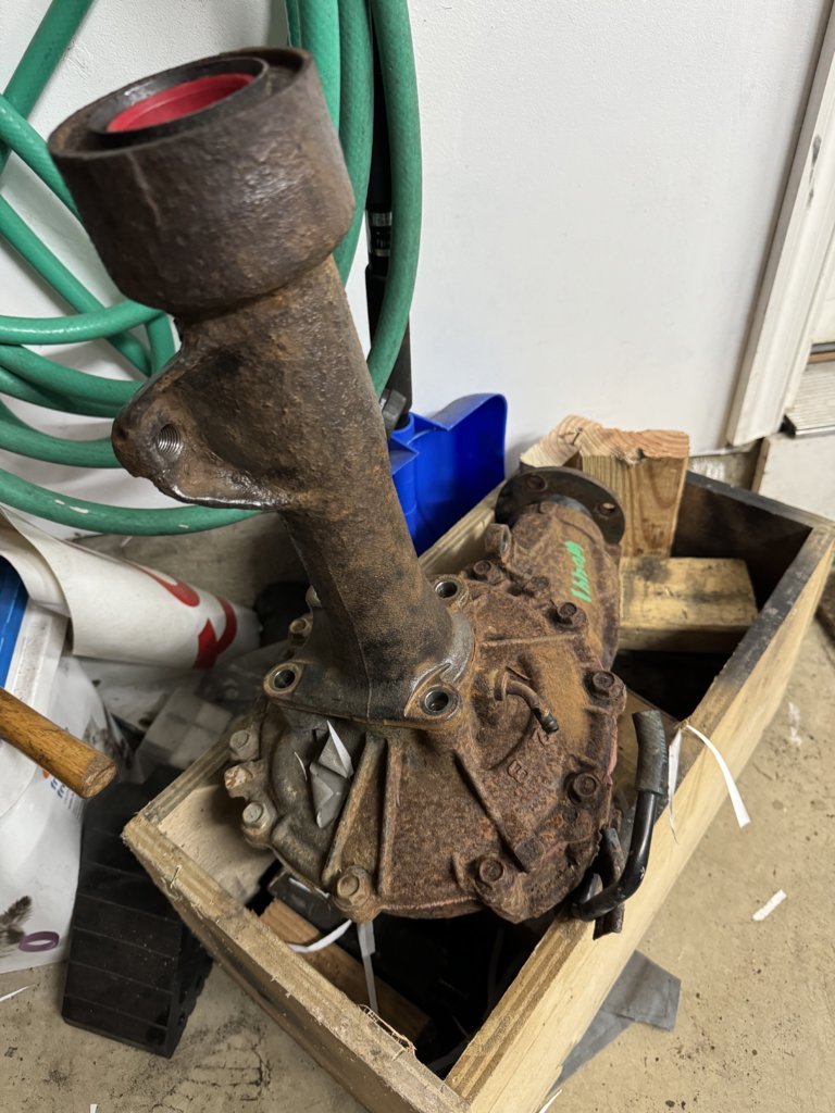

    Haven't tested the splines yet, but FJ tube acquired! Just needs a little cleanup.
    Also, front diff for sale! $250 picked up in Northern VA, or meet halfway for surrounding states up to 200 miles away. Should fit v8 4runner, 2nd/3rd gen taco, manual FJC, Trail/OR 5th gen 4runner, and GX470s
