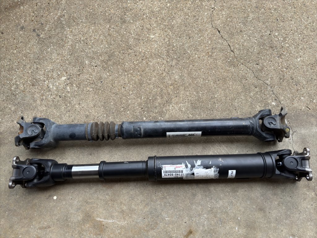

    Well this is a bummer. The new driveshaft vibrates severely. It fit fine and all, but for some reason vibes are terrible. I didn’t grease the joints beforehand, but I don’t think I needed to?
    No way this is what the 4R and FJ deal with, something is up for sure. Gonna try greasing as a Hail Mary, otherwise this thing will be removed tonight.

    You can get it rebalanced
    CygnusX191 likes this.

    It’s a brand new factory FJ shaft from Toyota. Shouldn’t need anything.
    the shops near me won’t balance much over about 1200-1500 rpm. My stock shaft doesn’t show vibes until about 4500 rpm, so I’m skeptical that going to a shop will do anything for me. That’s why I was hopeful an FJ or 4Runner shaft would be a bolt in vibe free solution.

    Well, I dunno what the deal was but I put my stock shaft back in. There is still the expected very light buzz starting around 80 but I’m going to keep an eye on it. It’s still very minor and I don’t really want to swap the ADD back in. Maybe someday I go back in gearing to some degree if I can find a deal, but I doubt it. This is minor enough for me to leave it for now.
    Locking hubs would be nice for times like these for sure.

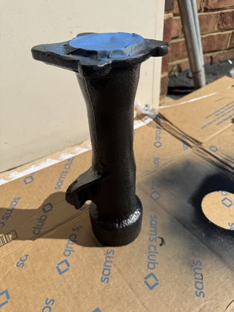

    Does anyone remember when they put this together if there was any side to side play? Im bought a used tube, unknown miles, and it has a small amount of play.
    Im just not sure if thats normal and i should install it, or go the poor man's route and slide the collar over?

    I kind of like the poor man route, and this way equally. I think I might just buy a new tube so I dont have to helicoil the threads. Im not having any luck with the helicoil kits that Im getting from Amazon.
    A new tube is $150. Worth it in my opinion.
    CygnusX191 and 2023 1GR-FE like this.

    Was able to helicoil the threads. But also ended up buying the new tube.
    If anyone wants to save some $, im selling the helicoiled tube. Fresh paint on it too. Cleaned it up as if I were going to use it.
    $110 shipped to lower 48

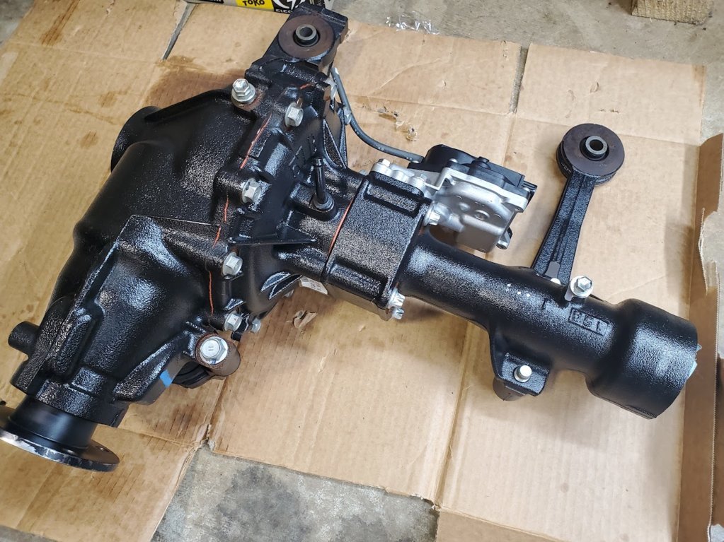

    That's pretty slick. I just scored a new front 4.30 diff off of LKQ with what I'm told had 4 miles on it. They must have boggered up the ADD side seal on removal as it didn't come with it and I'll need to install a new one. This tool would be pretty nice to have but not sure I can justify $70 for a limited use tool, plus it's out of stock. Without having to search and hunt, does anyone know the factory spec for seal depth on these diffs?
    Here's my new 4.30. Still not sure if I'm going to remove the ADD or not.
